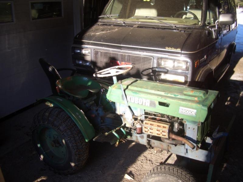

Hi
I have actually seen quite a few (5-6) the same colour green kubota's here in Australia. So it seems a little common. I reckon it maybe something like a company like zetor brought a heap of kubota's and painted them all green. It may have even been done at the factory?
Would be interesting to know? Maybe someone else might be able to shed some light on it. All the ones I have seen have all been B6000's.
As to what its worth - hard to say - many will knock it because it has a CCW pto. But smart guys know this isn't a handicap.
cheers john
This is common?
Maybe it's a JD guy playing a really mean joke on the orange lovers.
cheers john
CCW PTO? This is a newbie question, but is that unusual? Does it make a difference in how the 3 PT hitch raises or lowers a load?
