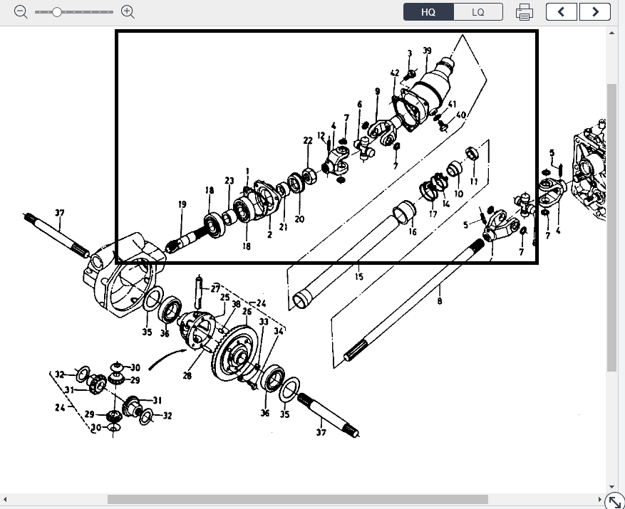

I don't think you are going to find any "shear pins" in that driveline. If the propeller shaft is turning comiing out of the transmission and there is no external indication of a propeller shaft failure you are going to have to go inside the front axle to find and fix the problem. I would proabbly start by dusassembling the universal and associated parts connecting the propeller shaft to the differential pinion shaft - shown in the boxed area below. I would also be hoping the universal has failed.

Well from looking at the diagram here, which I'd clearer than my crappy manual pics, everything from the main transmission to the input shaft at the front differential seems connected so the problem I think for sure is/will be with something inside the front differential. I'm assuming it was working when I got it as I attempted to clear some snow the first winter and I didn't experience any problem with traction with the exception of spinning on ice underneath. Can you supply itemized descriptions of the numbered pieces in that diagram?

In reference to the display Dan posted, remove the shield #15, remove pin #5 and #12, and I think the shaft is removable.

Using a pin punch drive pin 5 out of the transmssion universal and pull the universal off the transmssion output shaft. Then the propeller shaft assembly including the cover 15 can be dropped down and withdrawn from the front differrental. See my earlier picture of that shaft and cover as used on the B7200. Looks to be virtually identical.

I hear you on the origin of the potential trouble. Without getting into that disaembly as I have said, just external observation is as I said when all wheels in the air and in gear running it appears that the complete shaft from the transmission to that input shaft at the front differential is connected and turning, but no output to the front wheels. I'm kinda wondering if something that attaches to that differential ring gear had broken. I see what looks like pins/bolts that attach that housing to the main ring gear?

I refer to item 25 possibly becoming separated from the ger?

Ok people, an update which basically confirms what I've been saying all along. I popped the pin at the front differential u joint coupling (actually there was a wire through the roll pin holding it in place and it came out when I removed the wire), splines seem ok but worn a bit. Can turn differential pinion shaft by hand completely in both directions no sounds. Guess we're into bigger job opening up front differential. i haven't attempted to drain oil if any in the differential, that will be next. I'll report back.
