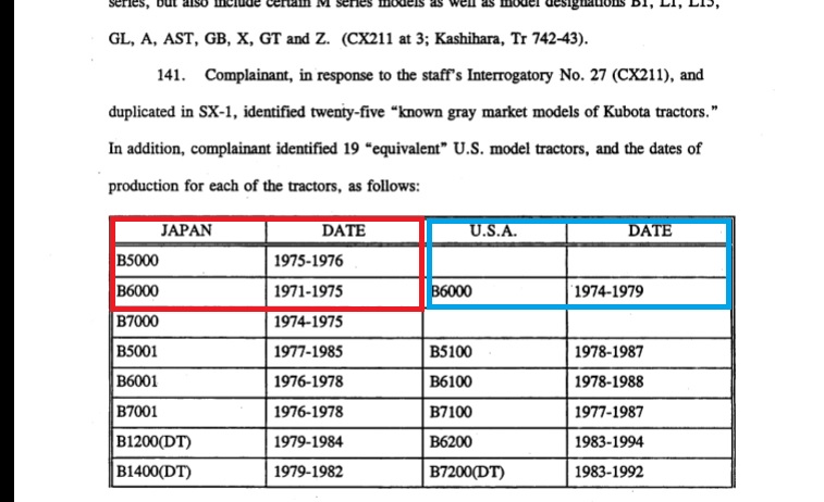

From memory NIW pointed out to me that there were two versions of the B6000. A Gray and a USA.
This is a page that shows this.
