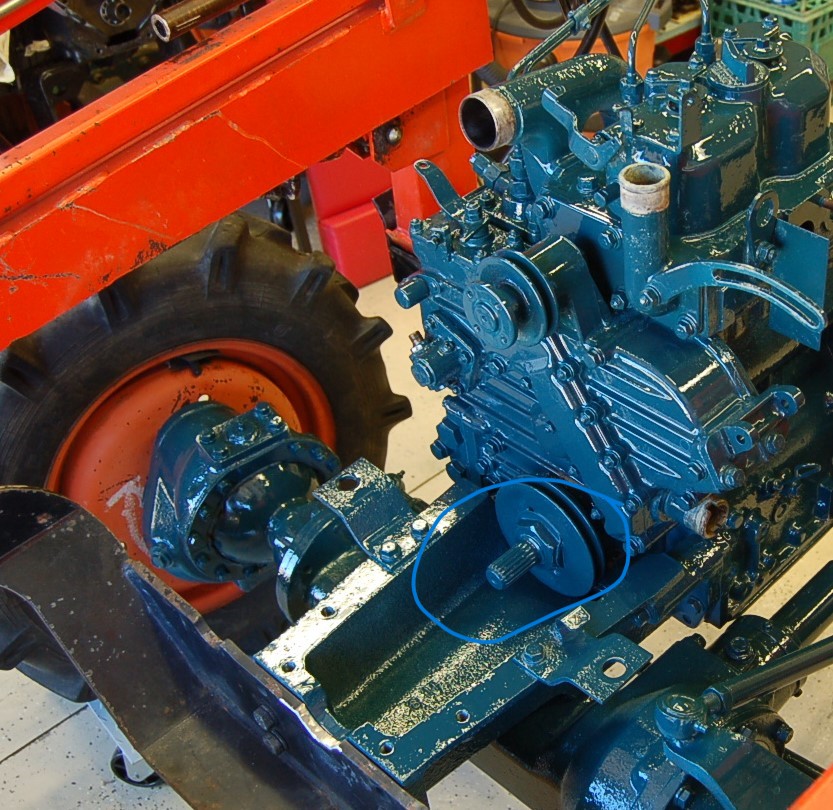

Agreed, I am not familiar with the B6000, and I looked at the dismal shop manual I have,
which showed nothing of this area, does it have a front crankshaft spline like the L1500?
Best I can determine no spline which is probably a good thing. Matching those Kubota splines is not easy.
Google found a couple images of the crankshaft pulley which looks to be drilled and tapped for mounting a hub. Should be easy to fabricate an inexpensive shaft takeoff.
