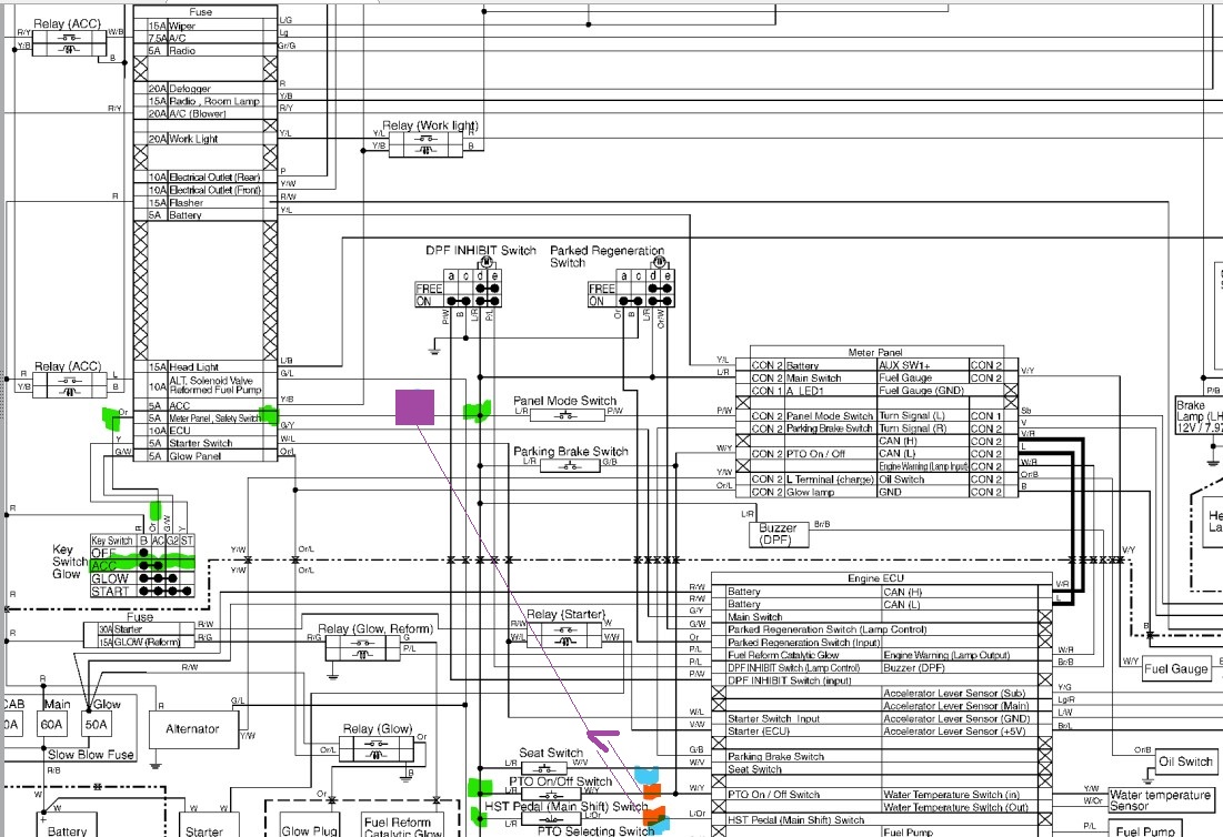

Given my age and decreasing dexterity, I'm considering the possibility of an emergency bypass switch for these 2 switches. Looking at the schematic (it's for the cab version - mine is ROPS), when the key is turned to ACC or further it looks like the closed switches deliver 12v "signal" to the ECU. I've marked the ACC supply line with green - from what I can tell, it's an L/R wire (would that be lavender/red?). It looks like I could tap in past the safety switches (under the dash before the lines hit the ECU - marked in orange) and use a DPST switch to connect from the supply (marked in purple) to the orange taps. I need an old-geezer-friendly way to temporarily jumper these when they fail, but I'm not so far gone to forget to turn the pto off and put the machine in neutral when I turn it off.

Some of these switches have both +12VDC and ground separate circuits. Mixing those with an ECU could be pretty dicey. Look at the price on an ECU -and- the cost to install it. Very easy to go from bad to worse.
L/R would be a blue with a red stripe.

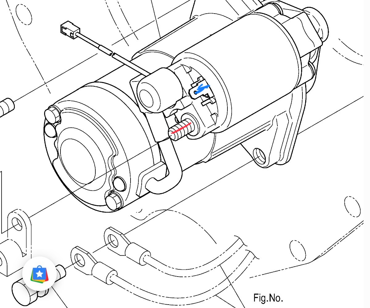

You need to connect power to the spade (red must be shorted to blue in photo below). If you can get the wire off the spade connector and then connect a long wire to the spade terminal, touch that to battery positive and tractor should crank. If key is in run position then it would start. If you are not careful, then tractor could kill you by running you over!
So be careful!
If the starter just spins and the bendix doesn’t engage the flywheel then you need a new solenoid or starter assembly.

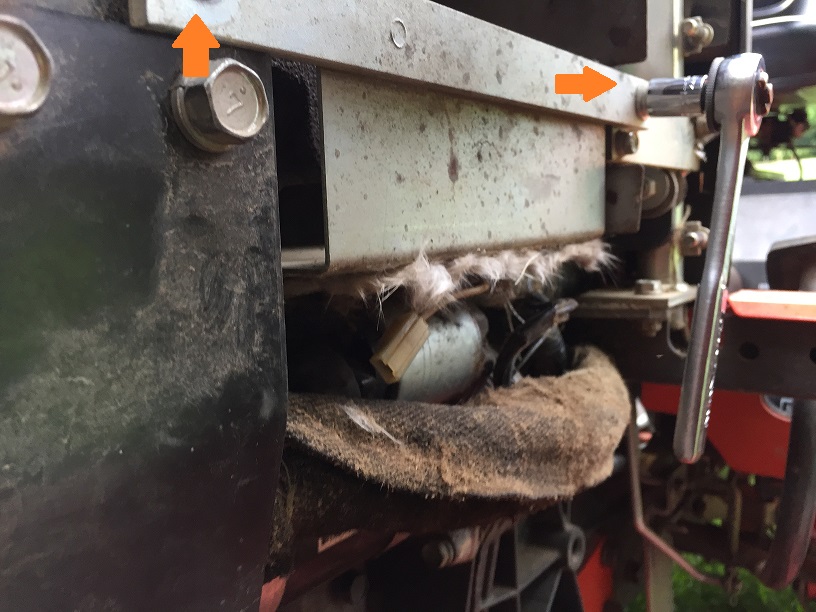

SUCCESS!!

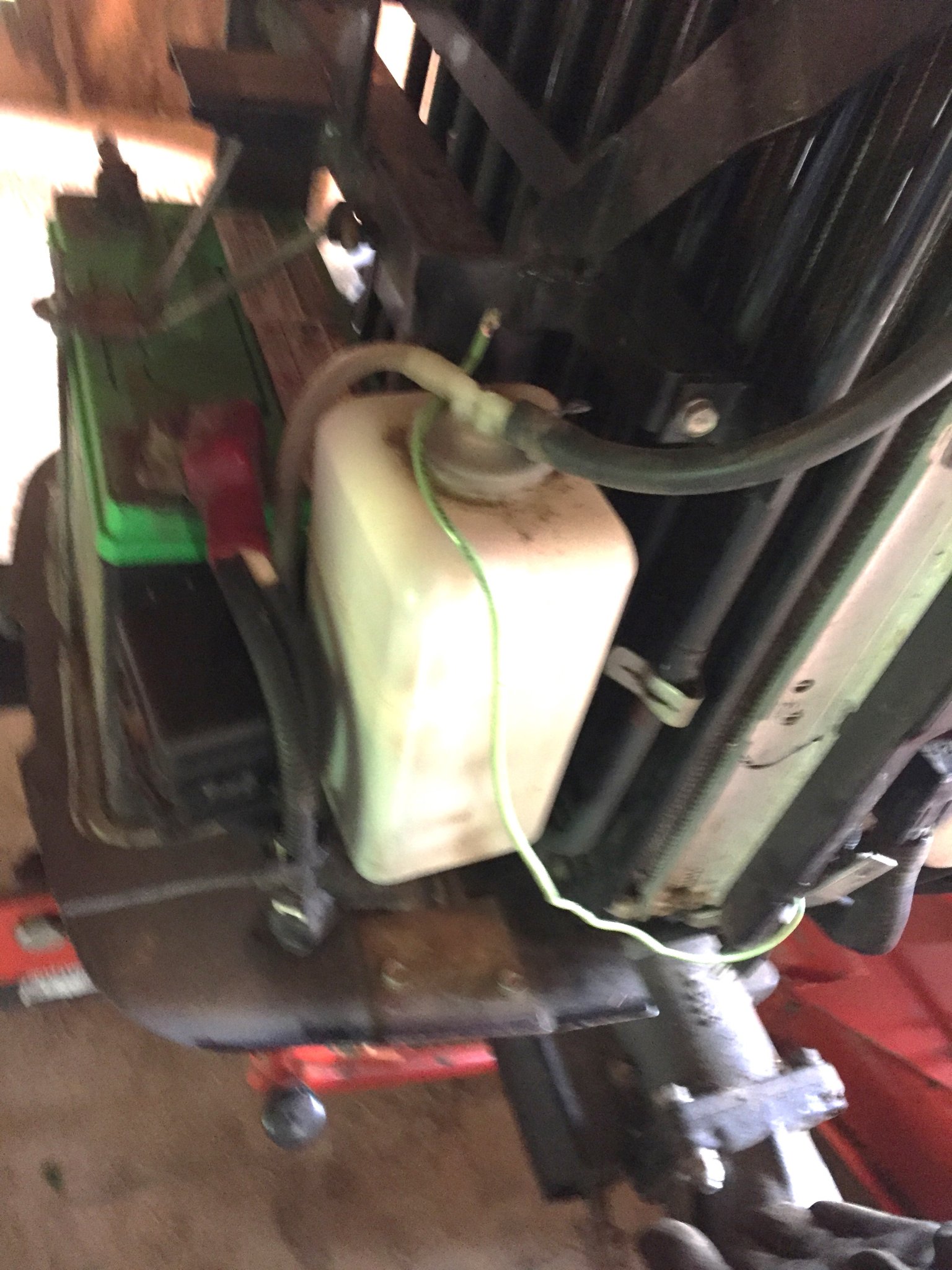

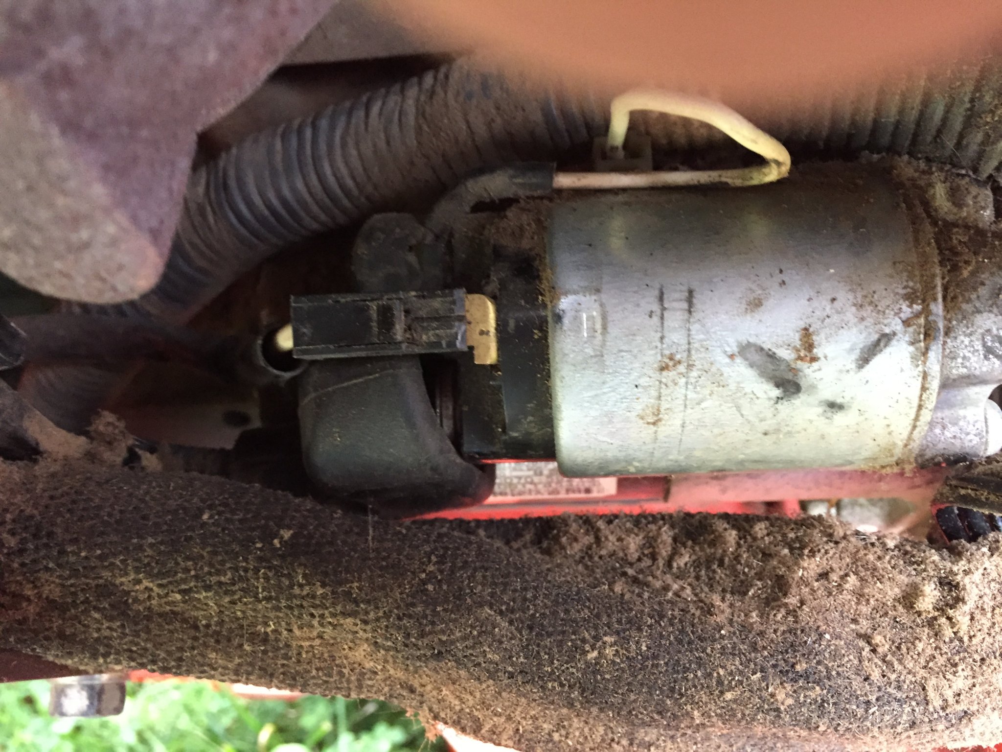

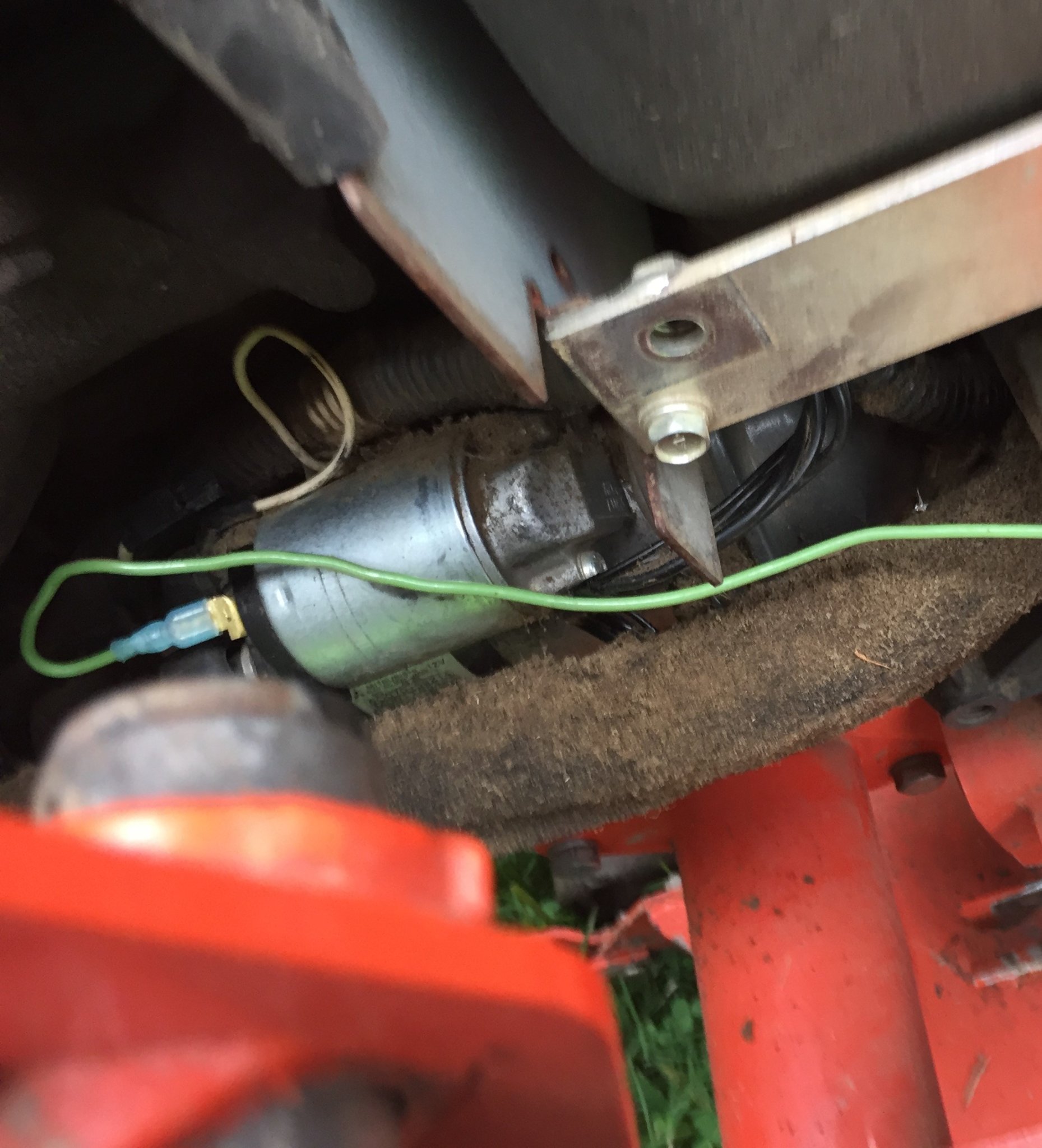

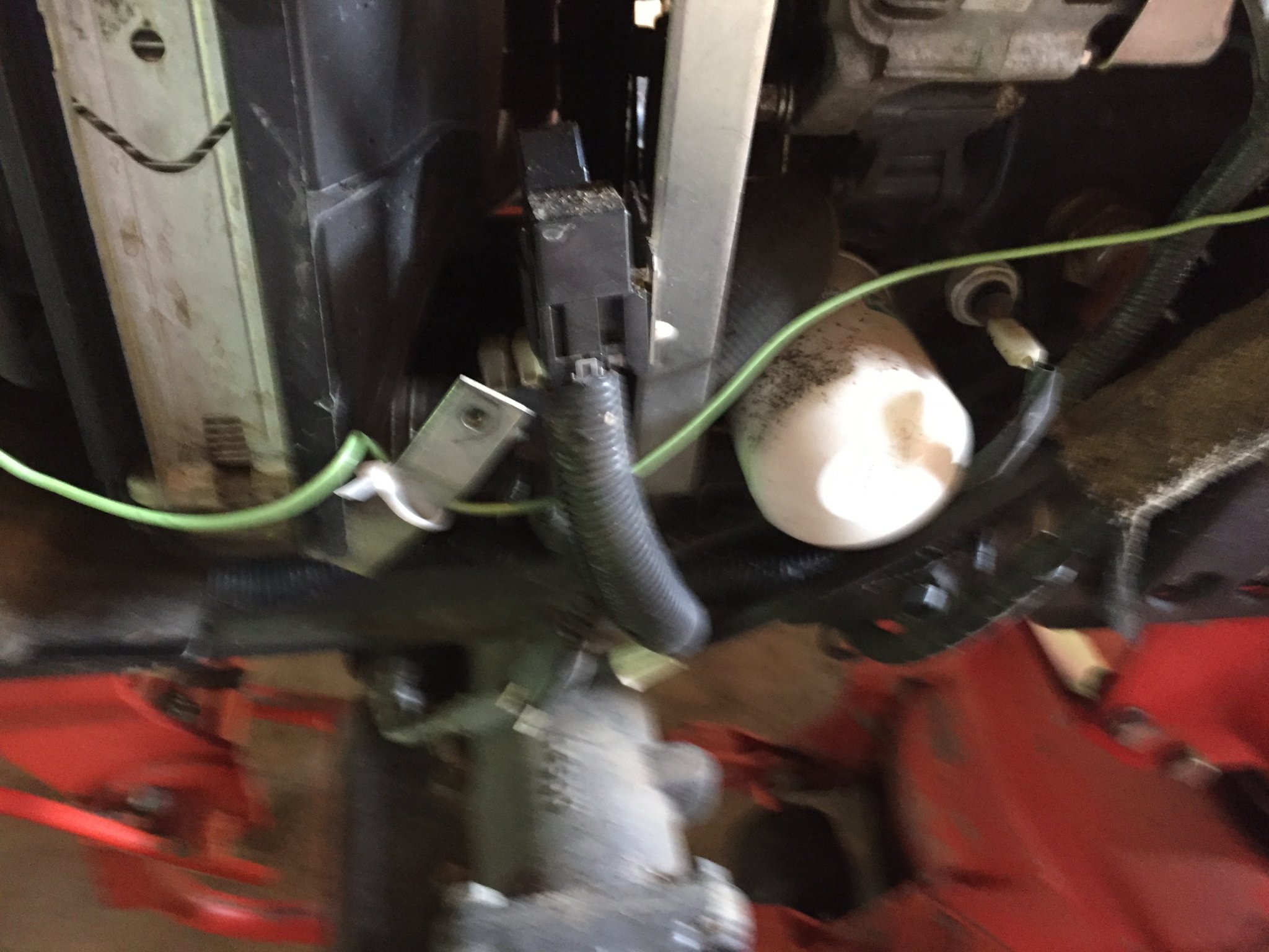

Before moving forward, I called my dealer to make sure that this wouldn't fry the ECM and he confirmed that it wouldn't - thanks to NI Wolfman for the caution. Temporary battery to solenoid terminal jumpstart worked. With a little more patience and a lot less sun, this time I removed the heat shield (2 bolts - orange arrows in photo) and had a lot better access. i was able to easily remove the harness connector from the solenoid terminal. I crimped a connector onto my green jumping wire and threaded it to the battery. First I tried activating it from the accessory socket by the seat, but not enough juice, so this is a hood-open touch-the-battery process. Photos show various steps as well as safety reminder on the dash.
Feels like a cross between Hilljack Motor Specialties and the Flintstones, but it got me started and into the barn.
