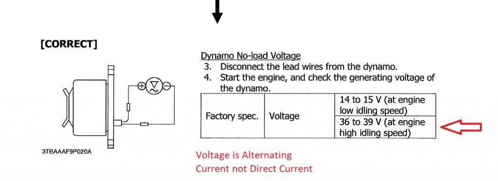

You have a dynamo not an alternator from the spec's I can find.
The dynamo is a super simple device which rarely fails. I have attached the test procedure. You need a multi meter which can measure Alternating Current voltage.
Its output is low by design so fan belts will not be involved in what you are experiencing.

Dave_eng,
The low idle test showed 14.8 and the high idle(2500RPM) showed 31.3. According to the picture that you posted, the high idle is below the test specs. So does that mean that the dynamo is bad or regulator? If it***8217;s the regulator, where is it located or is it within the dynamo?

Dave_eng,
The dynamo's output is close enough. Did you test it disconnected? It should be tested disconnected.

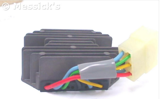

The regulator is separate from the dynamo. Look for a rectangular box with fins for cooling. About 2" x 4" x 1.5" thick.
See photo from Messicks attached.
Their parts page shows a serial number break so be careful should you decide to order one.
Make certain the present regulator;s fins are clear of dirt and debris. If it cannot get rid of heat it can produce the symptoms you have.

Well after pulling the regulator out, I located what I think is causing the problem. The plug on the regulator and the wire harness are both partially melted. The black wire in both plugs is what melted. I will get a new regulator but Is there a way to purchase a new plug end for the main wire harness or do I have to use spade connectors and eliminate the plug.
The black wire(s) are the regulator ground and are joined to other circuits such as lighting also providing a ground for them. Make certain the black wire does have a good ground. Connecting it to the point where the battery ground cable attaches to the engine would be a good step to ensure the entire ground circuit is strong.
My inclination would be to buy a new regulator and eliminate the plug completely. They are only used for the initial build and replacement but are also a weak point in the system.
Cut the plug off the new regulator.
Best would be to solder each wire together and cover using heat shrink tubing.
High quality crimp connectors are second best but again cover with heat shrink.
