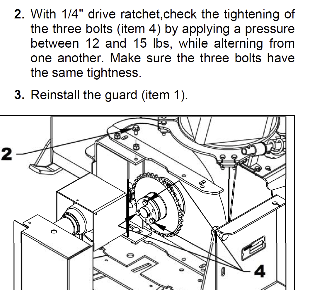

Here is where I am stuck. When I looked at the parts diagram, the sprocket configuration was different. In fact, I saw three different possible configurations to hold on the sprocket. Mine does not have set screws in the sprocket, as it has a 4-threaded-hole plate with two of the opposite holes occupied by bolts with a shaft key in one of the grooves on the shaft.

I can't find a parts diagram that reflects the configuration of the hub that I have. The technique that you provided for tightening the hub over the sprocket (thank you) makes sense with three triangular oriented bolts, but I don't know if that is appropriate for 2 bolts.
5,650
1,568
Look up taper lock sprockets. I believe you need to remove the two bolts and use them as jack screws in the other two holes. You will be pushing a tapered part off of a tapered part.
I think the two open holes will be threaded holes and the two with bolts will be clearance holes, but I might have that backwards. It has been some time since I used one of those things.
All the QD bushings I've dealt with had 3+3 holes and the split went full length, including the flange. Maybe this one is a modified form.
It's an RBL split taper bushing. The split is on the back side.

I think you are correct about that. I have deduced that I have an old configuration with the two bolts that has been replaced with the new 3 bolt hub. I just called Messick's and they have a kit that replaces the sprocket, provides a 3 bolt hub, and 3 bolts. I appreciate the tip about how to get the old hub off. I just have to learn how to remove the key way. Thanks!

Also most likely the metal is a bit scored so it's going to be a bit of effort to get it off. Be prepared with a small 3-jaw puller to get the hub off all the way.
12,562
5,437
we call them 'split tapered bushings' , north of the 49th.....
in post #5 picture , the key is NOT in the keyway and it could be 'fun' to disassemble
I'd get a grinder and remove the key' down to the shaft, yes, be careful..one of those little bit at a time jobs.
then as other have said, remove bolts, put in other holes and evenly turn them to relive the tension between sprocket and bushing.
this design is PRECISE, very,very well made so it doesn't take much to BIND them up.

I don’t see any key way in the hub. The key in the shaft looks like it is there just to fill the shaft key way.
Do you have the hub loose from the sprocket? Here is a link to an instruction manual for a similar product. I would not worry about getting the key out now and see if the hub will just slide off.
Is there some room for the sprocket to move back towards the snow blower?
