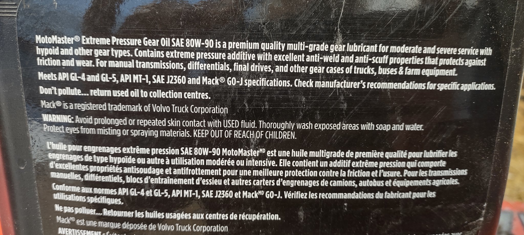

My new gear oil is 80W-90 dino, GL-4 and GL-5 compatible. Are new GL-5 rated oils bad for brass gears in the gearbox?

My oil meets GL-4 specifications. GL-5 too.
If the label states it covers GL-4, GL-5, API MT-1, SAE J2360, and Mack Go-J specs, then the GL-4 spec should allow for my use, as the manual asks for SAE 80W90 oil, AGMA 5EP extreme pressure oil or equivalent.
A GL-4 spec says to me it will be yellow metal safe.
yes the gl-4 rating should mean its be safe for yellow metals but you have to look at a product info sheet for the copper corosion test or know if the ep additive contains sulfer. I did a little research and what i could find is the motomaster gear oil is made by citgo. i looked at both citgo's premium (LS) gear oil and the premium (MP) gear oil product information sheet (i could not find motomaster product info sheet). I think LS is the limited slip gear oil and MP is the multipurpose oil. The copper corrosion test for the MP oil passed so it is good for yellow metals the LS on the other hand has no test on the info sheet for copper so I would assume its not safe for yellow metals. I have the same blower and I actually use mystic jt-4 marine lower unit gear oil because it had the copper corrision test and is safe for yellow metals.
Thx very much for the research and info, I'm going to email CTire for the product info on this lube. I use it for other equipment so it being compat would be a bonus!
how did you find citgo made the 80W-90 EP lube? I looked for a while online and some CTire employee answered somewhere it's all made by Shell!

This is about my blower auger reduction gear box. Manual transmission synchros are a big concern when it comes to EP additives in GL-5 oils, but GL-4/GL-5 compatible means there's additives to protect yellow metals from corrosion. Unfortunately finding product data with copper corrosion test values for this oil has been a futile effort.
I'm going to use the Motomaster EP gear oil I have to keep the gearbox full over the storage season for my blower. Nothing untoward can happen from oil corrosion if the gearbox isn't in operation all summer, IMO.
I'm going to call my local large Kubota dealership service department supervisor next week and ask what specific they put in B2782B gearboxes, and if my Motomaster EP gear oil is ok for it.
