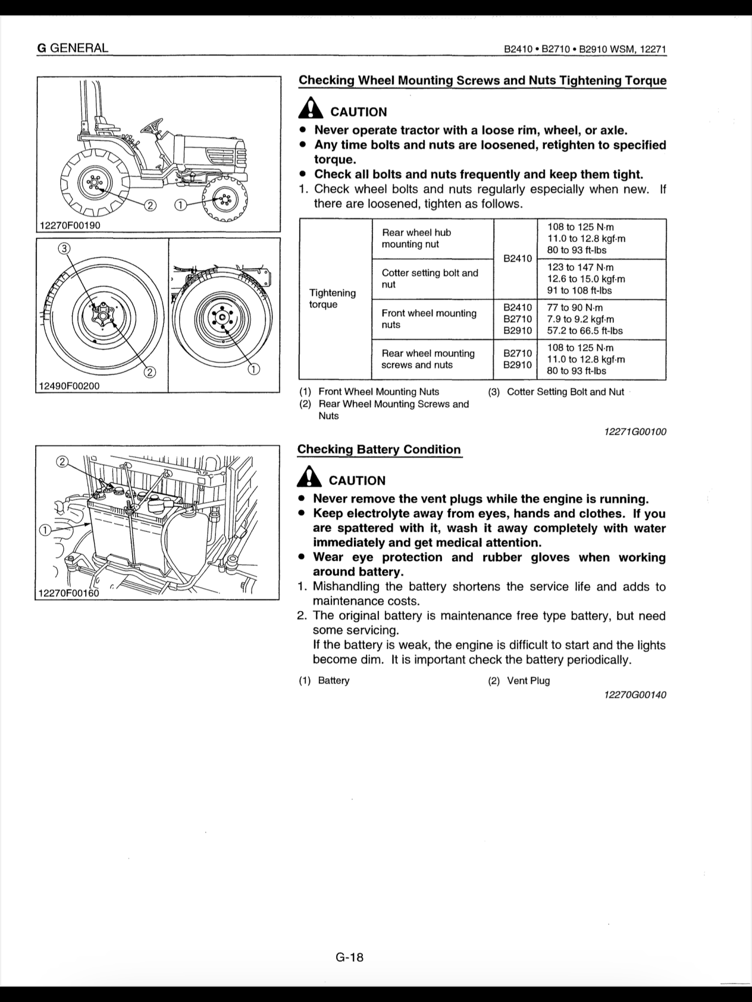

I recently put new bearings and sealed in front axle and had to change some we heel studs. So I said screw it put all new studs and washers and nuts on but can't seam to find the torq specs for the wheels. Can anyone help me with this? Th as nks in advance

all I see is tire size and inflation amount. for a last resort you may have to check average torque for the bolt size used chart.
