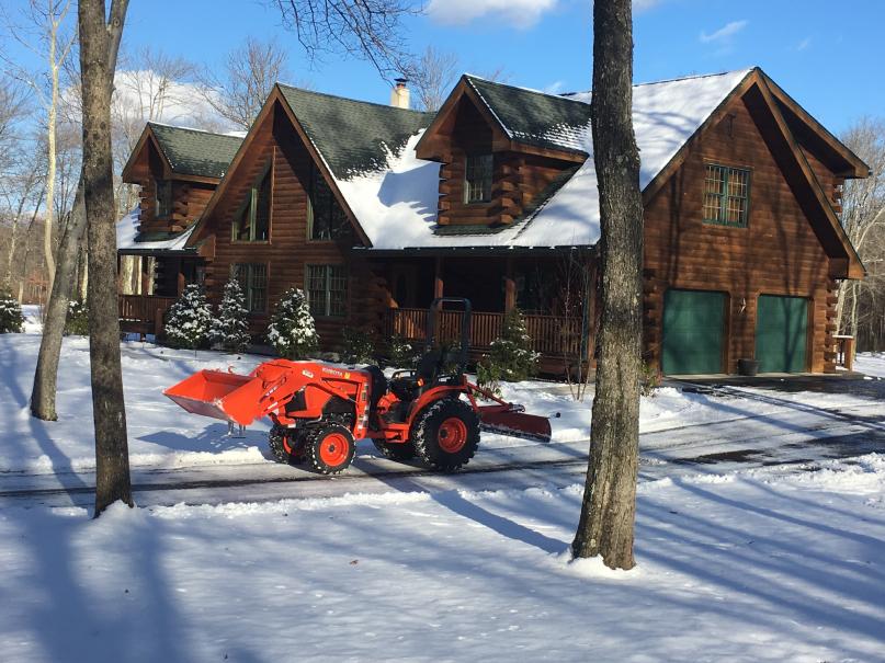

first time out with the rear blade on this new tractor. I think I have some more top link adjustment to make. Snapped a few pics as well.

Cool pics Dirtydeed! Looks like it got it down to a light film. My driveway is south facing and tends to melt pretty quick with the afternoon sun, so if I can get the same result I think I’ll be in good shape.
I dial my rear blade in every year, pretty easy. While on flat concrete, I drop the rear blade about 1/2” above the concrete(using it as a guide), adjust the left and right arms. Next swing the blade 90 degrees then adjust the top link. Takes only a couple minutes.

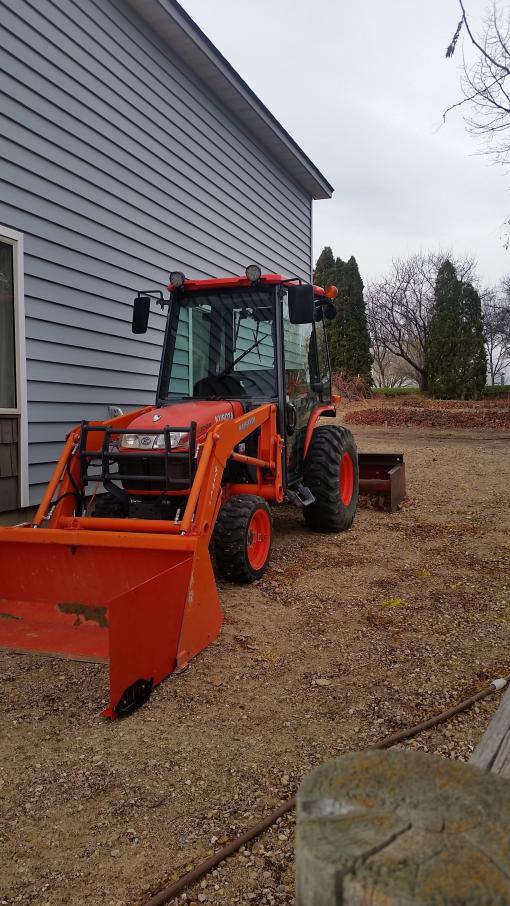

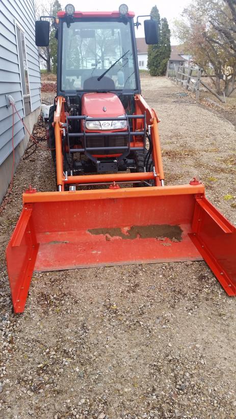

I have removed snow with just an FEL bucket and a box scraper on the back for more years than I care to count.
Last year I bought a new to me tractor and decided to enhance my snow moving abilities by making a snow pusher out of my FEL bucket.
Designed and built detacable wings and still have the box scraper on the back,
Used it 3 times this season already and can tell you that I really like the pusher. Can't believe how much snow it can gather and control the movement of. It also has cut down the time to complete the job.
This was just a design experiment to start with but I have decided its\'s a definite keeper.

I like it, already have bottom holes from piranha toothbar. A couple top mount holes shouldnt be a problem either. Problem is I cant weld, need to talk to a coule buddies!!
