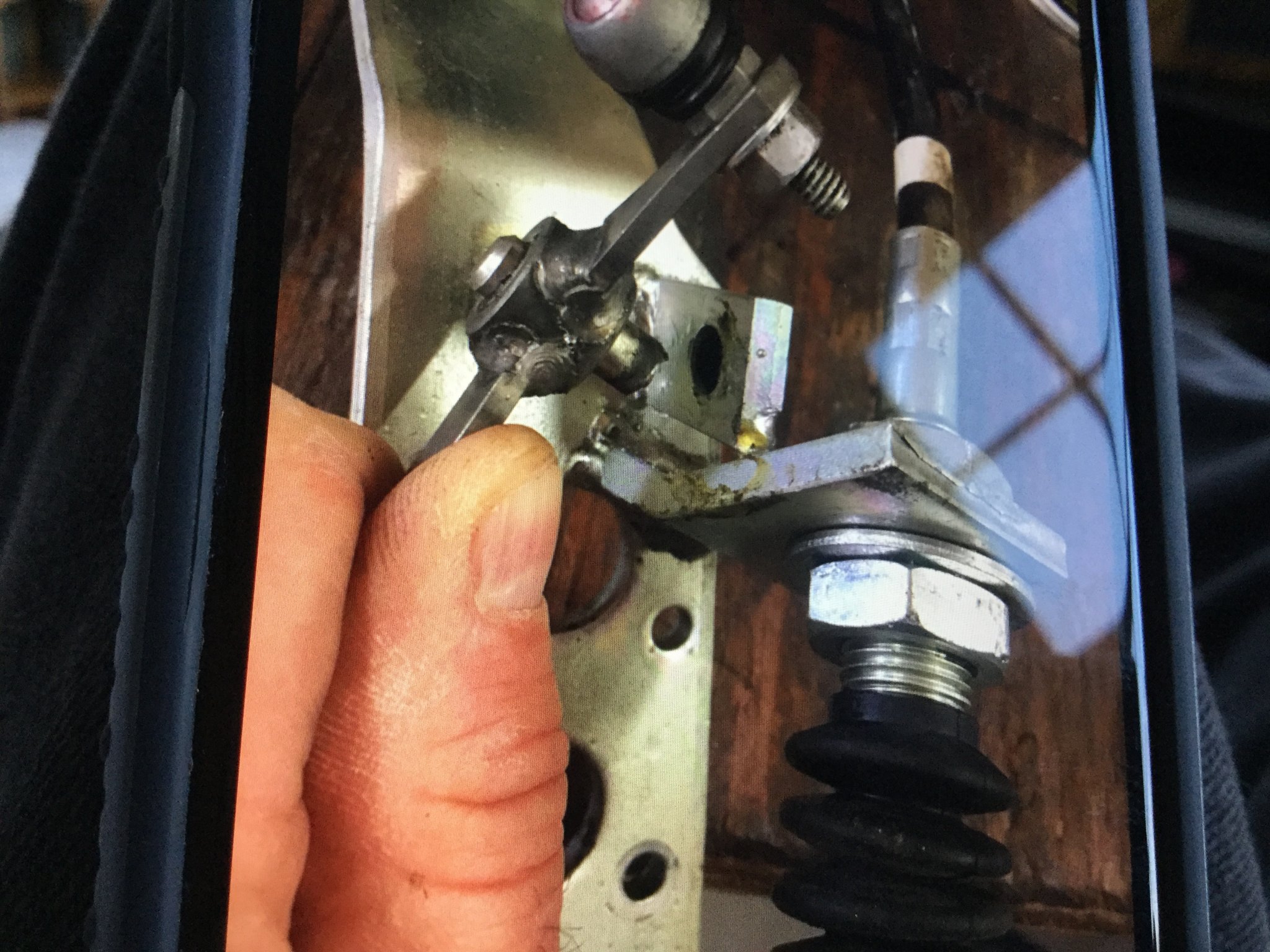

While running the front mount blower the joystick went limp! Pulled the seat and noted the joy stick cable for up and down is not connected? However; the welded in pin seems to be on the opposite side of the hole in the linkage? Almost looks like a part fell off? Any pictures or schematics would help. Thanks. image.jpg

While running the front mount blower the joystick went limp! Pulled the seat and noted the joy stick cable for up and down is not connected? However; the welded in pin seems to be on the opposite side of the hole in the linkage? Almost looks like a part fell off? Any pictures or schematics would help. Thanks. View attachment 52275
Here is a schematic of the cable and linkage. Looks like you are missing a mounting bolt also.

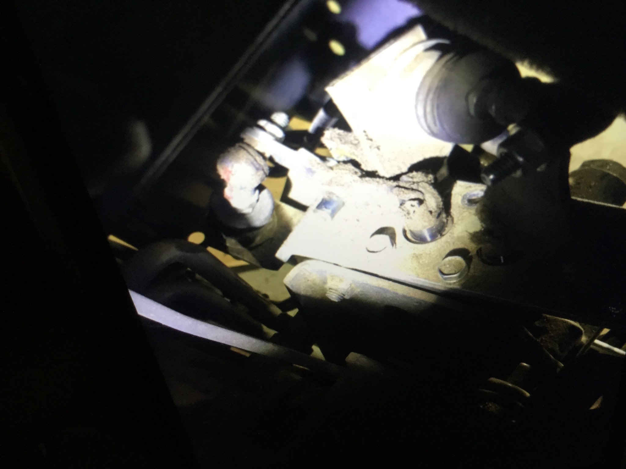

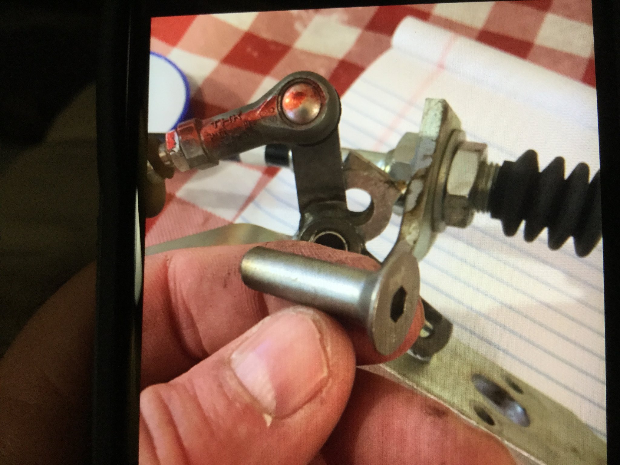

thanks for the schematic, it helped a lot. I just finished getting everything apart and found Kubota welds the linkage pins to the mount. The “B” post has sheared off. I am thinking of drilling then welded head and tac welding in some 8mm drill rod. Otherwise I would need a whole new bracket. C02587DA-F311-426C-868F-83AB4AB2EB9B.jpeg 9F1C6E6B-8B1B-4F11-8CE2-E214AED8B7E3.jpeg

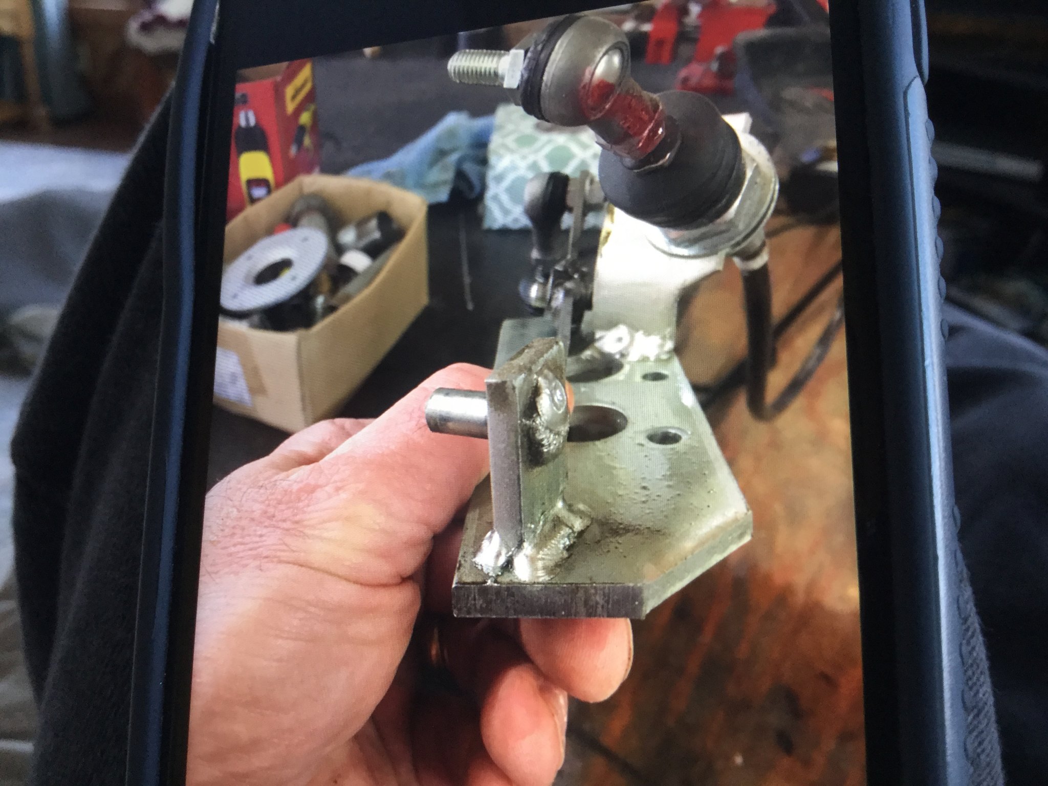

found the perfect bolt in the barn, Cut the threads off and used only the smooth C42125AF-17E5-415D-943D-8BAE3B7CA255.jpeg shoulder - cleaned out the old weld and welded this one in. Tractor is all back together and working great again.
