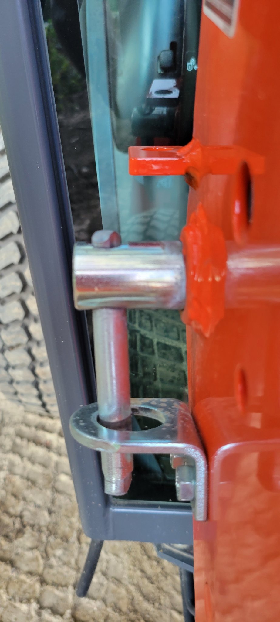

Hi all,
I noticed on my LX2610 ( silver loader pins ) are barely protruding on the back "engine side" of the loader. I never would have noticed this, until I read this thread. I assume the pin should be about a quarter inch longer. I also noticed some of the LX machines have black pins - I wonder if the black pins are a replacement. I will be calling my dealer Monday - but does anybody know of an official recall? LA535 loader....

Definitely too short. Anybody hear of a fix? My dealer is still researching...
That does look very short. My B2601 I'm sure has more sticking out than that. To be fair, it's pushed as far out as it can go without hitting the retainers, and it's flush with the hole - so longer wouldn't give more purchase, it'd be spare sticking out the side. But I wouldn't be comfortable with that little room for error.
That's a good point. When I push the pin back twords the motor there is plenty of length. It seems like the ring loop is too large rather than the pin being to short. I used zip ties to keep the pin from backing out until the dealer comes up with a fix.
