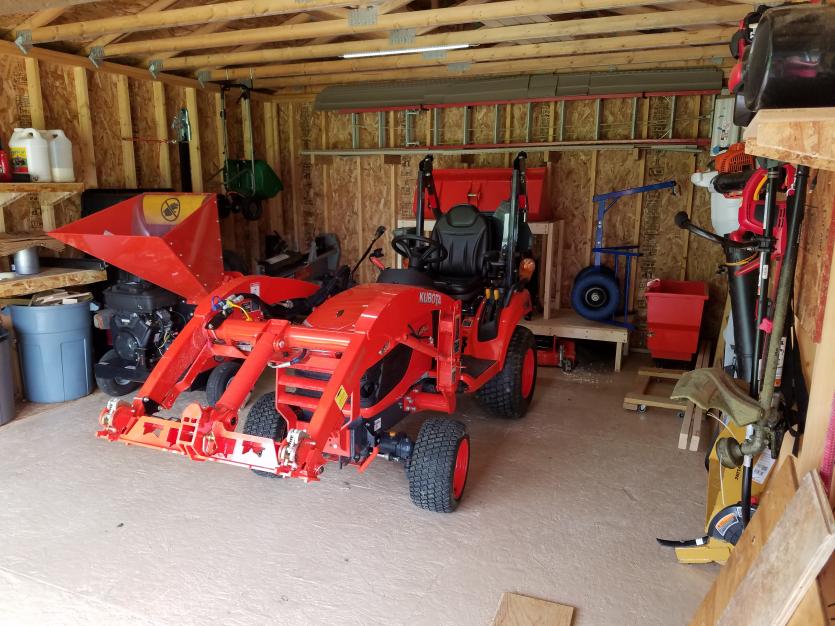

I have a BX2670 and recently purchased a Tach-N-Go from mytractortools.com. Jerry was very responsive and got it within three days. Love it. Just unclip the connects on the side drop the bucket and pick up the grapple. Easy as pie.
Here is a link to a video of it in action: https://youtu.be/6irry_PCY-w
That storage system is awesome!! I've got to make one for myself...
