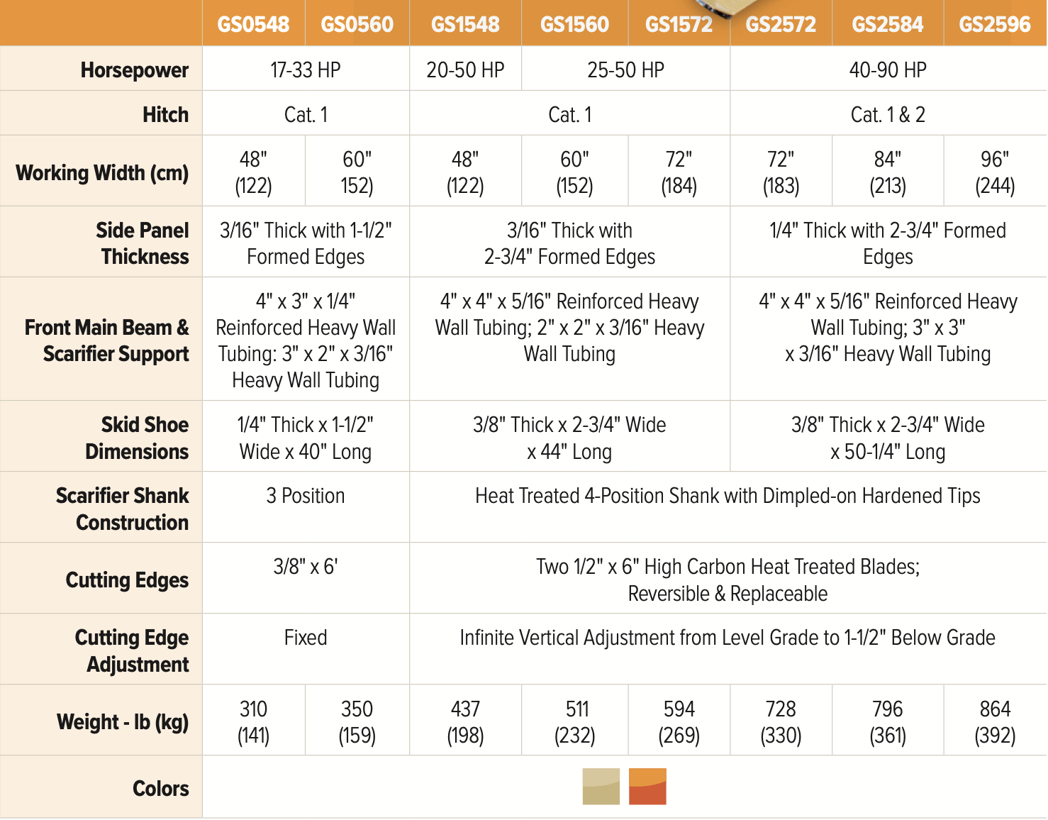

Something must be wrong with your tractor or technique, or you have the ripper shanks all of the way down. In my use maintaining our 1 mile community road and my 1/4 mile driveway, I've only had to use the ripper shanks for potholes after Winter. I have a GS2572 on my L2501. I usually only use 1 or two shanks at a time since potholes aren't as wide as the grader/scraper.
Otherwise, if you got the advice from Travis at EA for normal usage, I think you might have got bad advice. From my use, 6' is way too small for a 59HP tractor. It could easily use a lot wider model which will save passes in most uses.
Here's a video of a B2601 with LandPride GS1572 being demo'd by their product manager.
Also, their documentation, also says a GS1572 is recommended for 25-50 HP models.
