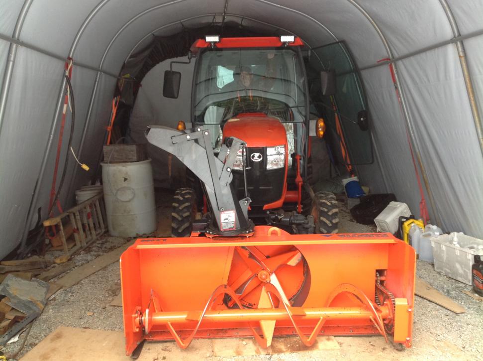

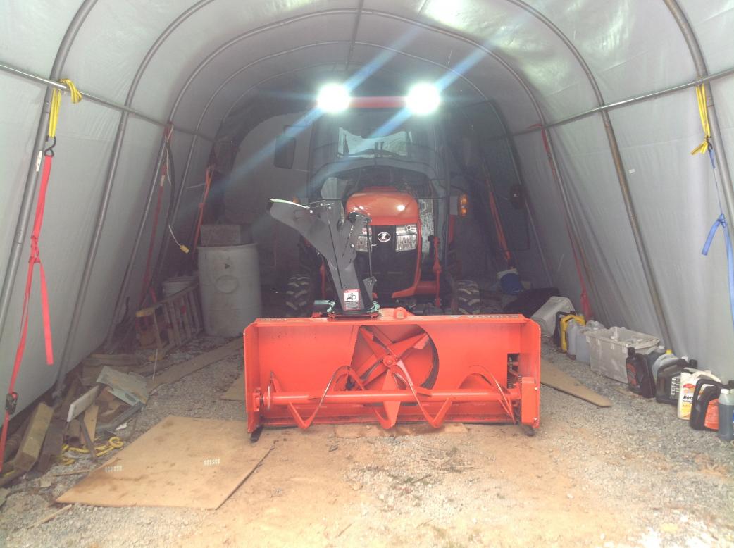

Well -15C can't stop us crazy old posties, lights came in and their on and I have to say I'm impressed. If they look this bright in the day they should be a major improvement after dark.
