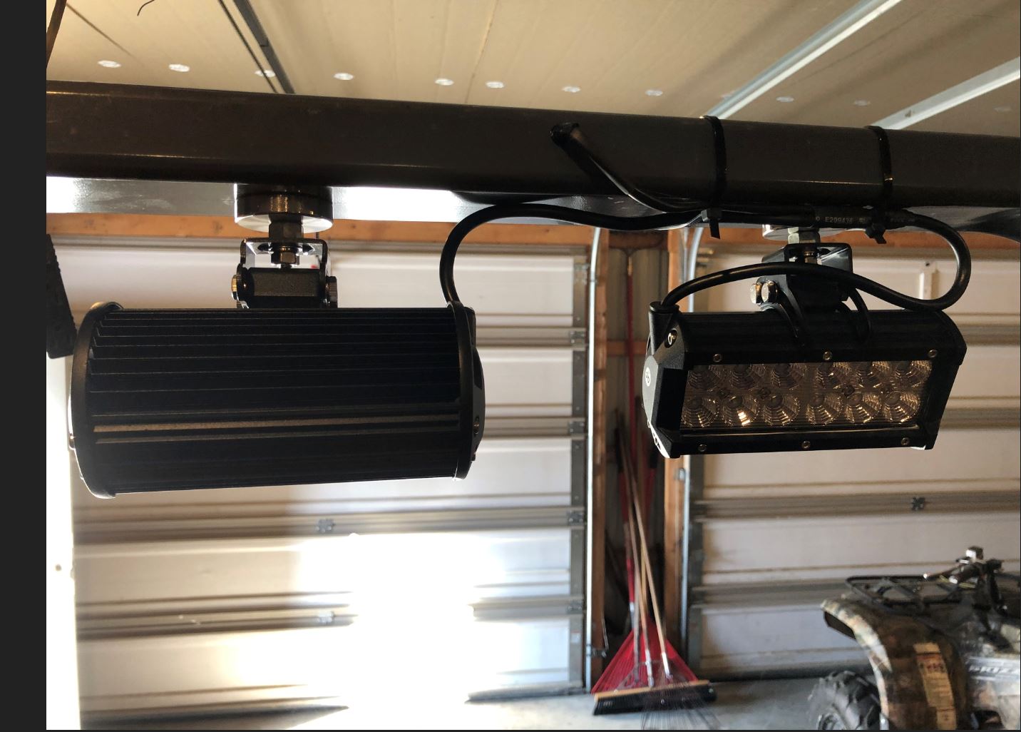

Here's a simple set up that I used... and the lights I got. I mounted the lights on magnets.
I think the magnet idea looks great! Very clean. No problem with them getting jostled and falling off?
3,345
4,683
I
Not a chance. If I recall correctly, they were rated for 125 lbs each. They are very strong but can be removed/repositioned if necessary.

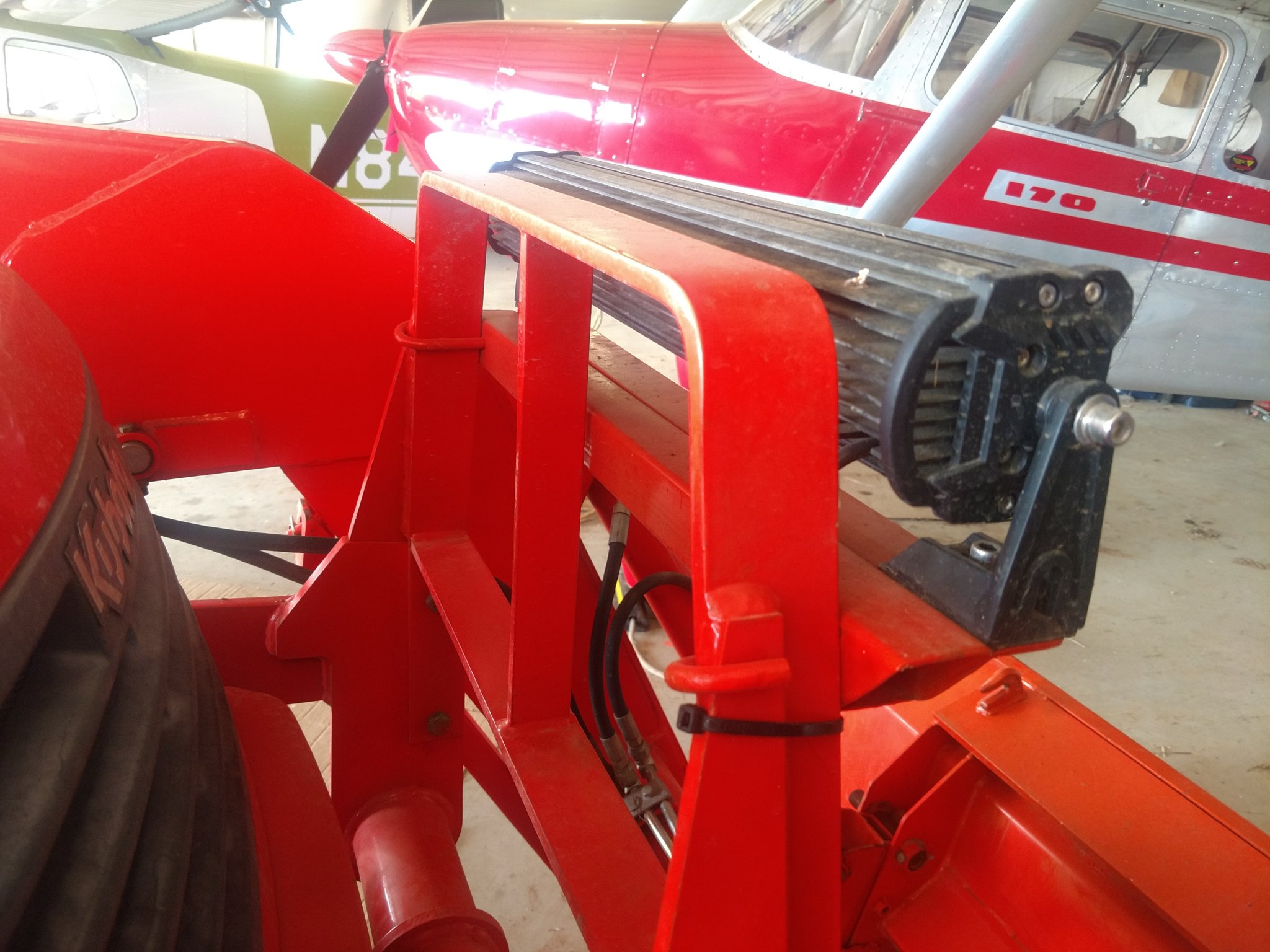

Is your light bar mounted to piece of wood and then mounted to your grill? Or is that just the light in the photo?
I mounted it on a 1” piece of angle…which was welded* to a 1” piece of square tubing…which was drilled to accept a “J-bolt” (Tractor Supply Co.) which hooks onto the grille. Hot wired to the Pos-cable at the starter thru a rocker switch installed in the instrument panel.
*welding is not really necessary as the J-bolt passes thru both angle and square tubing…so would hold them both in-position…. I just didn’t think far enough in advance as I assembled this. :geek:

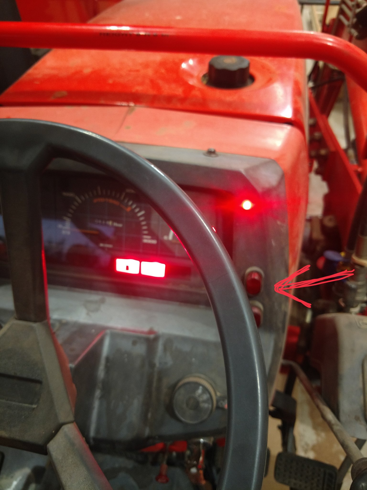

I went the simple route on the ROPS LED's...used the existing holes in the ROPS and mounted them on each side (use them primarily for snow plowing with the ROPS down), used the accessory socket under the fender and a little wire...literally just plug them in using bullet connectors (easy). The lights come with brackets...and used a bolt with a wingnut so they can be easily loosened and flipped to point either forward or reverse (or one each way). They are on all the time but are low powered and being LED's should not burn out for a while. And they are also cheap to replace if ever needed and plenty bright for the little I use the tractor at night in the winter. picture below
