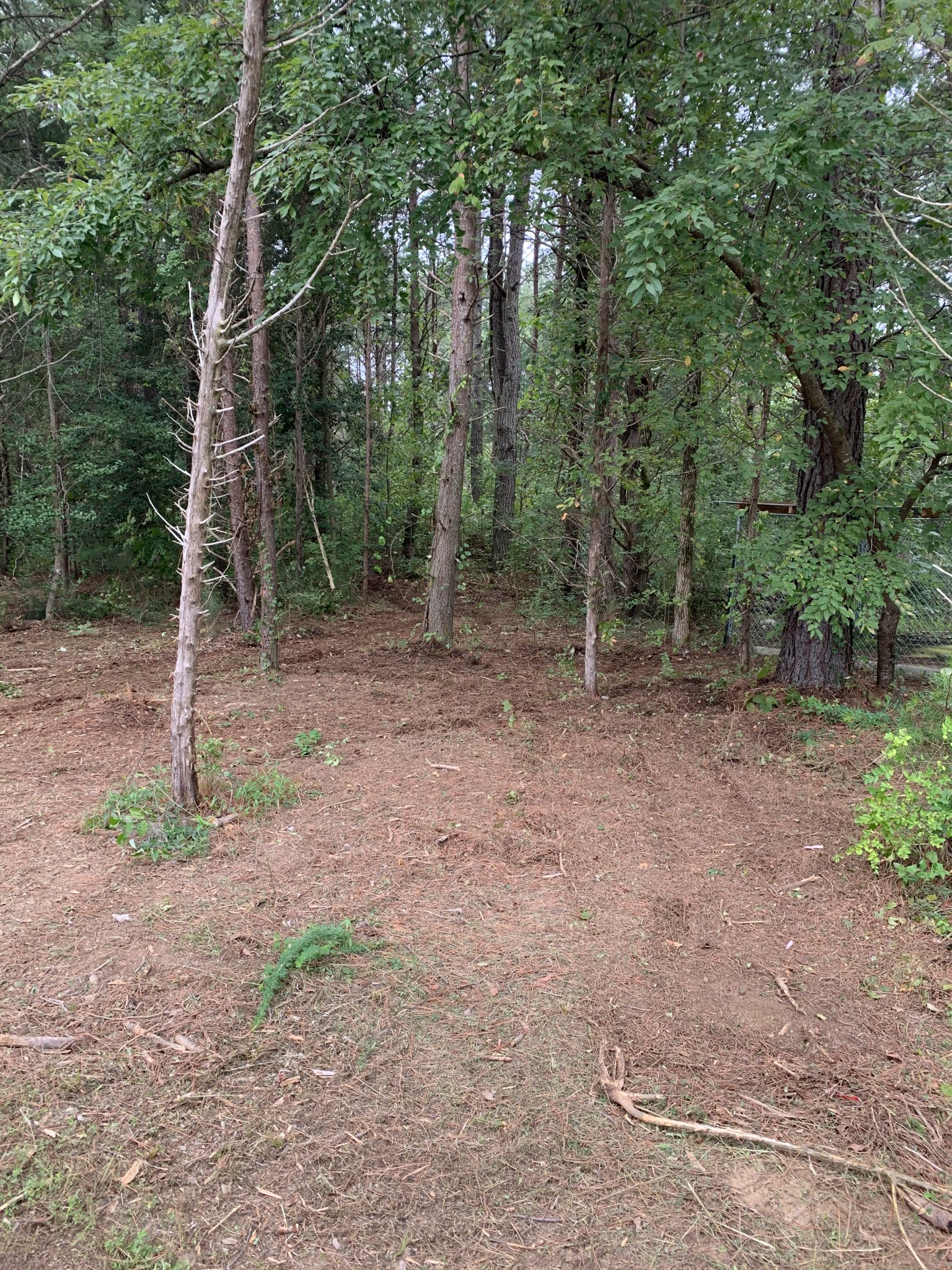

It’s coming along nicely here. Pictures don’t do it justice, it’s completely changing the woods here. In this picture the entire area was 5-6ft high of underbrush, you couldn’t see 5ft into the woods.
