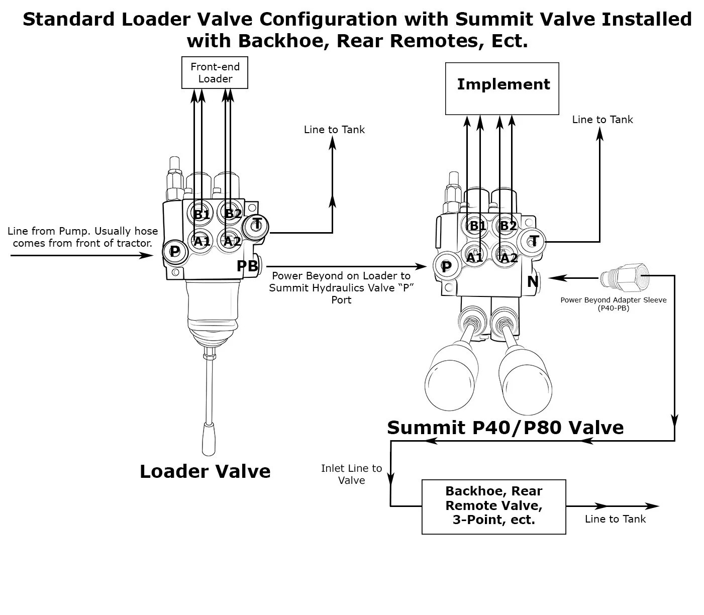

I am goung to be real frank. This has been done many times over. You dont need or want a valve that size.
You are killing yourself in both time and money trying to pinch pennies. Get a 10 GPM P40 valve with power beyond sleeve from any supplier and spend another $28 for 7 new port adapters.
6900-08-06 4@$3.64
6901-08-06 1@$6.93
6901-10-06 2@$7.46
Buy them here and order on any Friday for free shipping.
You can save another $150 by using a two lever valve rather than the joystick which is wasted on this application.
Plumb it up as shown here
