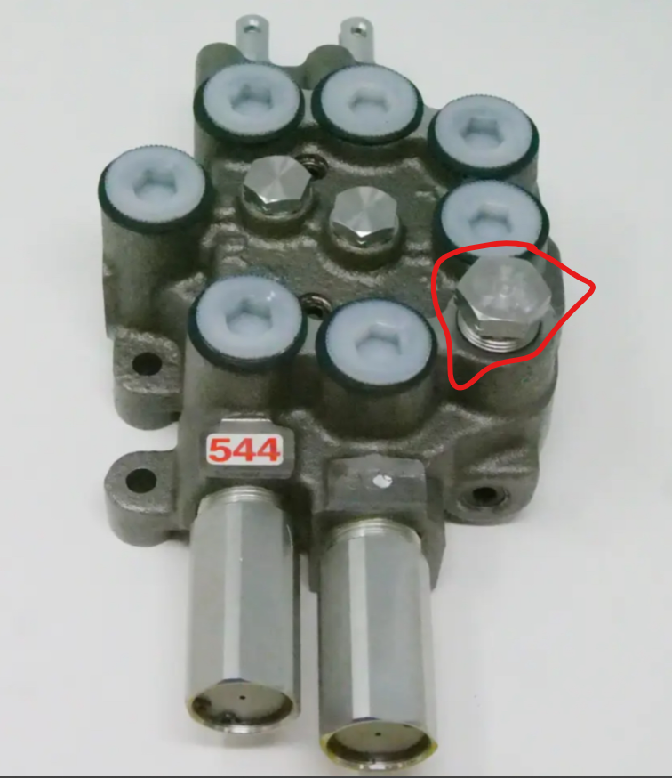

Well Dan as they say hindsight is 20/20! I can’t go back now since I have used all the fittings and hoses! But maybe you could help me with my latest search, which I have not been able to find the correct Power Beyond adapter sleeve for my valve. I have reached out to the seller that I purchased it from but they don’t sell it, they did say they would contact the manufacturer to see if they could help me but have not heard back yet. I need a size that must be not used very often. It’s the following: 12 SAE male to 12 SAE female
Power Beyond sleeve, my valve is a 2 spool
21gpm single joystick, model JYP80-QT 2/1
If you know of a source for this type, please let me know. Thanks for your help

I cant help with the PB sleeve and thats the priblem with these cheapies from fly by night suppliers. I will say you are way oversize on the valve. You may need to start fresh there
I have started a return on this unit and will be looking for one that I can purchase with the PB adapter sleeve, I looked at the one you sent me but the SAE fittings are different so I’m looking at other options, but if I don’t find something else I can just have to purchase it and buy different fittings. Thanks
I am goung to be real frank. This has been done many times over. You dont need or want a valve that size.
You are killing yourself in both time and money trying to pinch pennies. Get a 10 GPM P40 valve with power beyond sleeve from any supplier and spend another $28 for 7 new port adapters.
6900-08-06 4@$3.64
6901-08-06 1@$6.93
6901-10-06 2@$7.46
Buy them here and order on any Friday for free shipping.
You can save another $150 by using a two lever valve rather than the joystick which is wasted on this application.
Plumb it up as shown here

Well, I started the return of the first control valve, and I ordered a different valve than I had previously purchased, it is a 2 spool, 11 gpm, 3600 psi, with SAE #8 and #10 sizes for the ports and it comes with the correct power beyond adapter sleeve. Should have it by next Tuesday. Just had to order 4 different fittings for the new valve but $48.47 latter it still gets me to pay so much for such a small item that probably cost 3-5 dollars to make. So that’s about a 250% price difference between make it and sell it. Now I know ever time it moved between manufacture, shipment, distribution and final sale each one added more to the price but someone along the way really is getting rich. Just saying!
