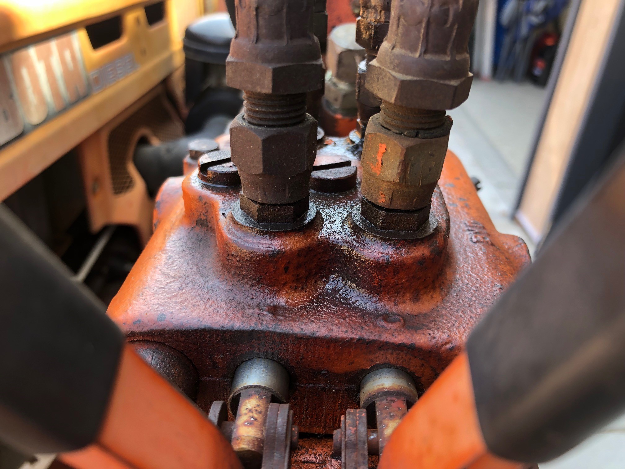

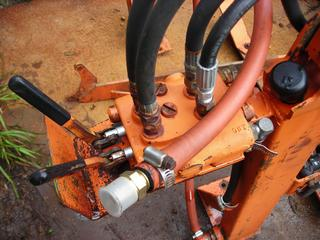

Thank you so much for your detailed replies. Very helpful. I've attached actual photos of the unit on my B7100 - the first one was a photo from the web. I'm thinking the Prince valve will be the best fit because of the vertical handles. The 3rd photo is what I assume to be the independent pump and therefore the need for the power beyond function? Will have to research that but please could you let me know if the pictures change anything or whether I will be good with the Prince? Many thanks!

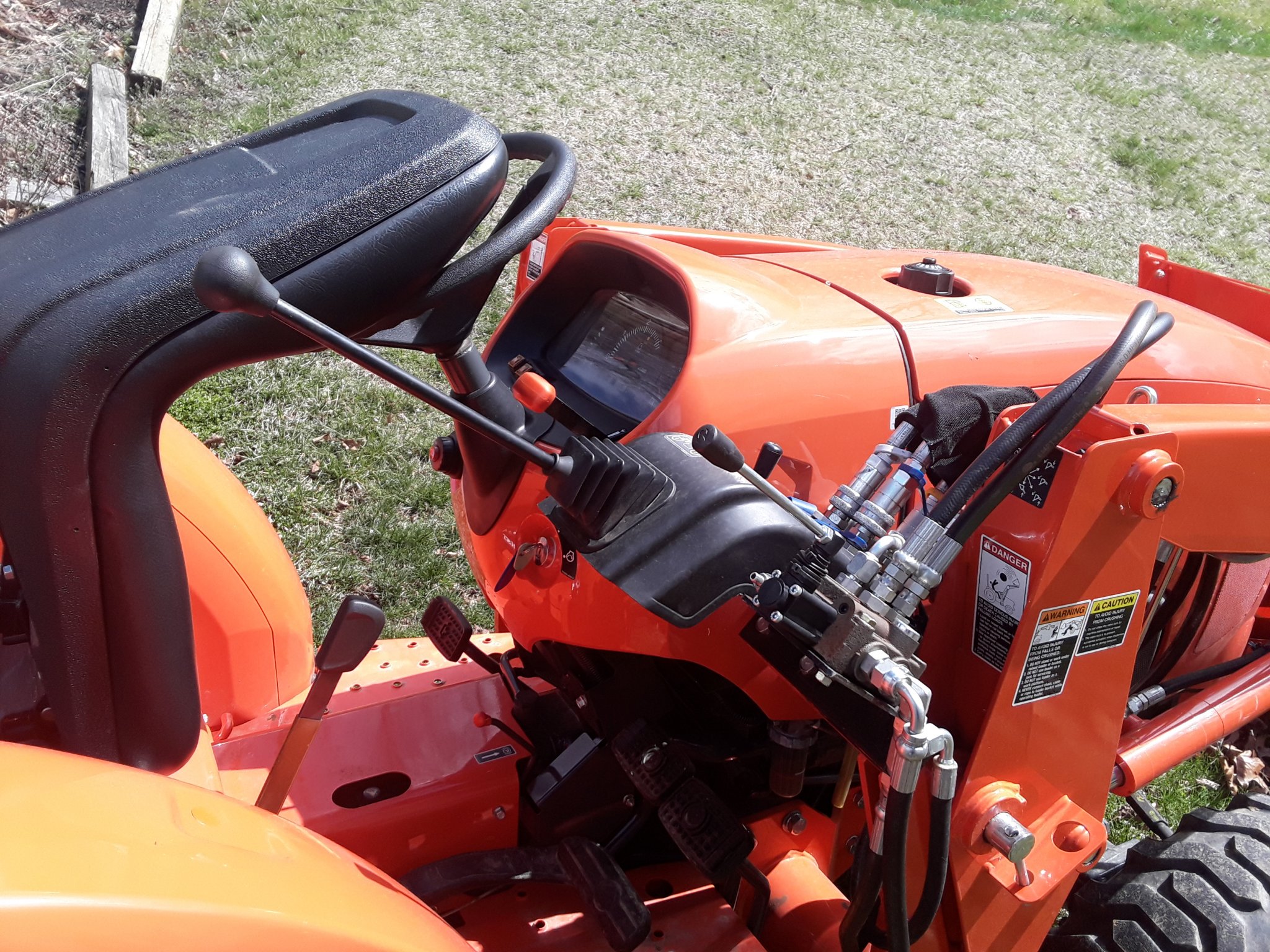

With the system as you have it you do not need a valve with power beyond. However I would suggest you purchase a valve that can be converted in the future if you add additional valves. The Prince and Brand valves are both convertible. The Prince valve will come configured for open cenyer operation and the conversion plug will he in the box. Yhe Brand valve will come configured for power beyond and you will need to remove the conversion sleeve and replace it with a plug.
My personal opinion is joystick loader control beats two handle control hands down. Either one of those valves will work with the mount you currently have. You will probably have to dril one or more new mounting holes. Current model loaders have the joystick valve in roughly the same position just angled upward slightly. You might want to bend the joystick handle to angle it up a bit if you go that route.
Here are a couple pictures to illustrate what I mean. The top one is an OEM joystick valve on a B7200 with B1630 loader that is very much like yours. The bottom one is the OEM joystick on my new L3901 and the single spool version of your MB valve mounted next to it for third function.
Ojaikubota
Yes, that shows an independent pump driven from the front of the crankshaft, so you will NOT need Power Beyond unless you later add additional hydraulic accessories (eg: grapple). Of course, if you are planning to add something like that, you could consider buying a 3 spool valve assembly now, and not have to worry about PB to a second control valve later. But if you are happy with what you have, then just that Prince is fine.
I can't tell from the pictures if the mounting holes will all line up -- you may need to fabricate some sort of new plate or drill new holes in the existing plate. Just don't drill into the post -- it is your fluid reservoir! I also can't tell for certain what the ports are. I could make an educated guess, but I won't. Simple enough to take a sample of each hose size into your local farm supply or hydraulic shop and tell them you need adapters from these hoses to SAE -8 ports.

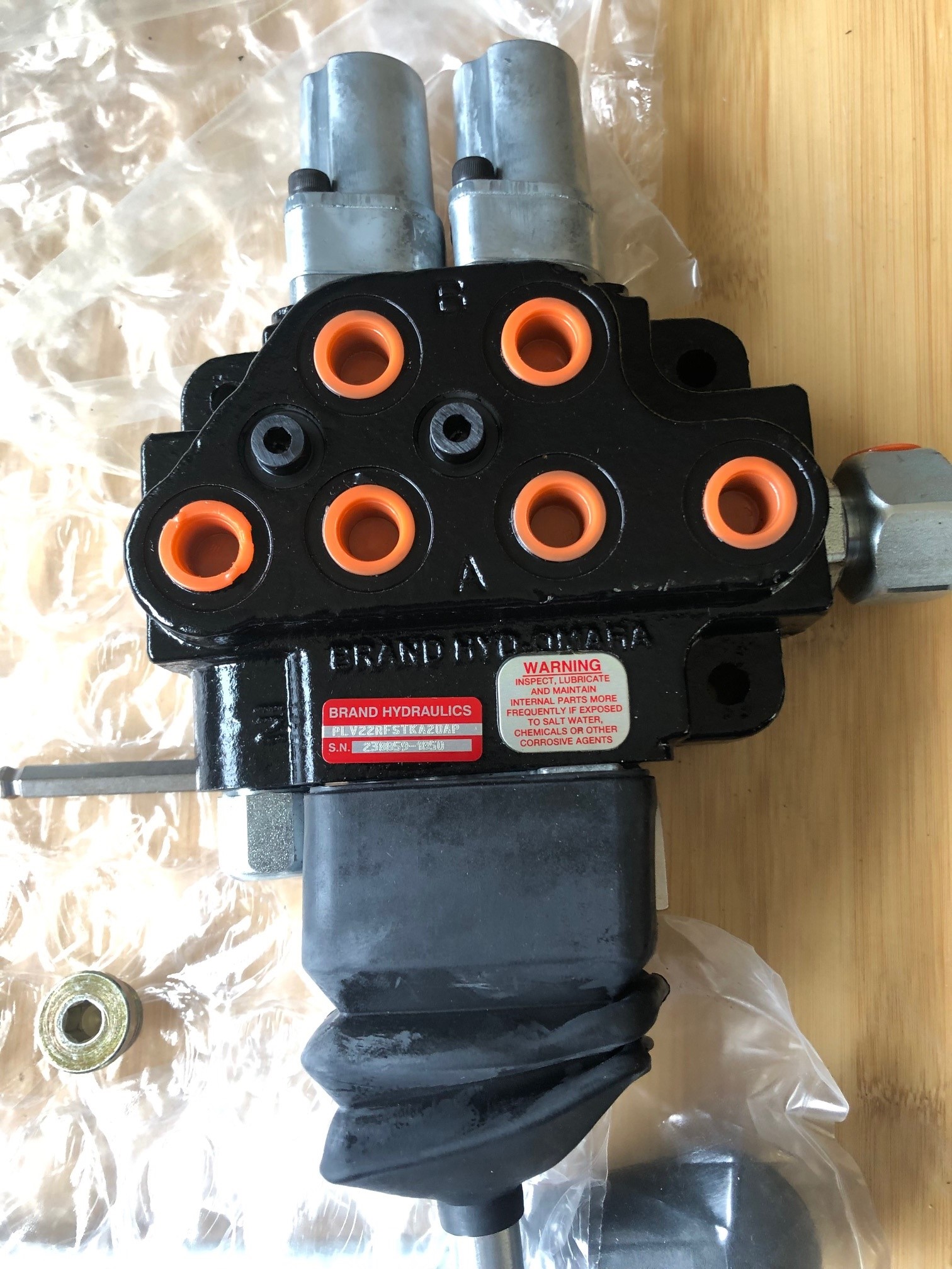

Many thanks for your comments. I have ordered the Brand joystick unit based on your comments!
Ojaikubota
I think you will like it. Both valves are longer then your original and you will probably have to move them rearward for clearance on the loader post. Replace those rotten hoses while you are at it ;)

Yup, good choice. Not only is the single-lever joystick an nice modern touch, the Brand product listed above also features a regenerative (fast) dump position.

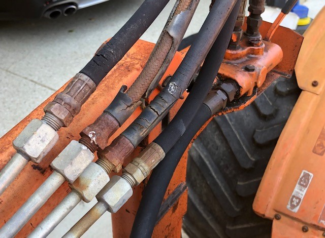

Requesting the further benefit of your knowledge please? I got the Brand valve and now have to figure out how to connect the 1/4" NPT hoses to the SAE6 work ports. It seems my OEM Kubota spool valve has some kind of adapter at the valve end of the hoses and is a straight NPT connection at the other end. I can't get the adapters off the valve because I don't have a thin enough wrench and I'm not sure they would help anyway. My question is what are these adapters called (swivel?) that allow me to tighten the hose onto the valve without twisting the hose around? Can I get them from Surplus Center but I need to know what they are called first? SAE 6 Male to 1/4"NPT Female straight swivel adapter would be my guess? Super thanks in advance.
Ojai Kubota
8,937
4,707
^^^ Yup, that's the ones.
The P, PB, and T ports are also going to need adapters. The side ports are all SAE-8. The top P and T ports are SAE-6. At a minimum he will need to remove the PB sleeve on the side and install an SAE-8 plug in that port. If he wants to use the side ports he will need SAE-8 adapters for them and SAE-6 plugs for the top ports.
True. He may want 90° adapters if he uses the side ports (as shown in one of your pictures). Looks like clearances might be an issue if he uses straight adapters on the sides.
And new hoses. That thing desperately deserves new hoses! ;)
When i put new hoses on they almost invariably have JIC female swivel ends. My preference is JIC-6 on 3/8 and JIC-8 0N 1/2".
