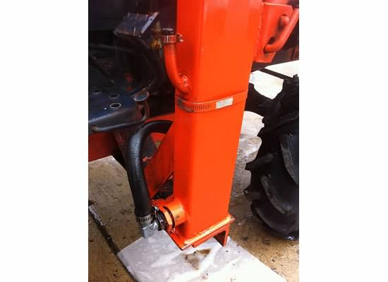

My little B6000 loader has been working great, but in spite of being properly filled (4 inches below breather with rams fully retracted according to manual) the FEL will blow fluid out the breather when hot which is irritating(kinda burps out fluid randomly. I am using a Universal hydraulic fluid and was thinking perhaps the lower quality fluids cannot handle heat so well and expand rapidly? The other issue is the low pressure return hose fitting is on the front of the reservoir tower leaving almost no room for tight turns so I get rubbing from the front tire on this fitting - I saw a pic of a B219 with the fitting on the opposite side of the reservoir/tower which made a lot more sense

My low pressure return is on the rear of the tank, but the high & low pressure hoses are strapped to the angled front support until they are back near the tank, keeping them away from the tire.

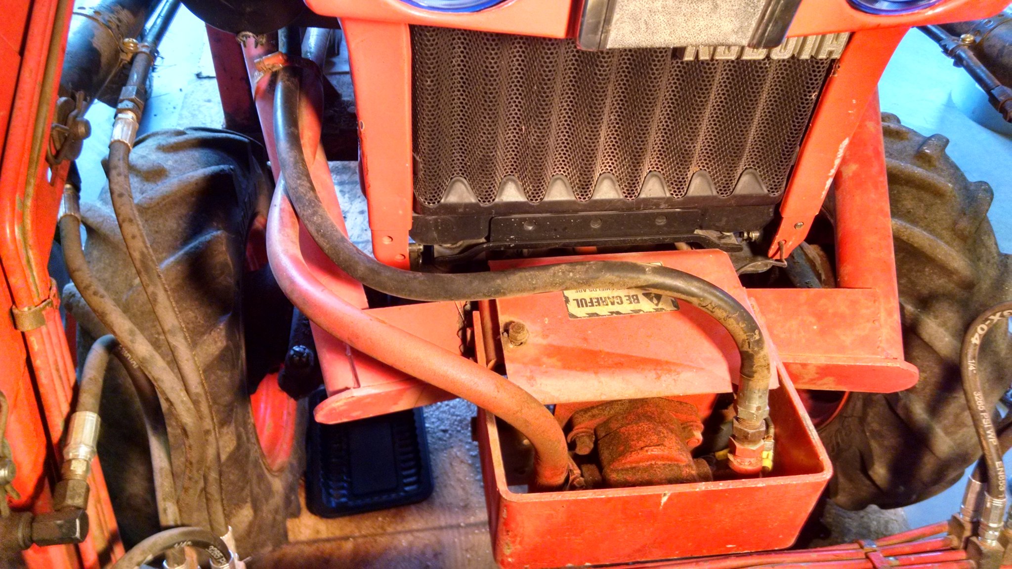

Thanks all, I believe I figured out the problem - so my my front tire when turned at a sharp angle will start to push off the low pressure line and create a leak which then sucks air. I did push hard into a plle of 3/4 quarter minus rock which put too much force on curling rams (create the burps) I think I am going to have the low pressure fitting cut off and moved to the opposite of the reservoir to avoid the front wheel contact and the fitting for the hose to the loading valves moved to that side - why my fitting is on the front towards the wheel I shall never know-thanks for the help!
