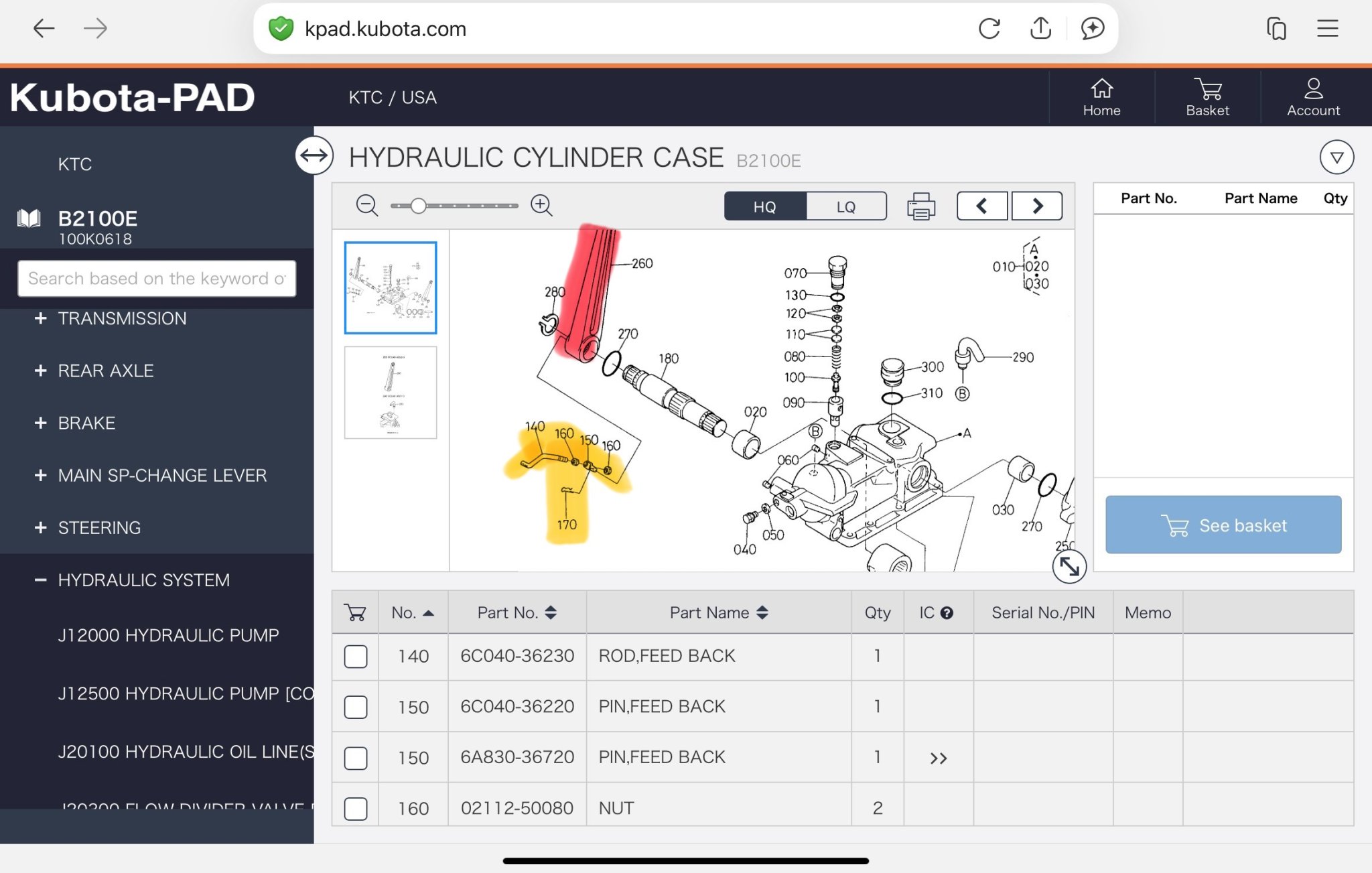

This diagram is from the Kubota site
The right side (facing tractor from the rear) short lift arm is highlighted in red below. Connected to that is the feedback rod mechanism that is highlighted in yellow below. The feedback rod is connected to the control valve inside the tractor. It tells the control valve the position of the arms and the control valve then tries to make the lift arms return to the set position if they move. See if that is all connected together but not frozen together at the ends (some movement is required).
