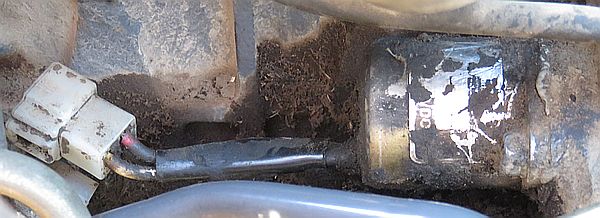

Today, I disconnected the stop solenoid (second photo), and the engine turned over no problem.

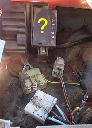

What is the part with the "?", beside the rectifier? I also disconnected that today, at the same time as the solenoid, but didn't try starting with only that and the rectifier disconnected.
TEST 1: Rectifier disconnected - fuse blew.
TEST 2: Rectifier, "?" component, stop solenoid disconnected - engine turned over.
Hope that was clear. What next?

The module you have a "?" on is your flasher unit for the hazard lights.

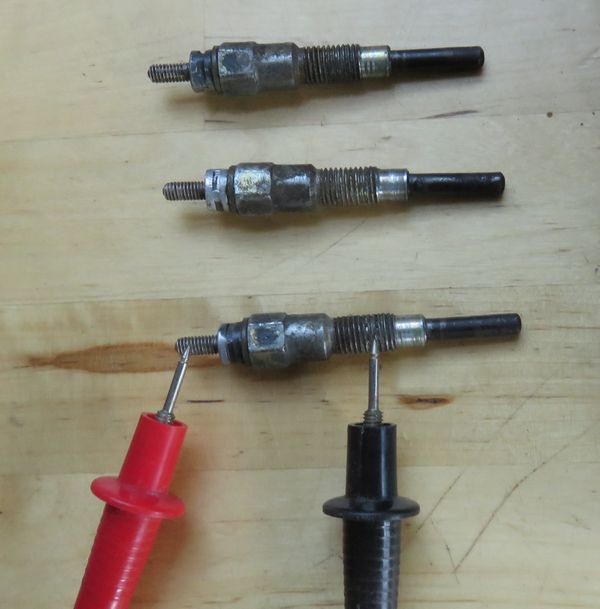

Tested the 3 glowplugs: 2 x 1.2 ohms, 1 x 0.6 ohms -- that means 2 are bad?

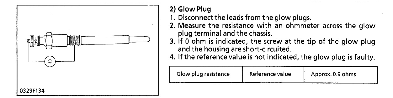

The reference value is 0.9 ohms approx.
Clean yours up on a wire brush before deciding which one might be bad,
It is hard to get a good contact on dirty surfaces with a meter.
Note #3 about 0 ohms because your issue is a short and your readings do not indicate a short

Actually I'd say 1 bad plug, the .6 ohm one.
'math'
say battery is 12 volts
#1 plug 12 V/ 1.2 ohms = 10 amps
#2 plug 12 V/ 1.2 ohms = 10 amps
#3 plug 12 V/ .6 ohms = 20 amps
Total current is 10+10+20 = 40 amps. That'll blow a 30A fuse real quick !!
ANY plug with LESS than the 'reference' is probably bad.
Odds are the battery will be closer to 10 volts when heating up the plugs, so each would draw 10 amps +-, dang close to 30, could pop a fuse.

I'll clean the glowplugs and retest.
I watched several videos about testing diesel glowplugs, which I followed, as in the photo above. They all said that a reading of over 1 ohm indicated a faulty plug, 1 or less meant good?
So if these aren't shorted, that means the problem isn't with the glowplugs?

Last test, the stop solenoid was disconnected and it turned over at key Start position, instead of blowing the 30A.
New tests:
1) Used the multimeter on the solenoid connector: just above 15 ohms. (The meter reads 0 when the probes are directly touched together.)
