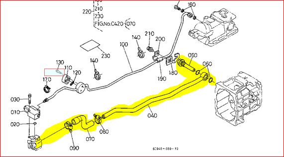

OK, I'm a bit stumped.
The line you marked looks fine, I can't see any hint of a leak anywhere along it.
However there is some oiliness at the rear (transmission?) close to that fitting - but it looks like it is coming from the hose not the hard line. As far as I can tell, that hose is a return line from the FEL control to the reservoir, so it shouldn't be drawing any air?
There is also a fair bit of oily dirt caked around the hydro dip tube, so there may be a bit getting up past the dipstick o-ring - but again it's difficult to see it drawing air in that way?
9,188
4,771
On 40 in the picture. Is there a rubber coupler on it?
If so, for cheap insurance, I would replace that rubber coupler :) All it takes is a pin hole in it to start sucking air. And It may not show up as a weeping leak. I would also change the hose clamps from the spring loaded type, to a screw type clamp. ;)

Hi Daren, thanks, part #70 is a short rubber hose, is that what you mean? I removed and reinstalled it with new hose clips, but it hasn't fixed the problem.
