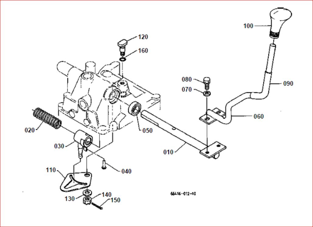

Your going to need to pull, it apart and remove pin #40 to get the shift rod to come out to get the seal in.

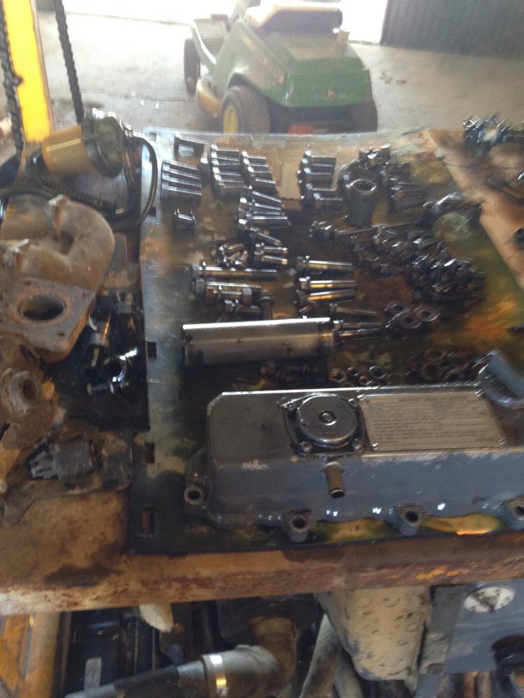

This is the other project I'm about to take on.
Kioti DK35 with a blown engine.

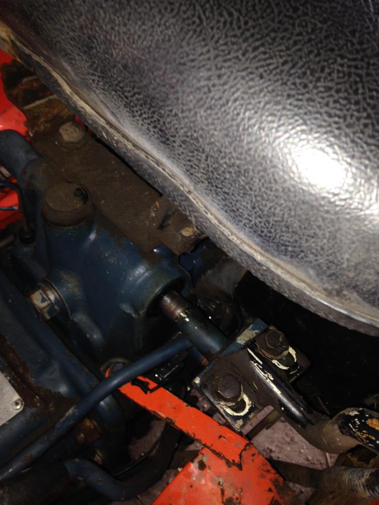

I think I can do it, just going to wait until I order the repair manual.
I know it's been a while, but did you get the job done? How much needs to come off to do it? It appears that my 3-point controls are going to be in the way of removing one of the bolts holding that cover on.
