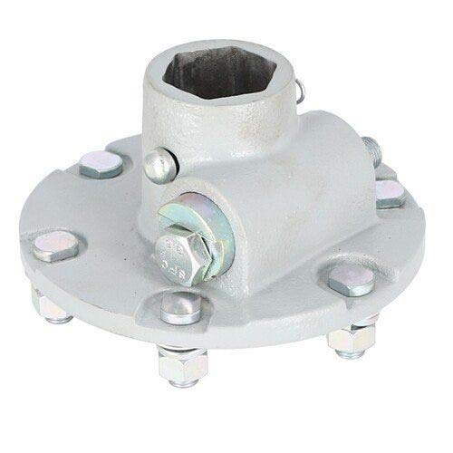

I've seen quite a few posts about various methods to fix the old style hub clamps - including the fabrication of shims, grinding the clamps to allow more "travel" and replacing the hubs themselves with more up-to-date and effective ones.
I've just found the following replacement hubs which look easy to fit and seem a reasonable price for a pair. I just wondered if anyone had tried these or have any comments as to how effective they might be?

They will help for a while, but this style makes it rock solid and lasts for ever, even on a worn axle shaft. I just put a set on my B7100HST.
