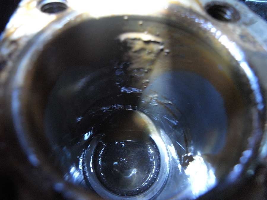

Inside the piston cover, looking in the bore!
Well, I got another chance to look over the tractor. I left the penetrating oil in as you suggested Dusty-t and the cover came off with some force (for some reason I thought WD-40 or similar wouldn't go well here...). So, I syringed out some more burnt smelling and gunky oil that had I guess been sitting on the flat for long enough that there is a little surface rust on the top of the bore where the oil wasn't. Also, there's evidence of a ring of rust halfway up the bore where I presume the piston sat for a while. However, the piston looks to be right back in the chamber and I can't tell if it's stuck but at the bottom it doesn't look rusted. There's a little pitting in the underside of the piston cover, within the circle, and bits of light rust, but after cleaning it doesn't look as bad as in the pictures.
So, are we veering back to the pump here! Or, could this explain why the rockshaft won't turn at all anymore, perhaps the piston was in the middle, now it's gone down? Does it shed any light on the reason for no movement in the rockshaft 3PH?! Also, I don't suppose someone could explain the movement of the oil through here ordinarily.
Any thoughts much appreciated.
Tomorrow I will start her up again, run her for a few minutes and take a look inside that piston cover again to see if any oils made it in...although it looks like no new oil has made it there for quite a while.
thanks,
Dookanooka

Hey dookanooka, glad you got it apart. I was going to say something about the wd40 contaminating your hydraulic oil but I was also thinking by the time you are done with this little project, you will have to change it anyway. I am thinking that you should be able to move the piston by moving the rock shaft. It might not move easy but you should be able to move it. Do you have the arms for the rock shaft. If not it may be hard to get enough leverage to move the piston. There is only hydraulic pressure one way on the piston and I think the oil comes in from the top. I could be wrong on any number of things here , so take my advise with a certain amount of caution. Hope I have helped a little anyway. Keep us posted and pics lots of pics.:D dusty
