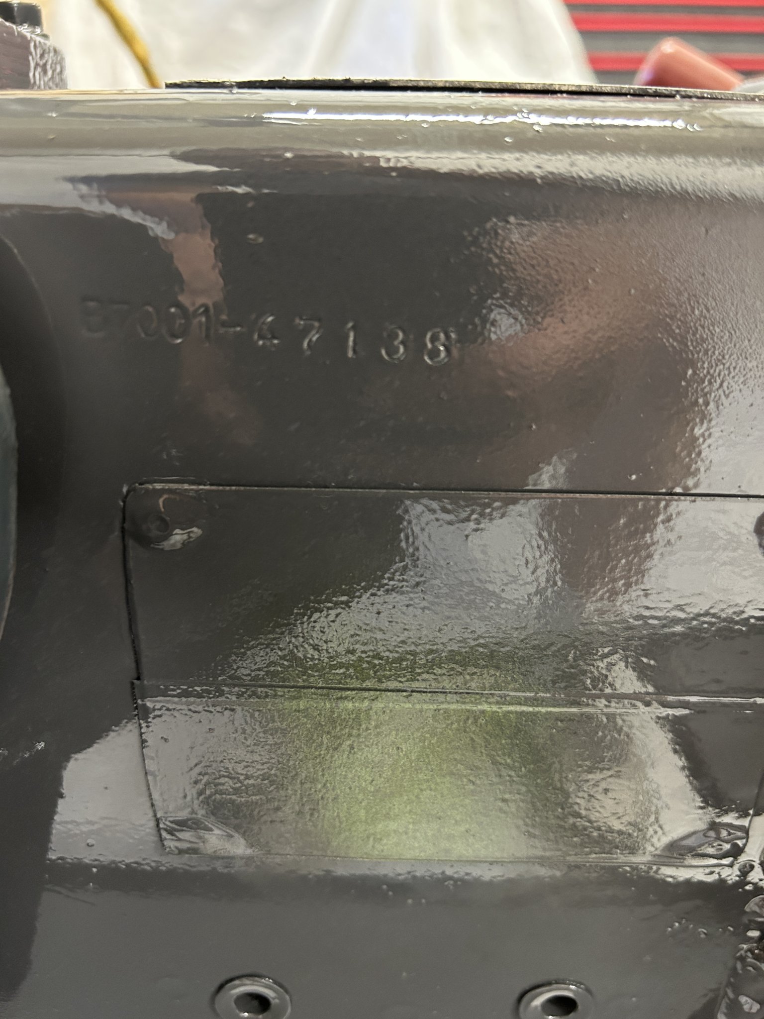

i bought a B 7001 with a b7100 hood, the seller put new tire on the tractor, the one in the back are 8-16 as it is suppose too, in the front they installed 6-12 nhs,my tractor is a 4dw, I don,t want to break anything of course, 5.00-12 and 5-12 seems like they have the same outside diameter, can someone guide me?

1st - lets establish something, do you own a B7001 OR a B7100 that has a serial number that starts with B7001.
Since you have the "hood" markings as B7100 - chances ARE it is a B7100 and not a B7001
Many early models of this tractor were REALLY B7100's , BUT the serial number started with B7001.
Is your machine a geared tractor? I am going to assume it is a B7100D ( And it has a 4 bolt pattern front rim?)

1. If you are calling it a B7001 with a B7100 hood just because the serial number starts "B7001", be advised that is normal for an older B7100, it doesn't mean the hood has been changed.
