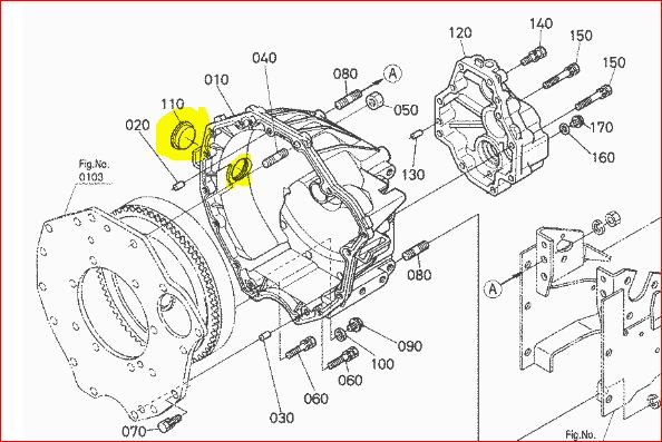

Vic... how do I access the serviceable grease fitting on the clutch throw-out bearing ? I have never serviced it:( Thanks in advance! Butch:)

There is a fairly large rubber plug on the side of the bell housing.

Ok... I looked and located the rubber plug. That sucker is behind the hydraluic lines from the block to the control valve. Also... to make matters worse the square post that the control valve is mounted on is dead square in front of the rubber plug.
What I am trying to say... you can't get to the plug much less the grease fitting on the throw out bearing.
Any ideas... :rolleyes:
