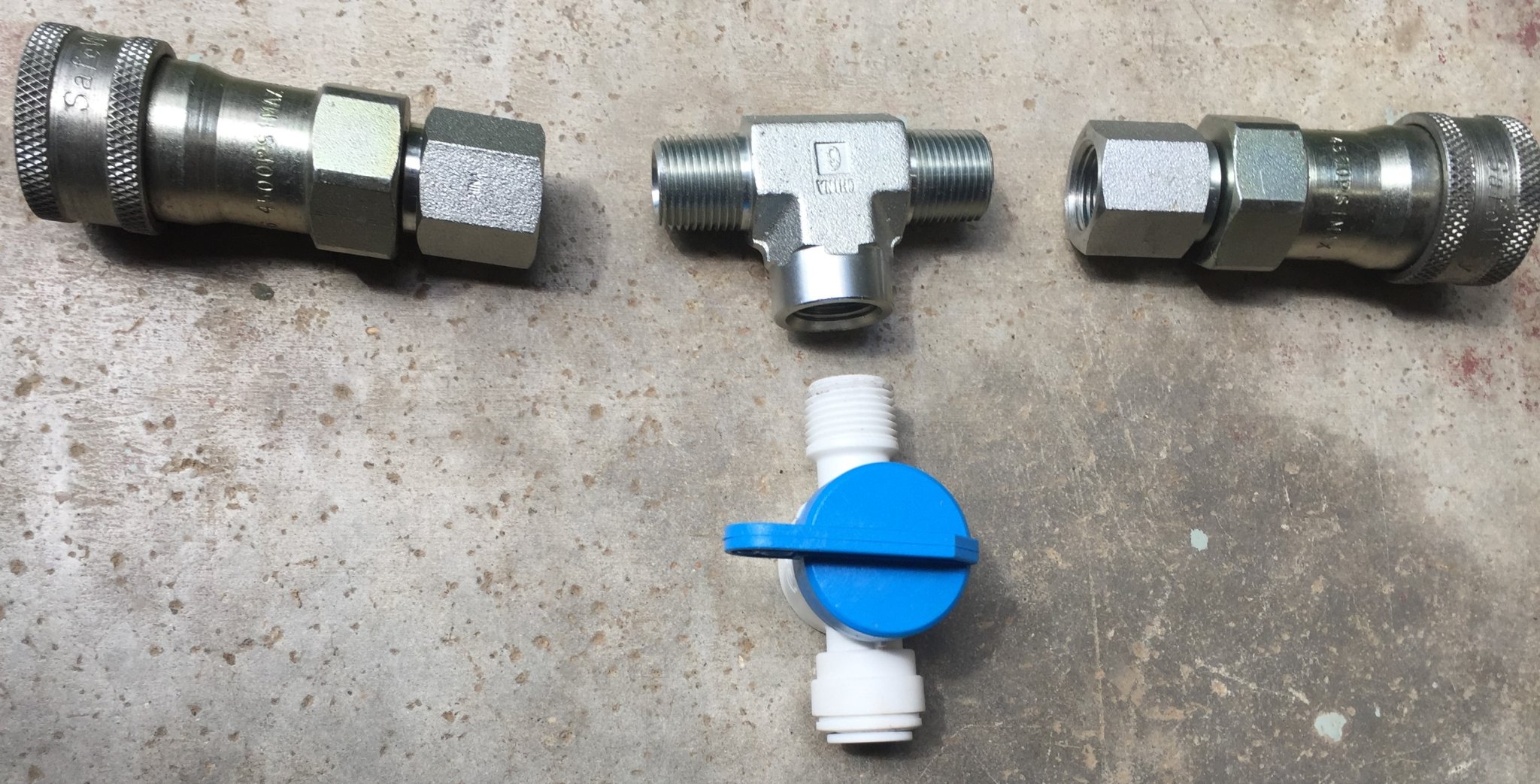

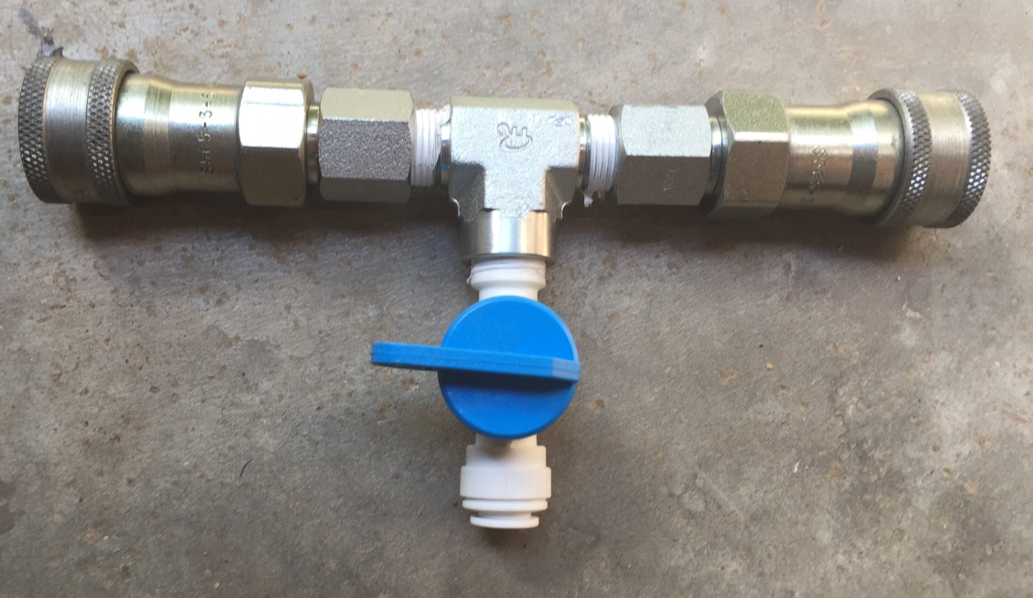

It's nice & hot which means the hoses on attachments are pressurized and tough to connect to the tractor. In other threads, it seems that if you connect the 2 hoses on the implement to each other when you take it off the tractor, the pressure is less or not a problem.
My attachments are plumbed with male fittings - female fittings on the tractor, so I was thinking of assembling some female-to-female fittings to connect the attachment hoses when not in use. After more thought, would it make more sense to connect 2 female fittings to a T pipe-nipple and add a valve to the 3rd leg to drain pressure?
Just trying to make life a little easier when switching attachments.

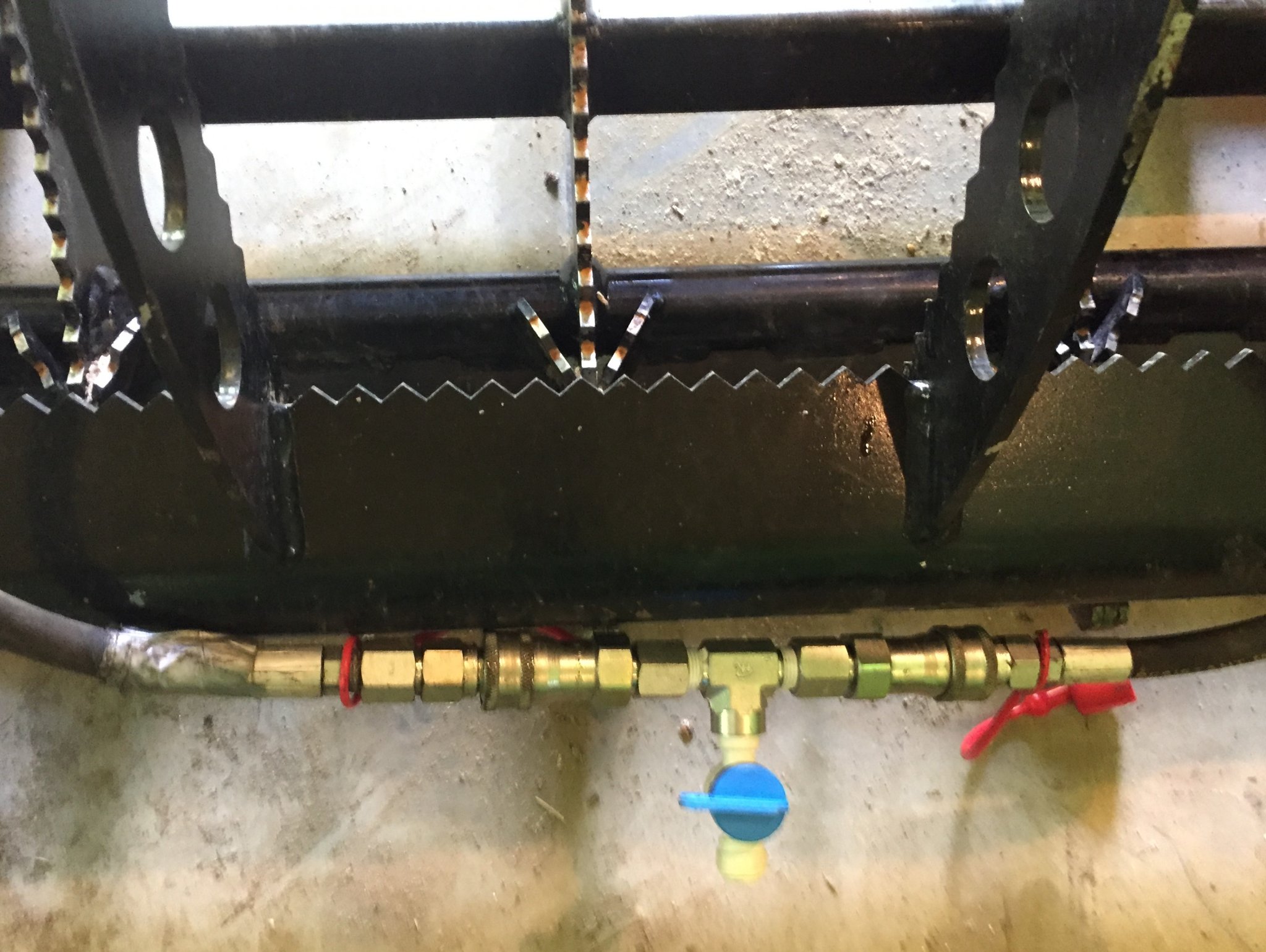

If you put a 3 way valve on one of the lines on your grapple you can crack it open to relieve the pressure prior to connecting the lines to your tractor. I also like to connect them together like Wolfman already mentioned pressure will still build up especially if the attachment is sitting out in the sun but the 3 way valve will take care of that problem. Here is a link to a good one. Click Here
This is what I did, but I put it on the tractor side, as that's where the pressure comes from. Then the grapple gets connected together...if I can muscle them together when I take the grapple off. :LOL:

The 3-way valves are expensive, I'm just going to buy two pressure relief kits, 1/4" for front & rear implements, 1/2" for the third function grapple (higher volume couplings).
