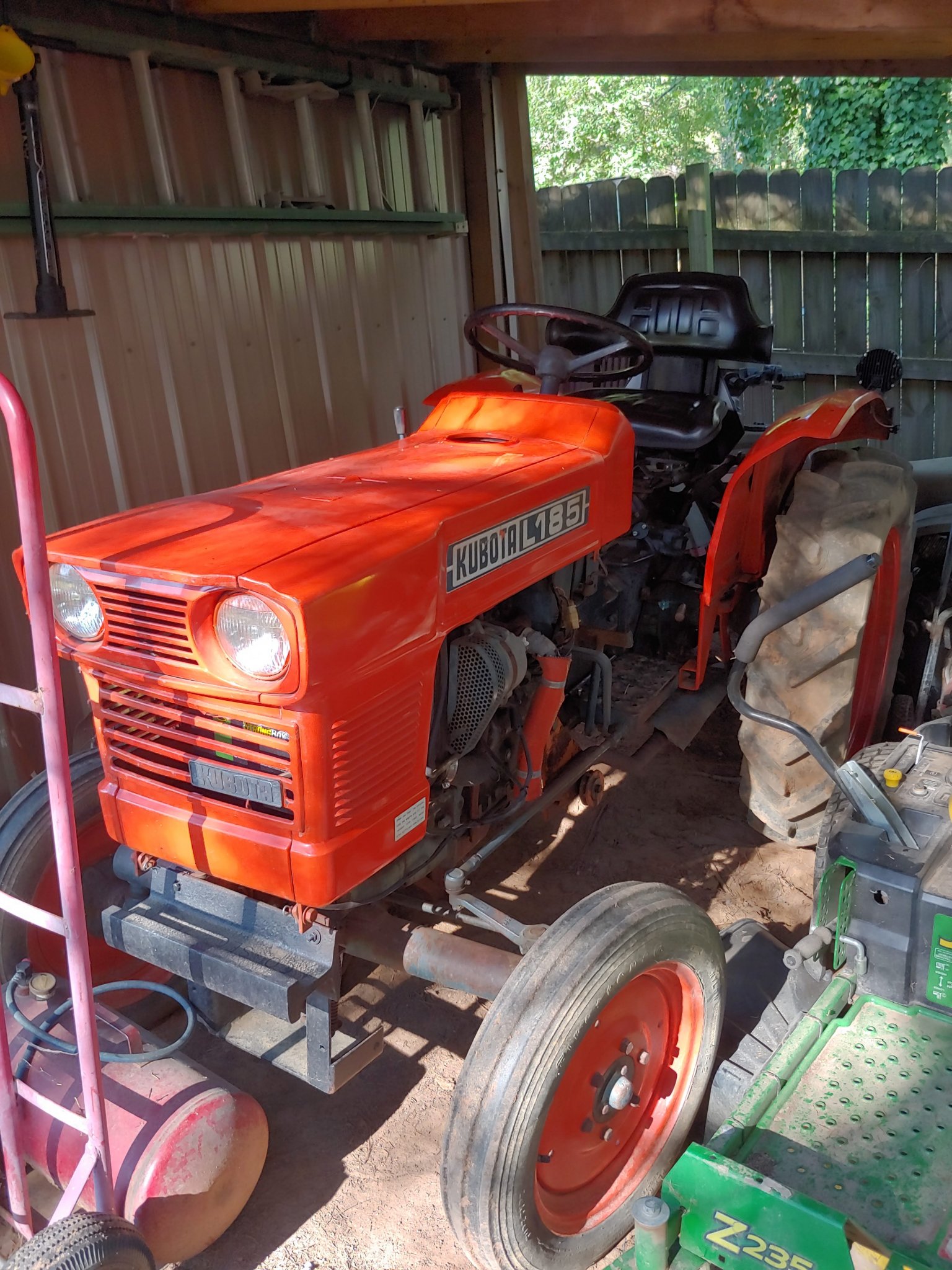

I just picked up a tractor today first one I have ever owned. I have driven all kinds of tractors and equipment but never owned one until today it is a
vintage Kubota a L185 with 669 hours. I wanted something small for around the yard and back land. I plan to use it for blading, mowing, skidding trees and light stuff. My question is what size finish mower, blade, box blade and bush hog would everyone recommend?

Welcome Dave,
as for attachments :
Back blade - get a 5' er , at an angle it will still cover your rear tracks.
as for 3 point mower - a 5' er there too - but with only 15 hp PTO - that 5' may be a little much in thick grass - you might have to go with a 4' er mower, depending on the type of grass and height of grass. Typical wisdom - 5 hp per foot of mower! But sometimes that can be stretched IF certain common sense is applied.
Box blade might be a 4' er - at 5 feet you will lose traction once the box fills with dig/gravel. Being only 2 wheel drive too, traction loss will come quickly once the load is applied.
Very nice looking machine for a 40 year old tractor!

I agree with the recommendations above.
For the brush hog limit it to 4 foot.
The problem will be weight on rear making the front very light. I noticed that your tractor has a rail bolted on front instead of the weight bracket that can carry four 55 pound weights. You may have to figure out how to attach more weight to the front to lift implements or use smaller and lighter implements.

Thanks for the replies everyone I appreciate it. Someone had removed the weight bracket and put a belly
mower bracket in place and the rail onto that. I seen a local salvage has a Kubota like this and maybe if
i'm lucky it will have the bracket I need to put the weights on. Guess I better get shopping for equipment
now that I know what to get. It seems to be a solid tractor it starts within 5 seconds or less and has all 4 of what looks like the original tires. Thanks

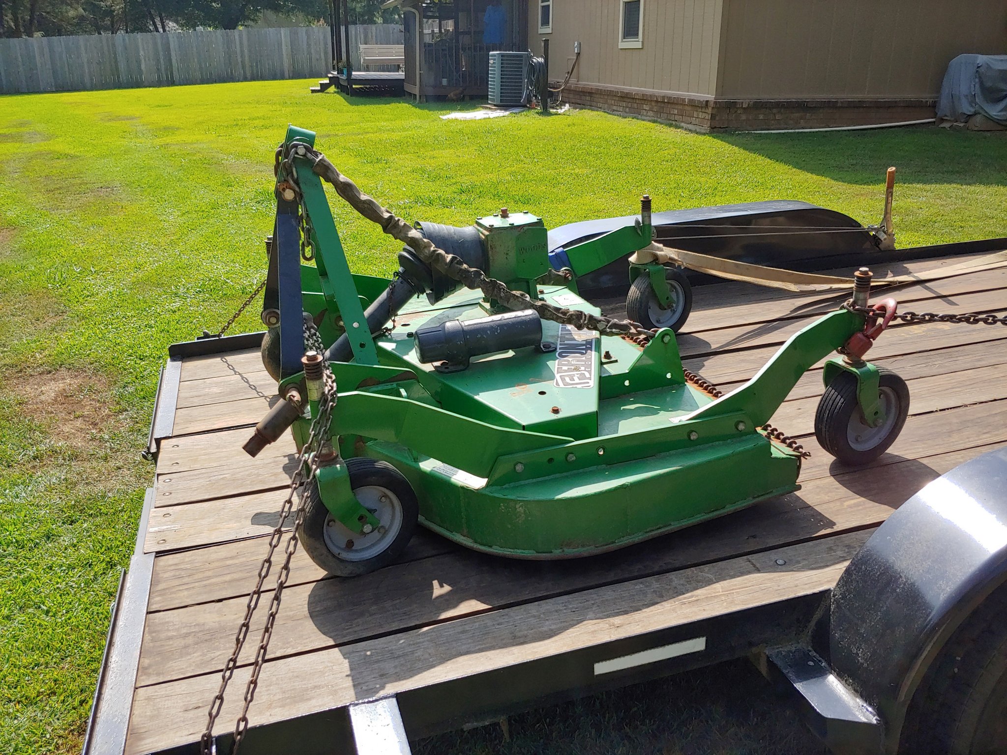

Well I have been shopping the local ads and calling around and I found a mower yesterday and bought it
today. It was the best one I found for the price and don't appear to be very old with no rust through and
most of the original paint. It is a Frontier by Woods GM1060R I seen another L185 on this forum was running the same mower. I also bought it because my grass is not very tall and eventually I might go to
a bigger tractor and I didn't want to have to find another mower. I figured this one would work for
most all tractors and places I needed to mow. Now I'm just having problems finding 1 bottom breaking
plows local. They are all 2,3 and larger. Found one so far about 90 miles away and at a dealer so top dollar
and I think I can find one cheaper but some dealers have deals like the mower I bought today was cheaper and nicer than anything online I found for sale.

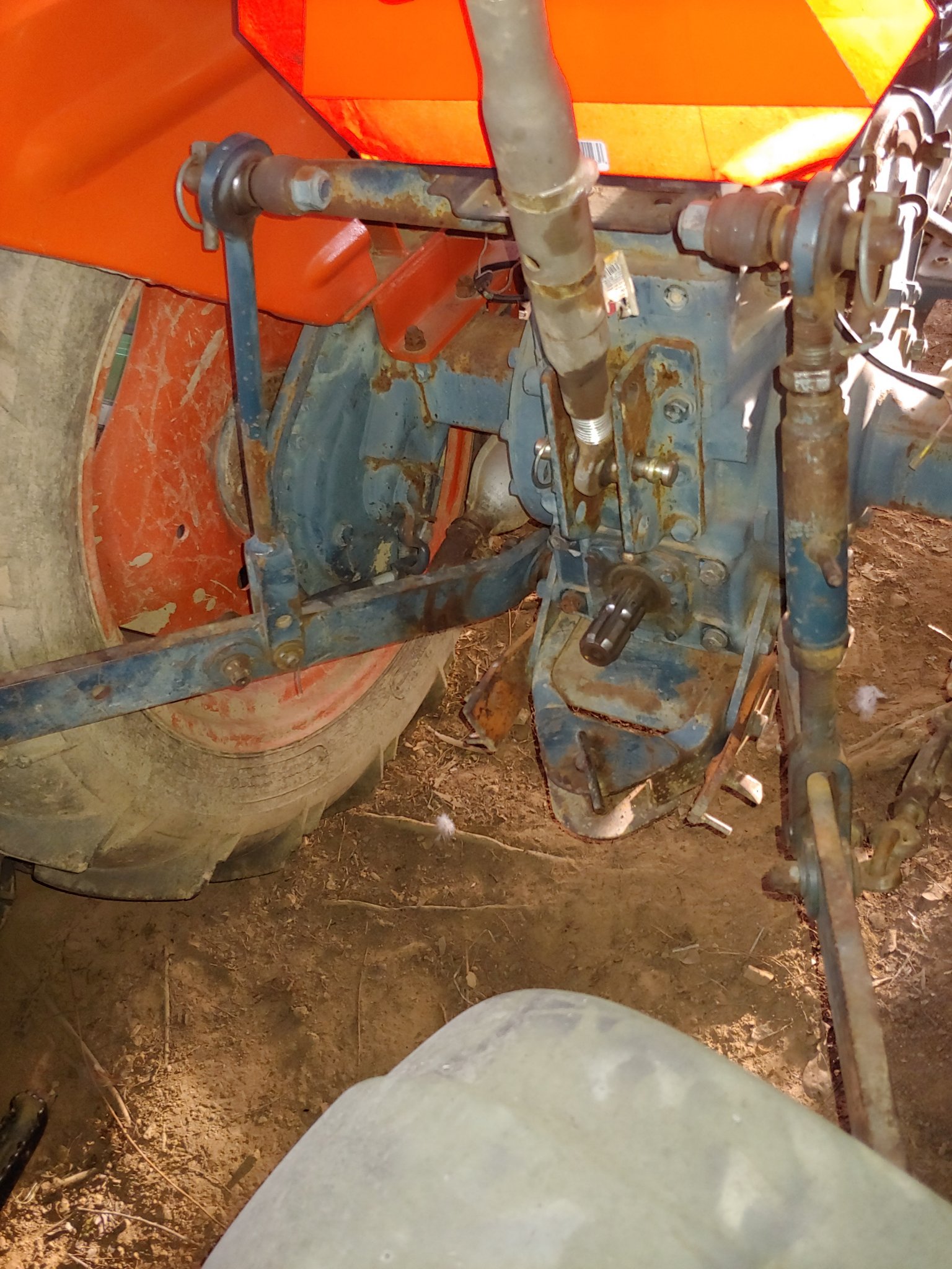

I hooked up the mower today after unloading it off my trailer that thing was heavy! Anyway the problem
I ran into is it lifted it fine once hooked up and fit good but when I turn my 3 point arms are swinging over
and getting into the tire is that an adjustment issue? if so what do I adjust or where am I needing to look
at? I have never had that issue on other tractors. The arm just swings over into the tire like the weight is
shifting it.

You should have turnbuckles to tighten the lower links. Do you have a picture of the back?
I seen those and thought they might be where I needed to check I will get one they were outside the
arms up by the axle. I'll go get a picture.
thanks
Dave
thanks
Dave
I think I see now how it works I couldn't figure earlier how tightening it would help but it controls
the swing to the other side and the other side controls swing the opposite right?

Right, each turnbuckles keeps the lower link from moving the opposite way. The mower pretty much locks the lower links in and can’t go wider or more narrow, so you only need to prevent the side to side with the turnbuckles.

Sometimes they can get pretty rusted...if they don't turn easily put some leverage in the middle and try it...penetrating oil might also help. good luck!
