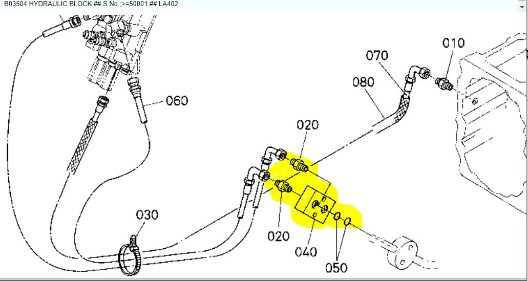

I just bought an LA402 and am getting ready to start work on attaching it to my B2710. This is my first tractor and after looking at messicks parts diagram I'm having a hard time visualizing where the hydraulics from the valve attach to the tractor. Is there just a port on the tractor that I take a cap off and attach the hydraulic line to? If anyone has any pictures of this attachment area on the tractor I would love to see it! Thanks in advance!

Did the block in the picture come with the loader?
If not you'll need to get it and the O-rings and fittings.
You will also need the fitting #010 too if you don't have that.

Important Note...
When installing the return line 080/070 onto fitting 010 you will be in for a wet surprise if you have the hydraulic fluid all the way up on the transmission. Drain some off - not much, a couple of quarts, to ensure the fluid level is plug that's in the side of the transmission where fitting 010 is installed.
Also, note the hydraulic block 040 needs a clean surface to mate against. Buy some extra 050 washers while you are at it - first time around for me I managed to get a defective one with my new hydraulic block. Didn't notice it until it was installed and weeping oil. Turns out it had a very slight flat spot in it and wasn't taking compression between the block and the transmission housing. Lesson learned ... this big dummy has to install his GLASSES and INSPECT the parts before he tries to install them! :oops::ROFLMAO:
