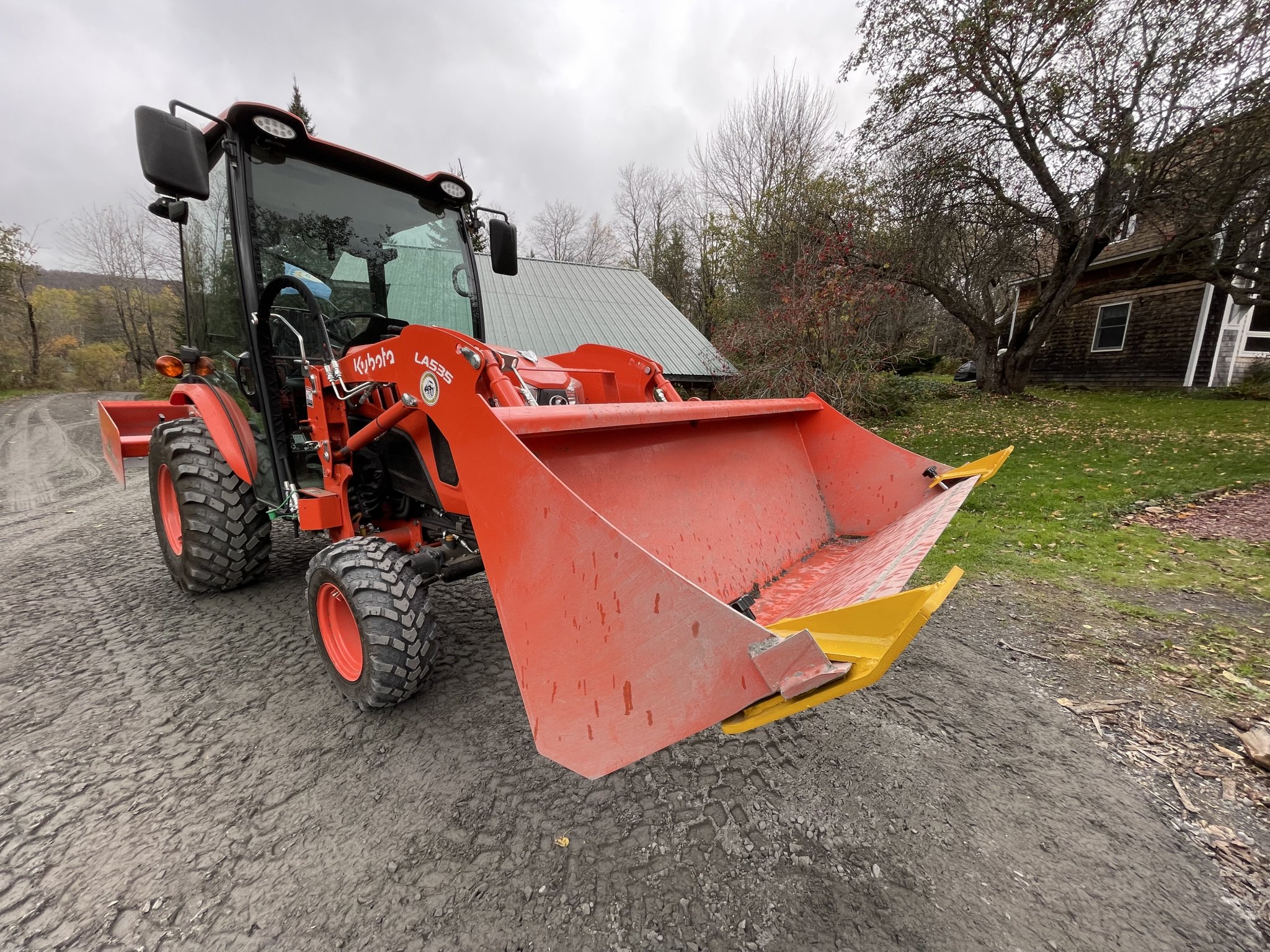

Edge tamers installed, I ended up deciding to drill the bucket as these knock off ones had a small indent for the bolts in the bottom. So I grabbed some spacers, the cordless drill, and here we are. Did a little trimming to get the fit just right.
View attachment 68073 View attachment 68074 View attachment 68075
Wow!! I need those for the wheel loader at the mine. Every time I come home for my week off my cross shift starts all kinds of new "open pit mines" I have to fix when I get back, LOL

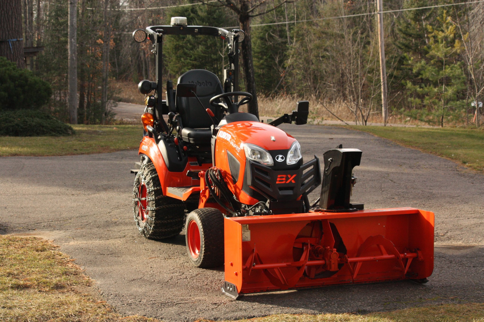

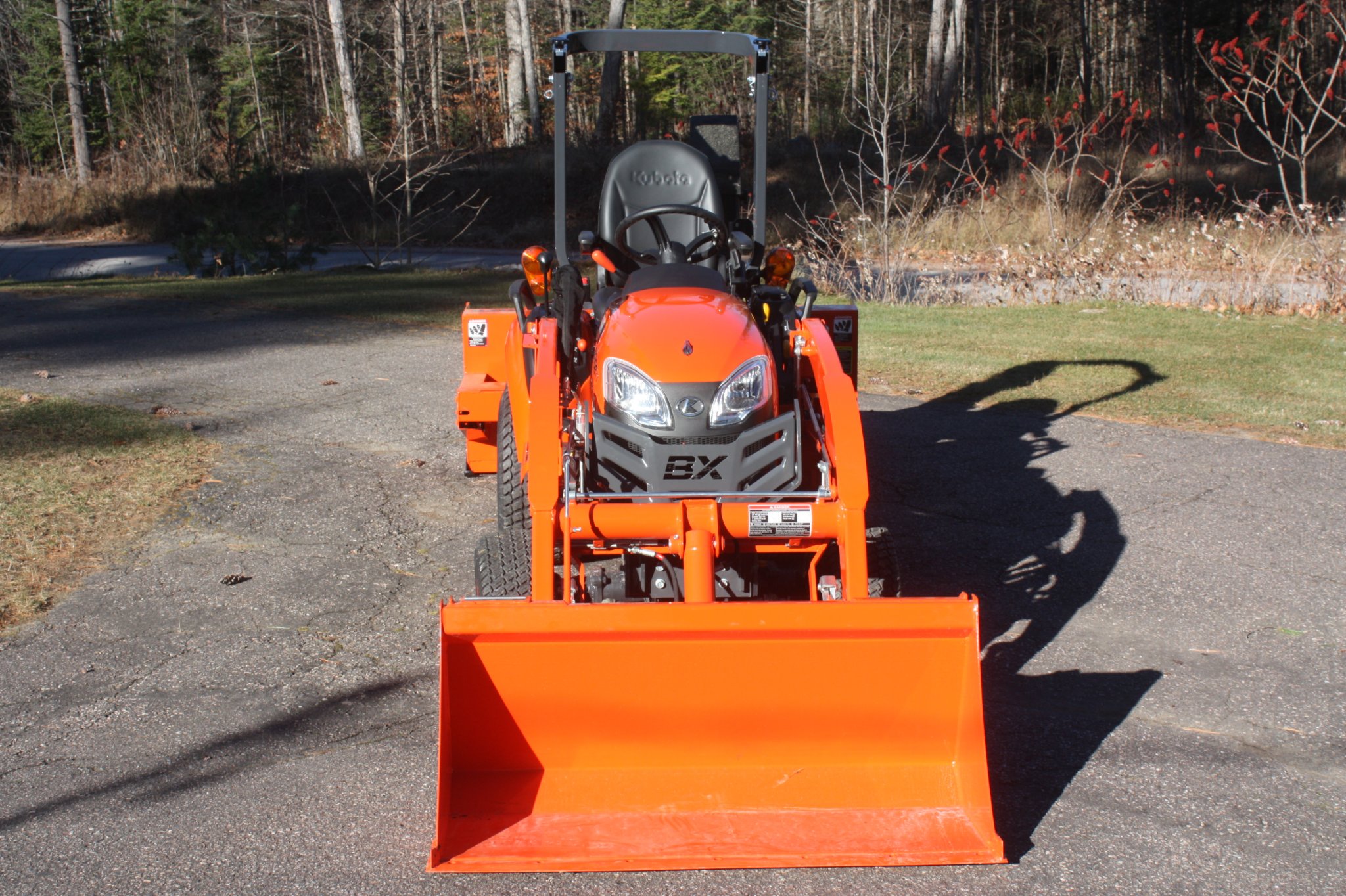

Well, I thought I was ready, until I just realized looking at the pics that I put the rear rims on my B on the wrong sides. So the direction of the tread is backwards.
No wait.....it snow blows backwards, so I meant to do that! LOL
Guess I'll be pulling those wheels off again. I keep that set of R4's just for winter and use the ones that have some wear in the summer. I don't have any issues with R4's in the winter as long as the treads still have a nice square edge.

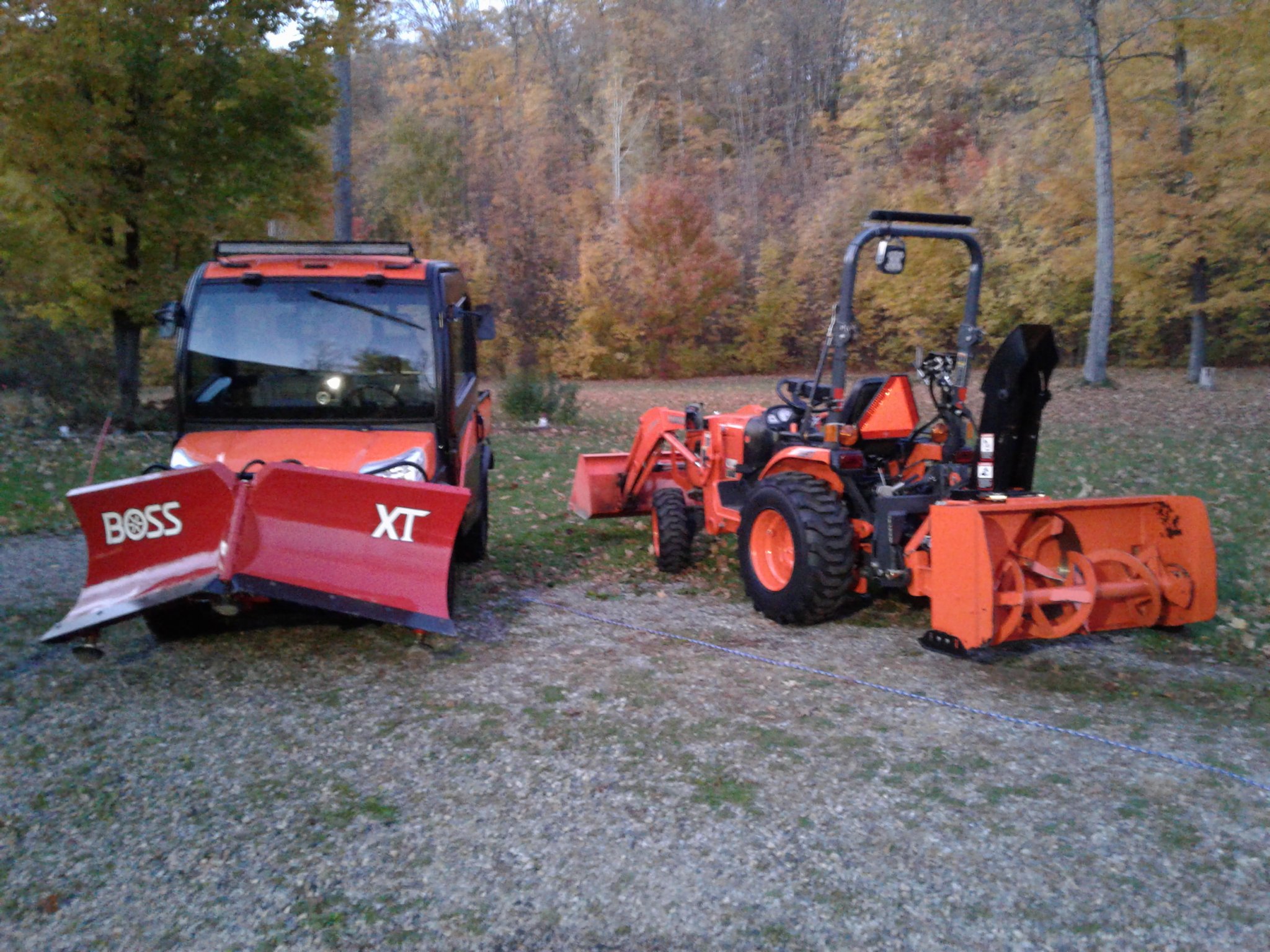

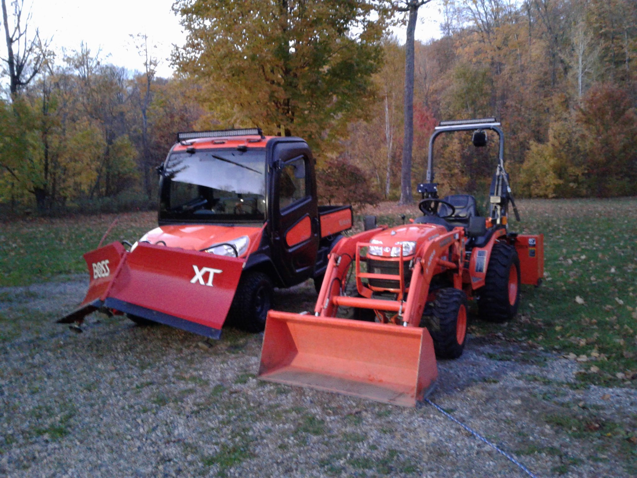

Nice equipment set-up you have there!
I agree!
Almost makes me wish we got enough snow to need those.... almost.
