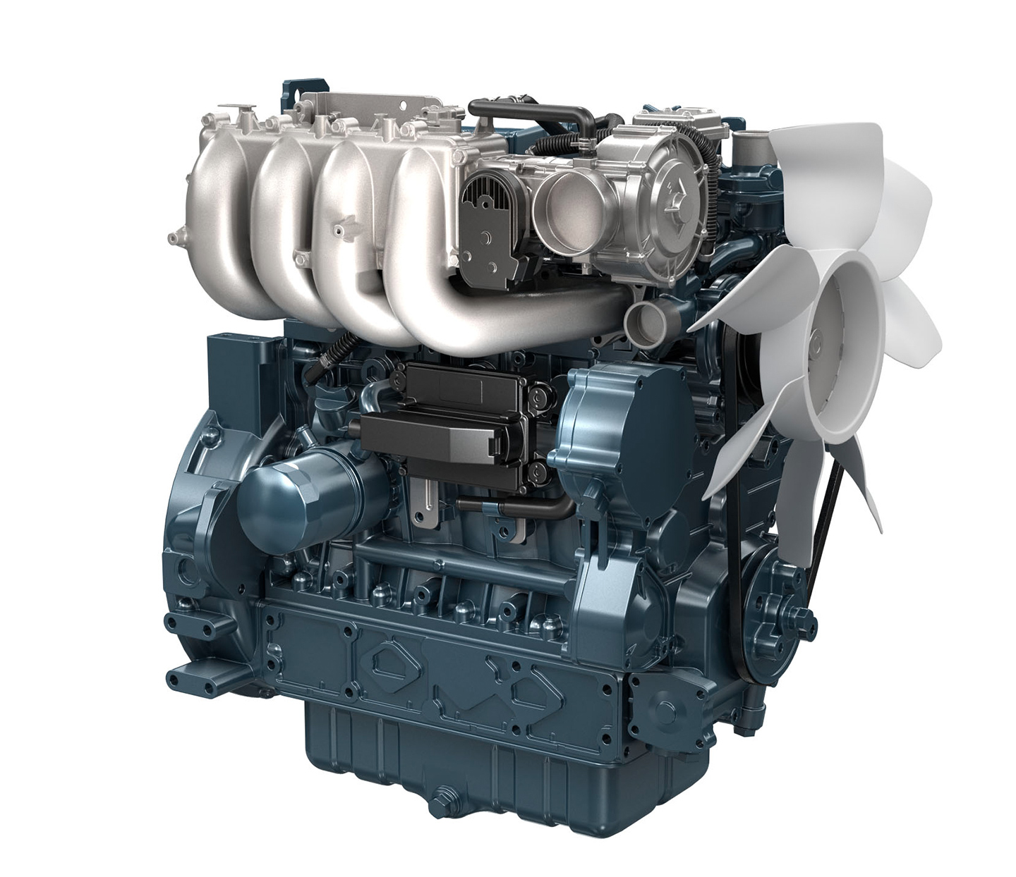

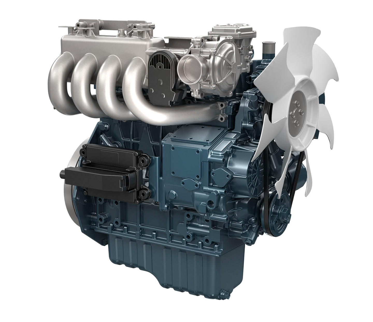

Kubota makes many many commercial gas engines. Here is a pic of their 75hp gas engine one of our guys considering for his log processor. Yanmar also has many gas options.
