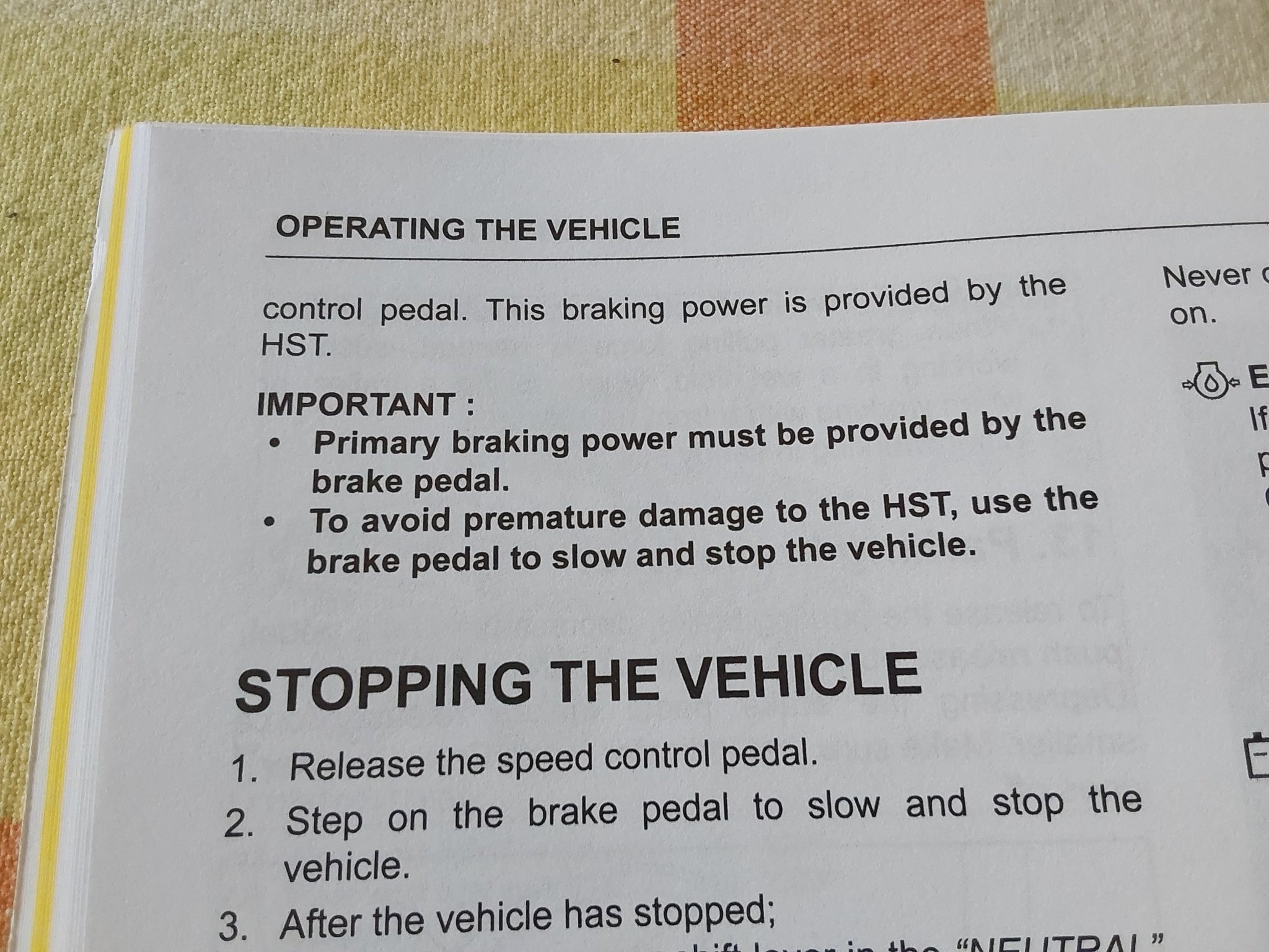

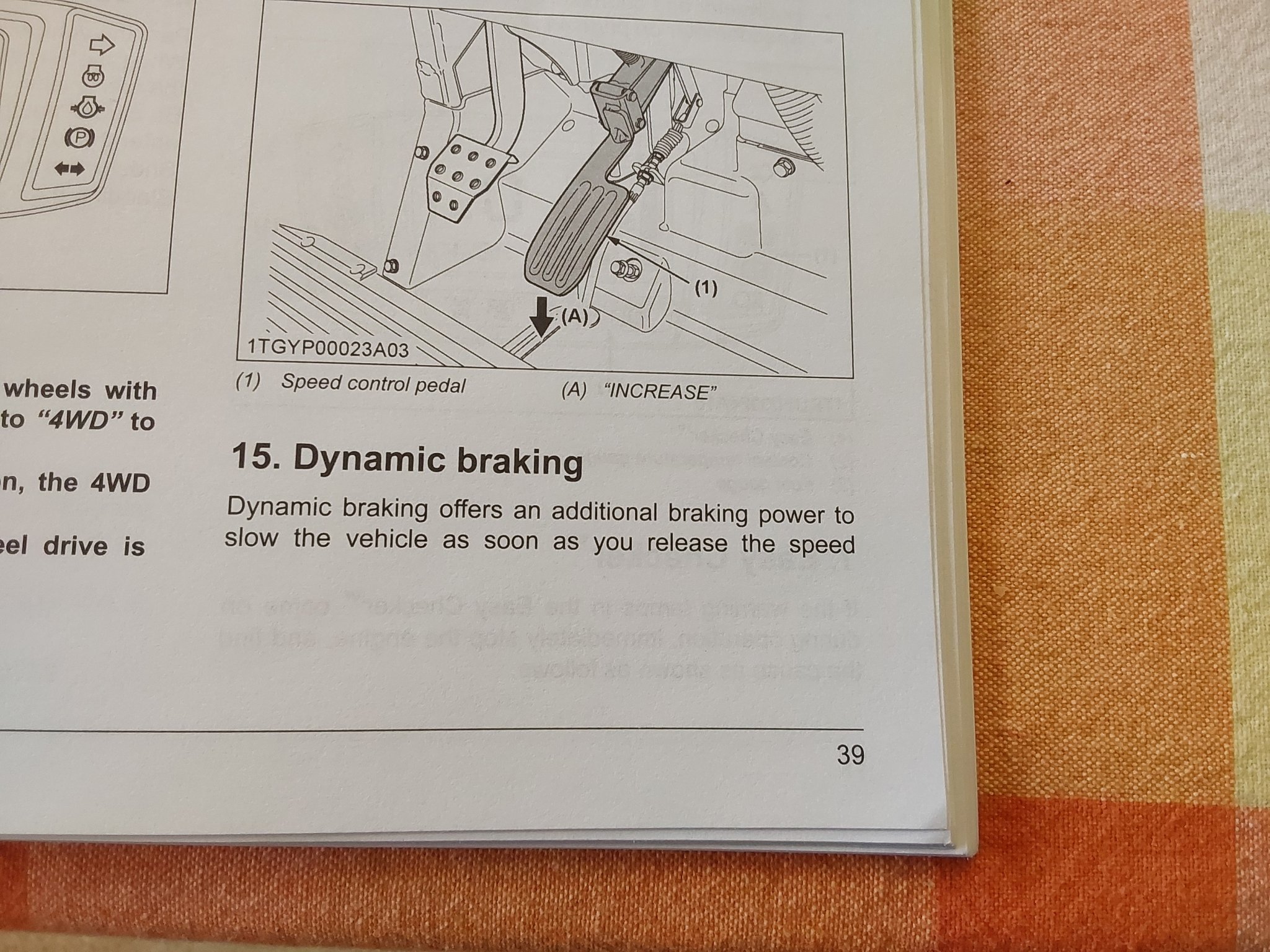

Everyone seems to be cutting their hydro life short by not following the manual :unsure: . Here's a shot of mine that says use brakes for to avoid damage to the hydro when slowing. It's actually hard to do and takes 2 feet on the pedals on mine. Let off the accelerator pedal too fast and it will put me through the windshield which the previous page calls it dynamic breaking from the hydro. So which one is it.

Sounds like the HST on these RTV's are way under-designed or my HST tractor will be toast soon - I never use the brakes.
Maybe that's why the tow ratings on the diesels are lower than the CVT units.

That really surprised me when I first got it and read the manual. I have tortured my BX hydro for 800 hours slowing, stopping, and reversing. I figured this rtv would work the same way but it doesn't. The pedal on my BX will get harder to push as load increase but it keeps on pulling. The RTV going up a big hill will slow down if you keep pushing the accelerator. You have to let off the accelerator as load increases to keep a constant speed. Whole different animal that makes it feel gutless compared to my BX.

Well I'll let you know when mine dies because I never use the brakes. Never used the brakes on my 2013 B2620 either.
I don't see how you could use the brakes? The hydro stops them so fast you would literally have to lock up the wheels with the foot brake, LOL

I think that would apply more to descending hills loaded or while towing.
