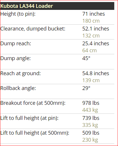

I have a BX2680 with quick attach
the spec lifting capacity is 683 lbs
The lightest Quick attach pallet forks are around 250 pounds
so the effective lifting capacity is around 300 pounds
So with this limited lift capacity is this really worth it?
