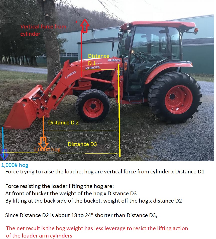

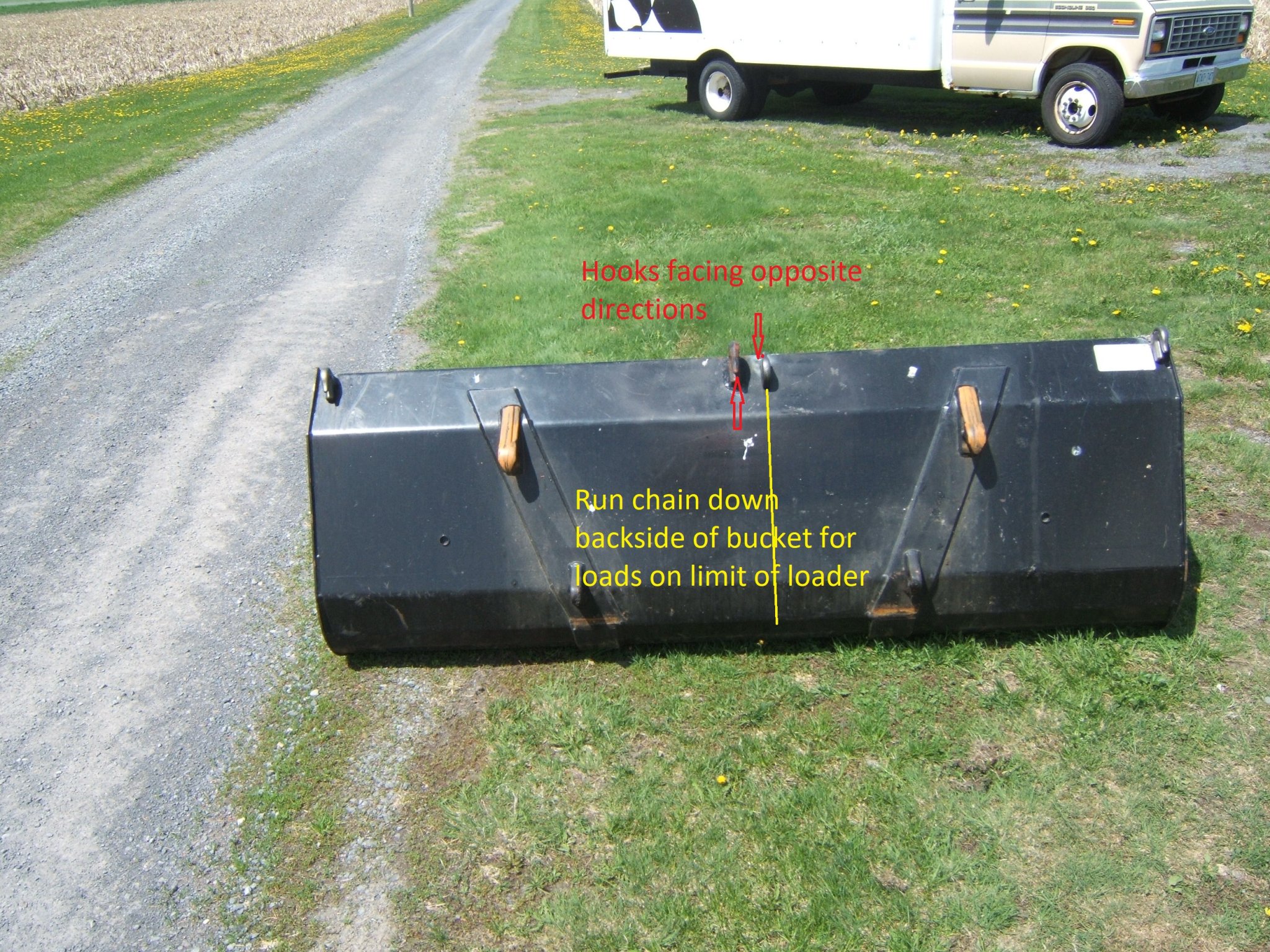

Putting aside brand of hooks, I have mounted two hooks in the center of the bucket with one reversed compared to normal one.
If I am trying to lift something that is on or over the limit using a chain running over the cutting edge of my bucket, I run the chain down the backside of the bucket. This moves the lifting point IN and increases the load I can lift by a substantial amount.
Dave
Nice idea....I'm stealing it, and ordering more Kens hooks as we speak (y)
