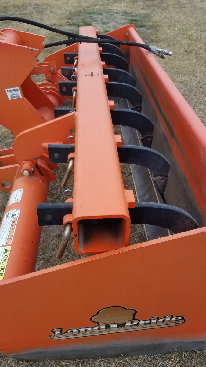

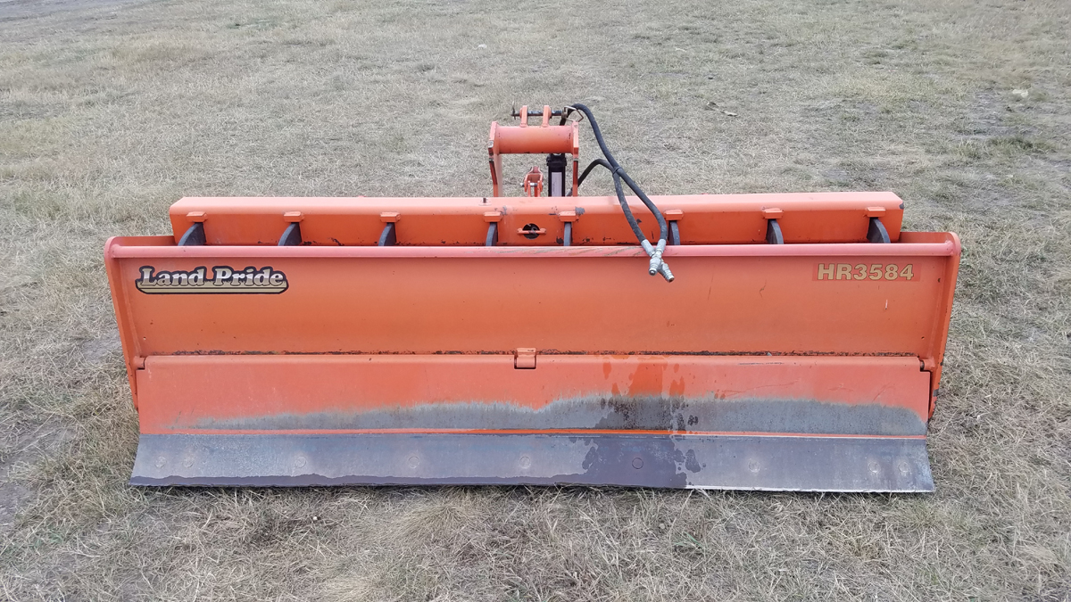

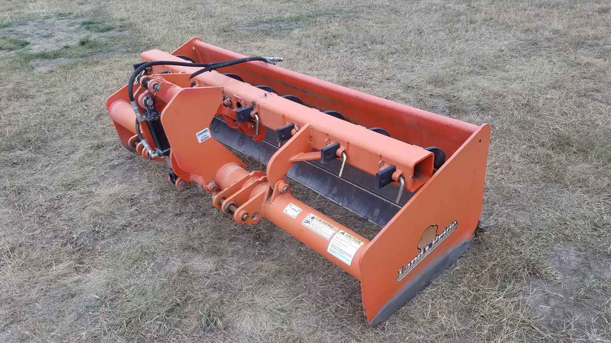

The widest and most commercial use box blade that Land Pride offers with hydrualic scarifiers is the HR3584 which is only 7ft wide. I run a 7ft EA box blade and 7ft EA land leveler behind either tractor and they work well, but if you're set on an 8ft model with factory hydraulic scarifiers you'll have to look elsewhere. There was a used Land Pride box blade at the local Kubota dealer a couple of years ago with hydraulics and it was probably the HR3584, but it was too expensive at the time so I passed on it.

I found the photos that I took in October of '21 of the Land Pride HR3584 that was for sale at the local Kubota dealer. It was tempting for sure.
