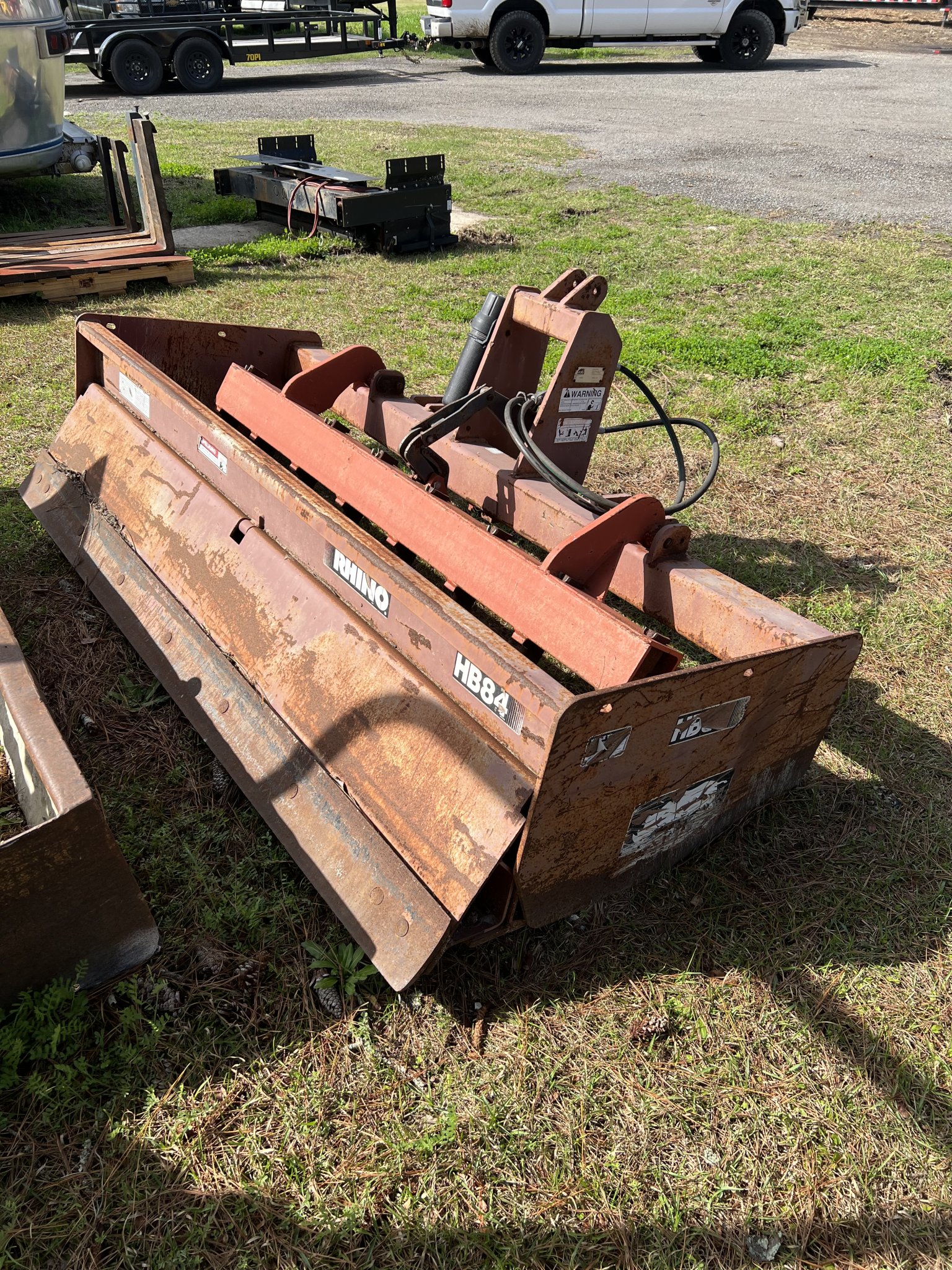

Landpride, and Woods/Gannon make heavy duty ones.
I recently purchased a used Rhino 7’ not sure if they still make new ones.
Most larger ones 8’ and larger that I’ve seen have been a pull type with lift wheels. If your not wanting a 3pt type.
Edit to add photo.

Looks like a VERY nice box blade. I would not mind finding something like it! Any sources you may share? Thanks much.

I bought it used a few weeks ago. And made a 8 hour round trip to pick it up. Facebook marketplace, Craigslist. And sometimes dealerships, I found a like new hydraulic rear blade a few weeks ago also at a semi local Kubota dealer for less than half a new one was.

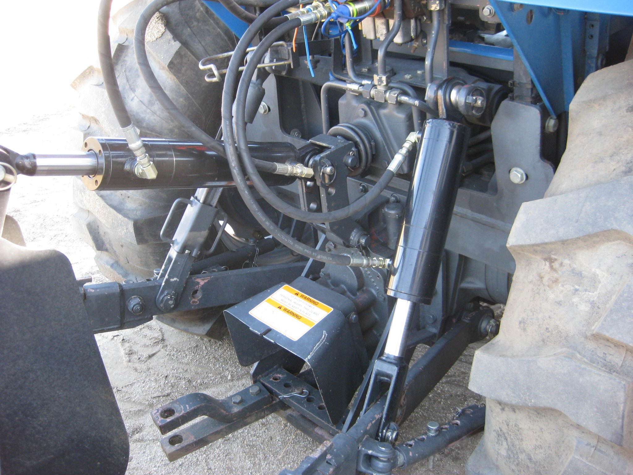

You might want to consider a top & tilt set also if you are going to be doing a lot of grading.

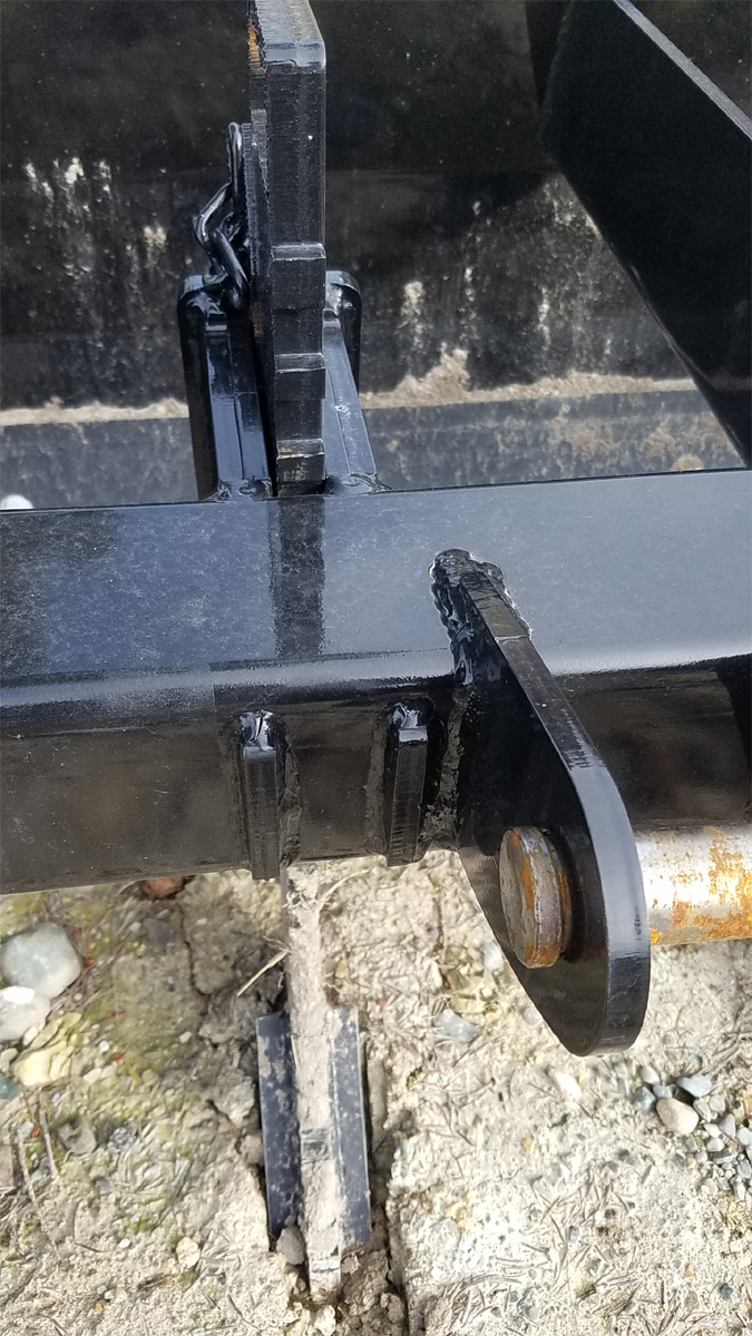

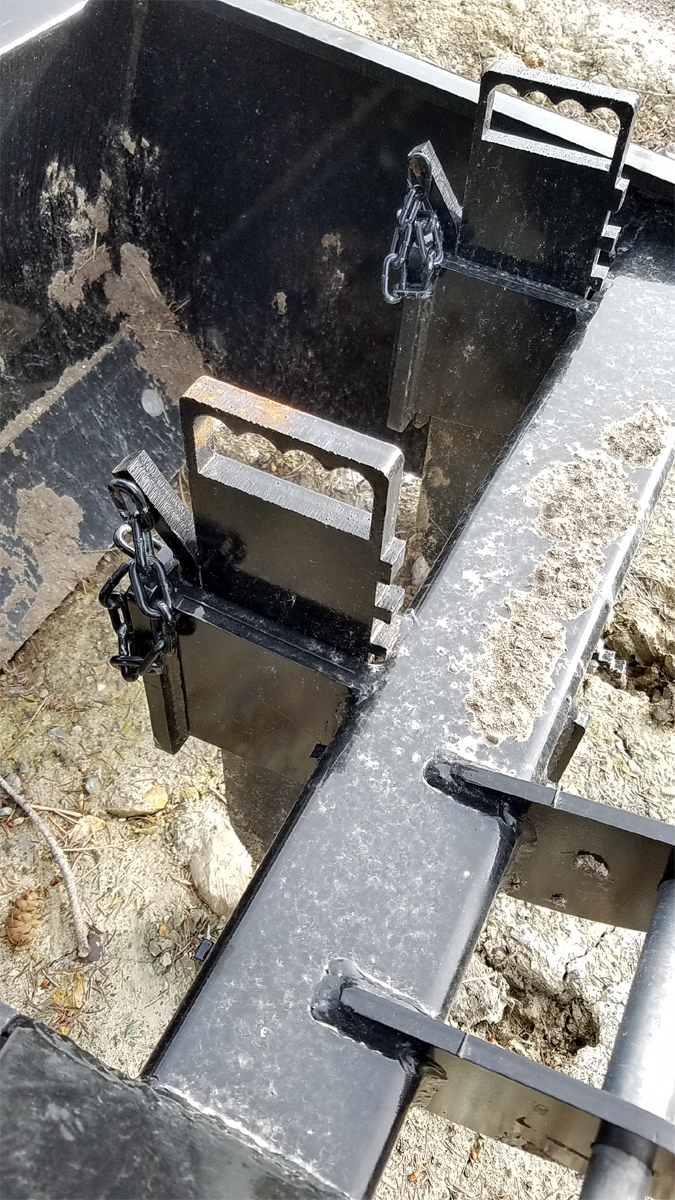

I have a 7ft EA box blade and there's no doubt that hydraulic scarifiers would be a nice feature, but I think that feature could be added via modification if you're even a remotely decent welder. One of the things I've always liked about the EA box blade and land leveler (land plane) is that the scarifiers are located behind the main cross member rather than passing through it as is common with many designs. The EA design is much better suited to severe use and might also be easier to modify if an hydraulic option is required.
