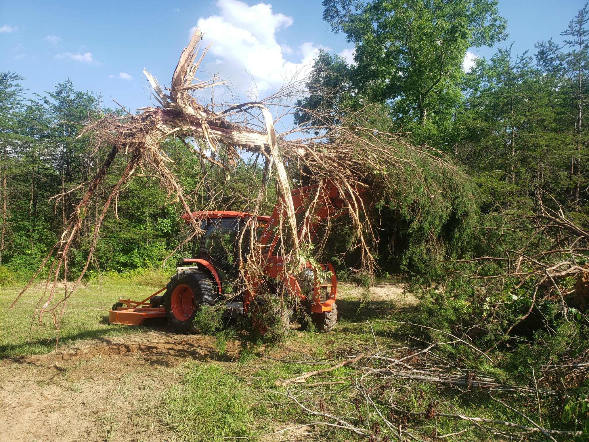

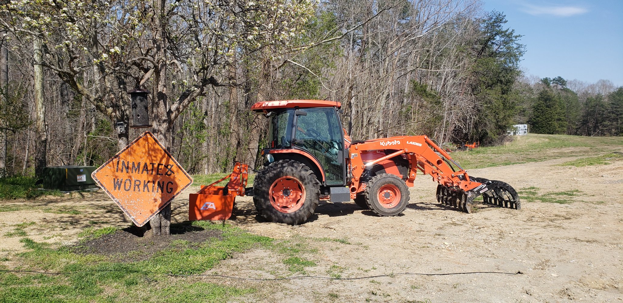

I’ve got an L6060, I have the Kubota 4-1 bucket, but borrowed a friends Virnig heavy duty rock grapple for a brush cleanup project. It weighed over 700 lbs, and was too heavy in my opinion. I recently ordered an EA 60” wicked root rake grapple, my friend is waiting to see it, but will likely get rid of the Virnig and get the EA as well For his 6060.
IMHO the EA Wicked 60 is the way to go with a 60 HP Tractor.

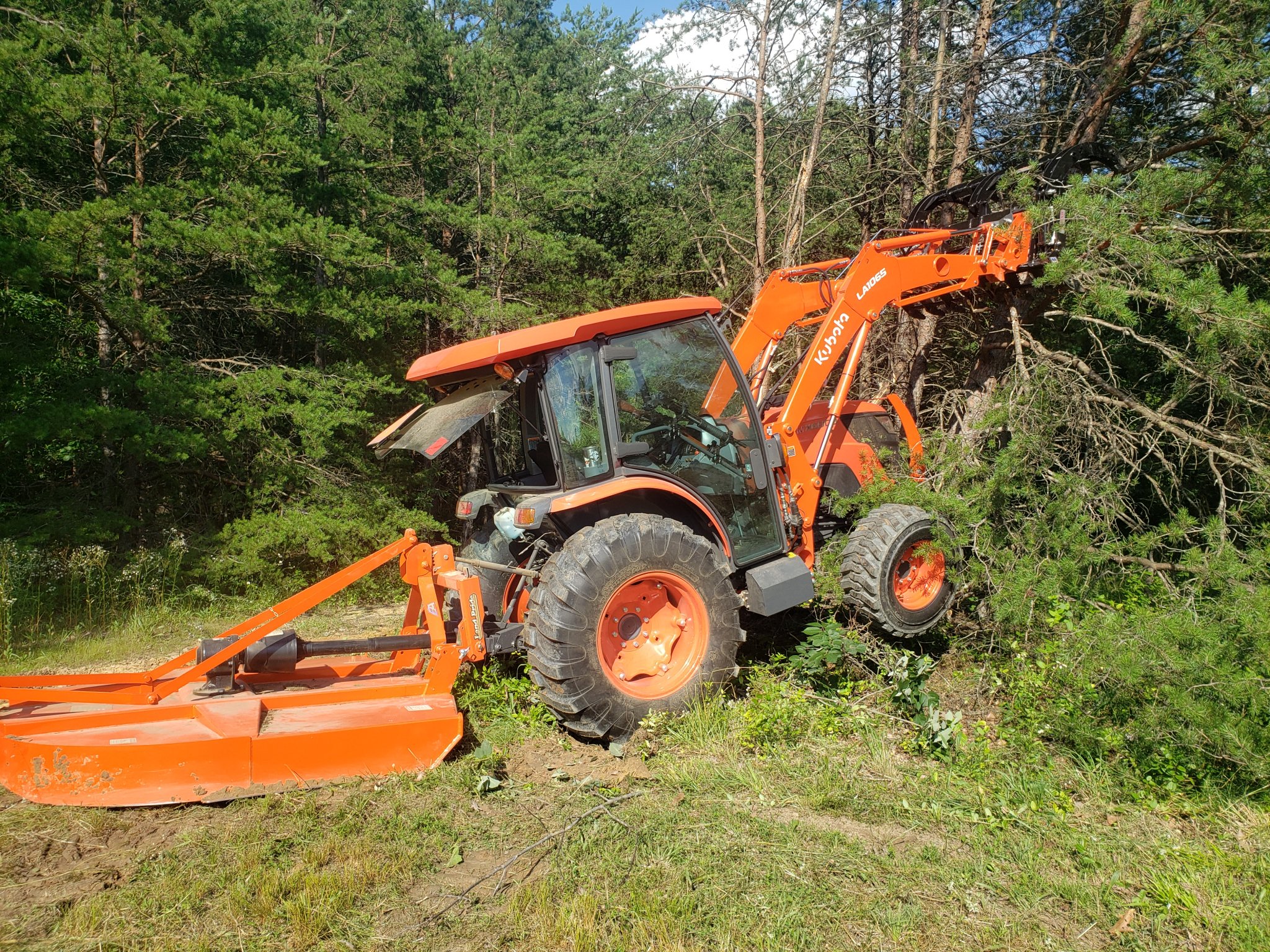

I, too, have an L6060 (ROPS) with 4-in-1 bucket. In my opinion, the 4-in-1 bucket alone is too heavy without counterweight. I repair/change my own tires so never use liquid ballast but do have the maximum of 3 weights on each rear wheel. Still, the combination is dangerous on slopes even with an empty bucket.

As MoCo learned...you can easily get too much grapple for a tractor (he has the model I have for my M62). Just because you can lift it doesn't mean it is well balanced for the machine. I have my rears filled. With the backhoe off if I am carrying a heavy rock it is still a bit front heavy.
I also recommend something around the 450-600 lb range for your machine. Remember weight doesn't necessarily mean stronger. EA is a good balance of both but you have to wait months AND pay in full up front. No thanks.
