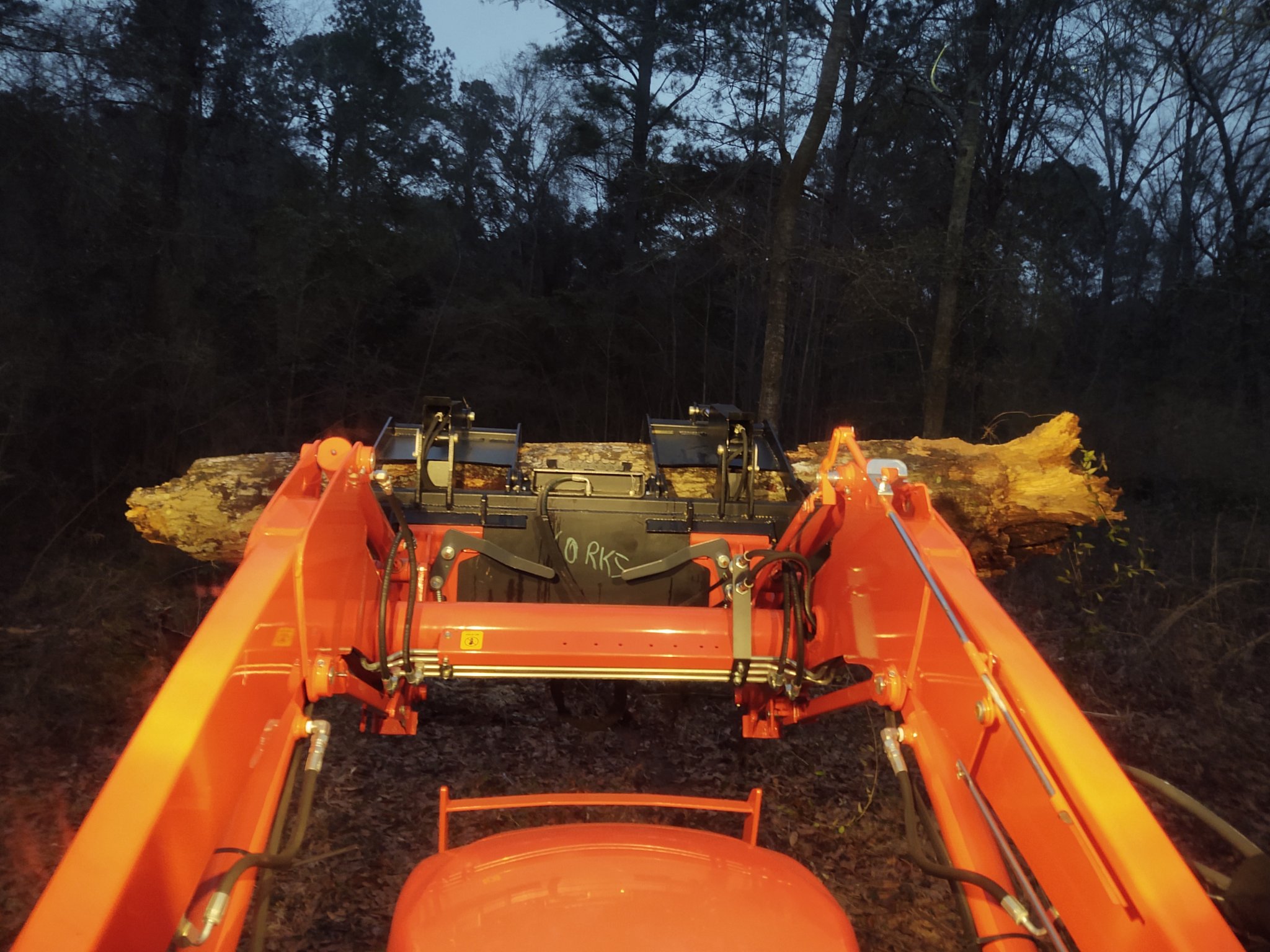

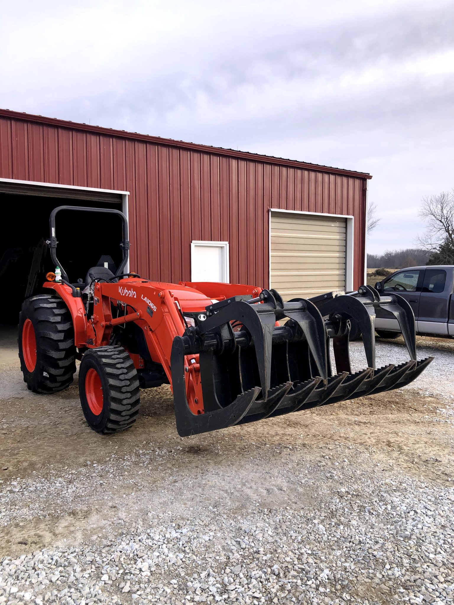

I have the EA 55" Wicked Root Grapple. If you are worried about damaging the lighter weight grapples from EA, you will not. I have moved concrete, trees, implements, anything I wanted. The lighter grapple allows more lifting capability towards the load. As it was noted, you will want some good counterweight because you will end up lifting your butt off the ground.

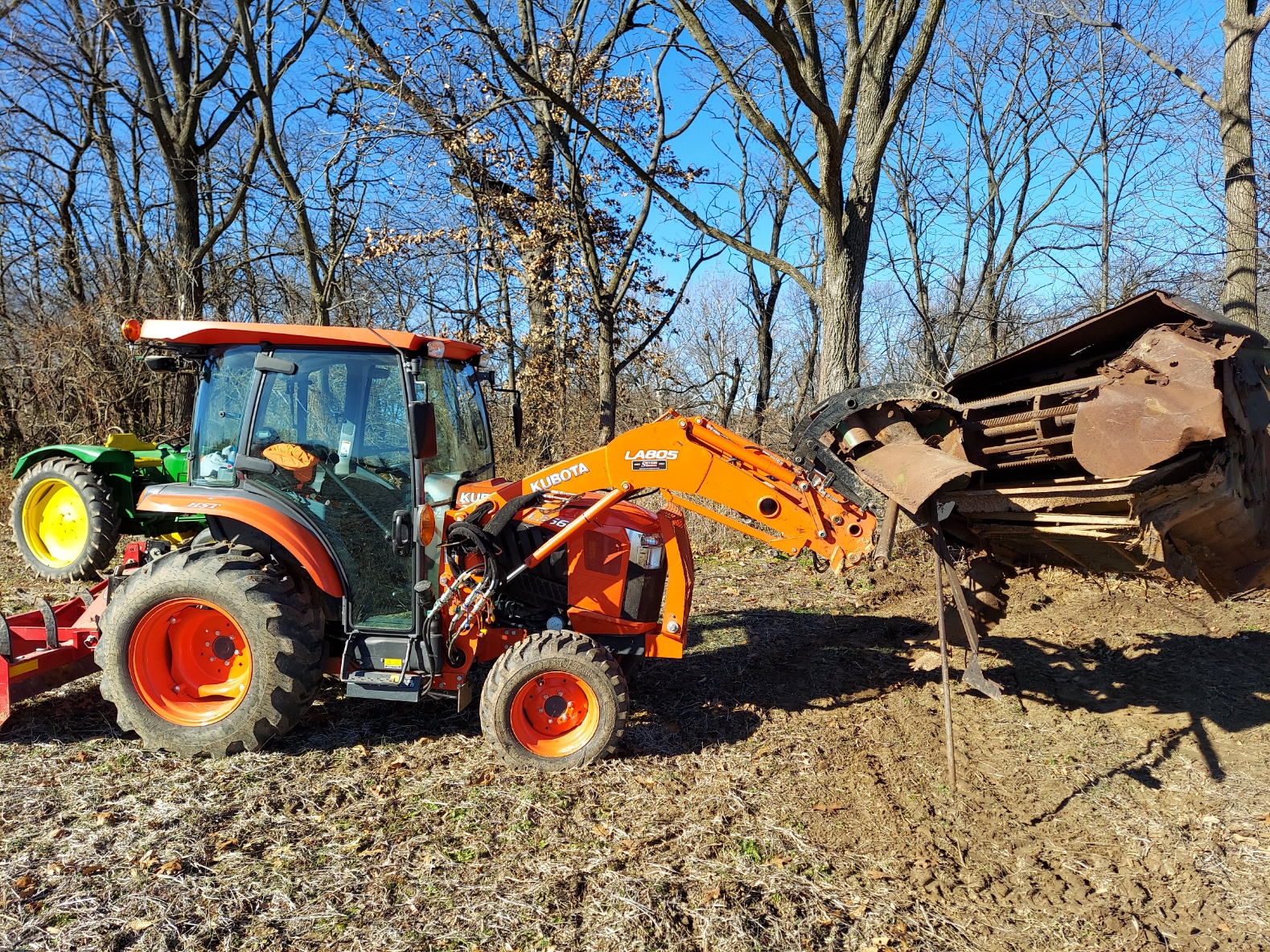

I would definitely go with a lighter grapple. I just sold my 66” Bobcat root grapple that I had for my T650 CTL. I thought I could continue to use it on my new MX5400. The tractor hydraulics handled it fine but it was just to heavy at almost 900lbs. After just a couple uses, I promptly sold it and ordered a comparable Root Grapple from EA. It weights around 450lbs. Much more compatable to my tractor. A long lead time but I know it will be worth it. I simply didn’t do the math when I sold my CTL and bought my tractor. The MX5400 is an awesome tractor and I’m very pleased with its capabilitie. I just needed to be more aware of it’s attachment compatability. The pictures are of the 900lb beast I sold

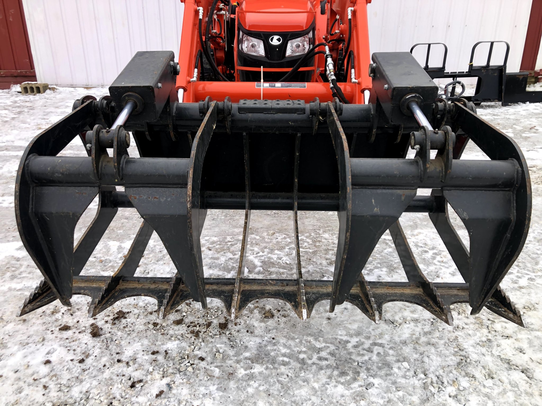

Take a look at MTL Attachments, they have a large range of affordable grapples. Everything Attachments Wicked model is nice but is expensive. You can comfortably run a 400lb model. Also consider which design of grapple you are looking for and how you plan to use it.

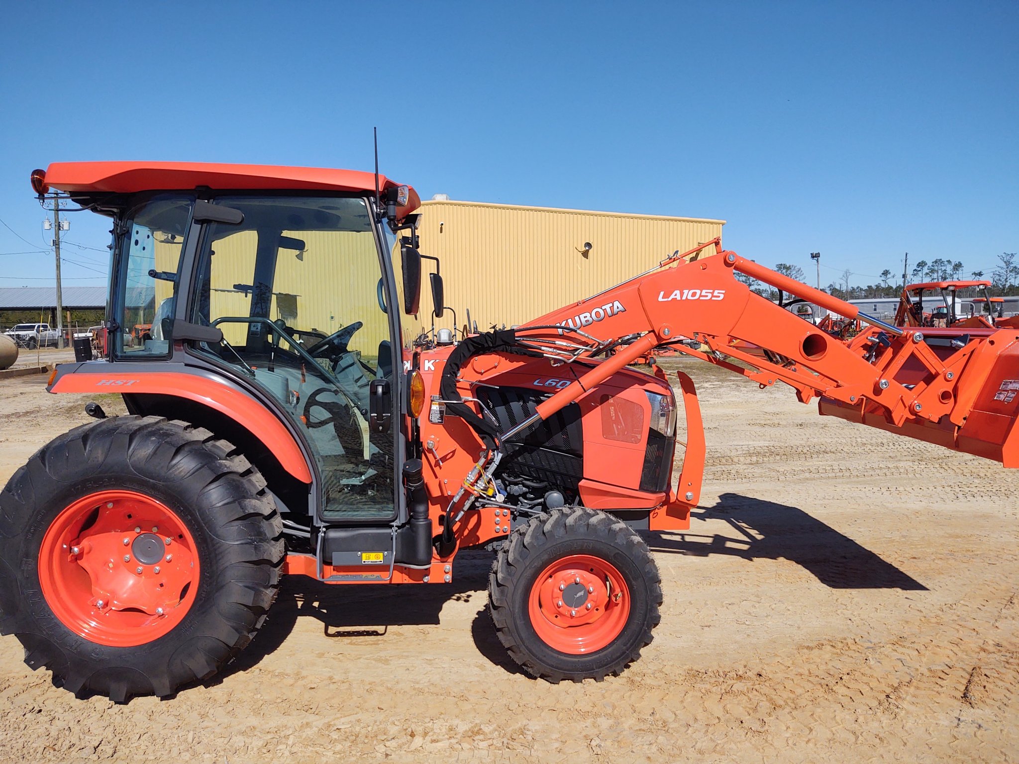

LA 1055 is my loader model, thank you to everyone for your input.

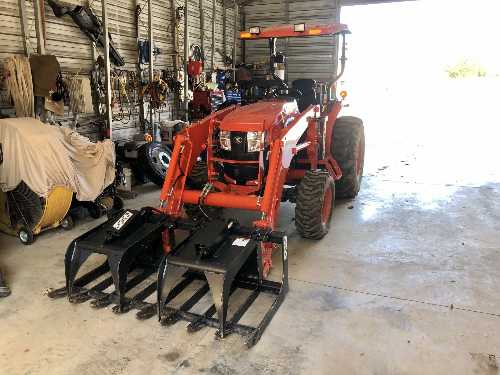

I want to thank everyone for sharing there views, I like many products available for the Kubota Grand L. I really like the grapples offered by Everything Attachments, however the 11 weeks lead time was to long for me. I decided on a MTL 60 inch RK5. They had one available, my nephew lives about an hour away from there plant and he was kind enough to go over, pick it up and bring it 3 hours drive to me. The Kubota dealer was kind enough to hook it up to my new tractor and so far I am very pleased with it. I have a lot to learn, but I am having fun.

I'm glad you made a selection, the MTL grapple you have purchased is about 600lbs how does it feel on the front of your FEL LA1055 ? Are you happy with the grapple build, MTL make many models and are very reasonable. I'm sure prices will go up as the cost of steel is rising.

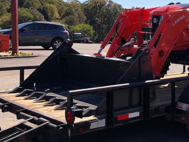

When I purchased my 4760 with 1055 loader, I ordered a 4 in 1 bucket with the tractor. I also have my rear tires loaded. Based on horsepower rating my dealer recommended a standard duty skid steer 4 in 1 that with teeth that weighs 670 lbs. The implement MFG agreed with the dealers recommendation. That bucket is a beast and you really feel the weight even empty. The tractor rocks and sways and really rides rough. When picking up a load of mulch it easily lifted the rear tractor tires. I had to purchase the Kubota ballast box and fill the box with roughly 1k lbs of gravel to be able to stabilize the tractor.

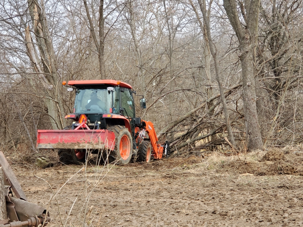

Two weeks ago I purchased a 64" grapple that weighs 500 lbs. It fells like the perfect match for my tractor. I am sure if I throw the ballast box on I will have plenty of capacity. Based on the Grappel mfg rating 50 HP is the maximum recommended for this grapple. Long story short, be skeptical of the implement Hp ratings. IMG_2338.jpg IMG_3332[21107].JPG IMG_3332[21110].jpg
