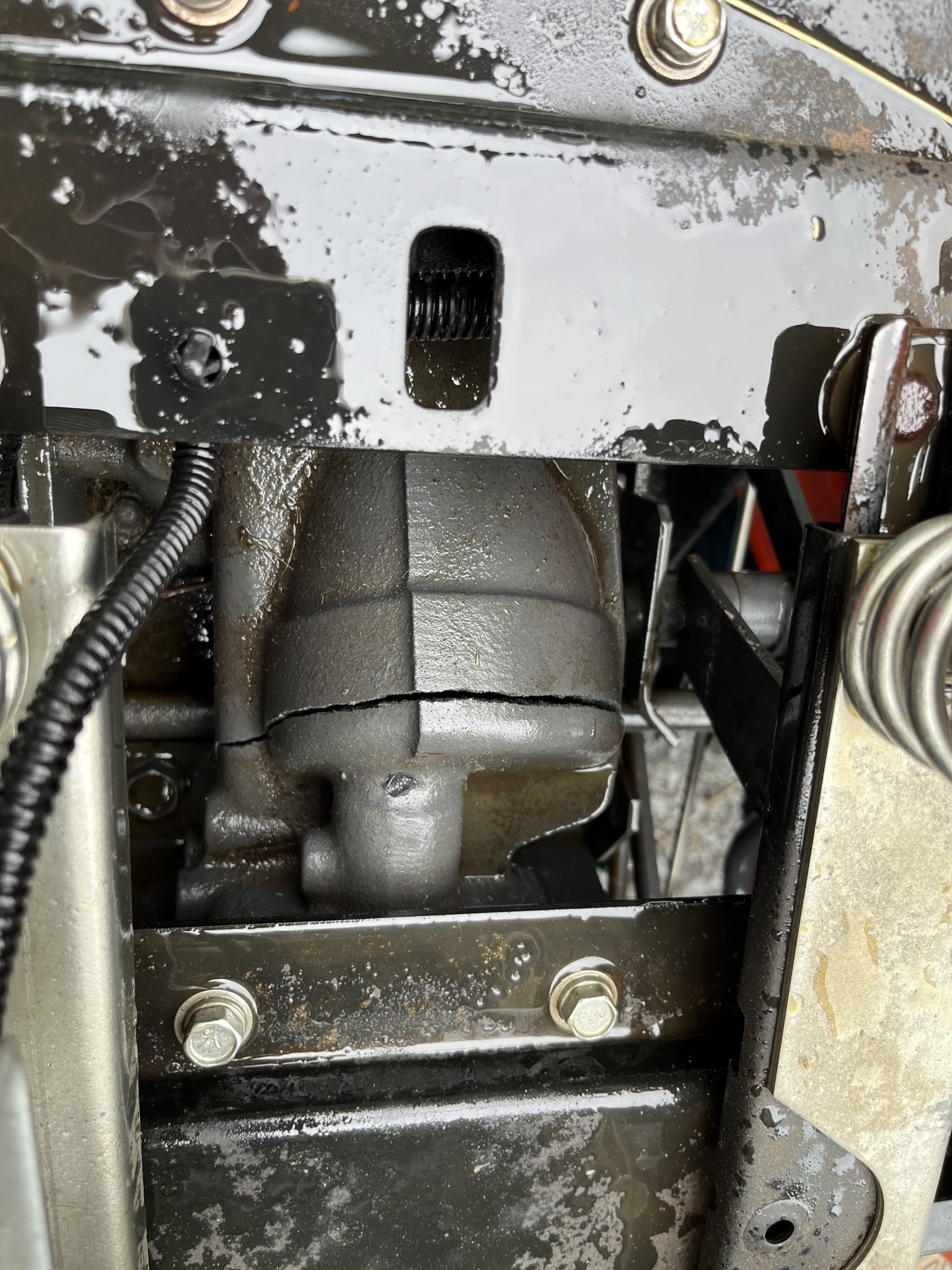

B2301 was parked with a mower attached to the three point hitch. I heard the mower drop as I walked away to get a drink. Saw hydraulic fluid everywhere. Lifted the seat and the casting immediately underneath was broken. The tractor has about 220 hours on it. I am at least the second owner. I’ve put about 100 hours on it. Anyone see a failure like this before.

I have seen tractor main-casting crack.... usually after being 'abused' such as carrying excessive weight in bucket at high speed over rough ground.
I have also seen 3-point arms snap off from tom-foolery.
Not suggesting you did anything wrong. Perhaps close inspection can reveal if there is any rust on the broken surfaces indicating it is an old crack which propagated.

Having taken high level courses on failure mechanisms in engineering materials, I find it hard to believe that leaving the three point hitch up would cause this failure. Castings would tend to fail due to fatigue and lowering the hitch will (ever so slightly) cause more fatigue than leaving it up.
My guess is a faulty casting in order to break with so few hours on the tractor.

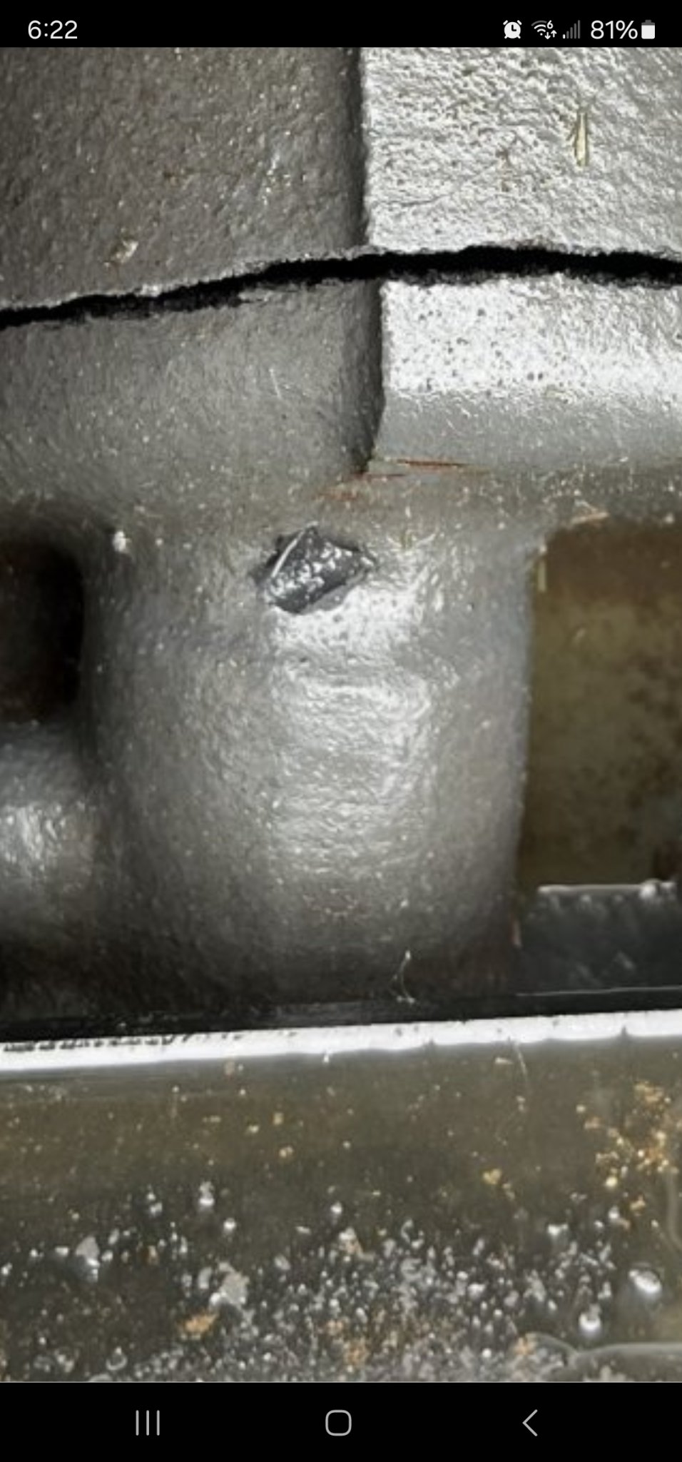

The crack looks clean to me, but I haven’t gotten in too close yet.

Am I correct thinking thats the 3pt lift cylinder? Somomebody else posted a similar cylinder failure recently. Might have been a diffetent model tractor. My theory is the fracture is caused by hydraulic shock loads generated when transporting the mower in the raised positiin. Yours was probably compromised earlier and finslly gave up the ghost will sitting there.
It could be the lift cylinder. I don’t know the innards well enough to know.

I think that you are right, Dan. It looks like the lift cylinder casting, and it would most likely be fractured by internal pressure.
This didn't happen by leaving the mower up while going to get a drink.

Curious.looked it up, that casting is about $1300 Canadian, seems kinday easy to replace BUT the big issue would be to remove any casting bits out of the internal area.
