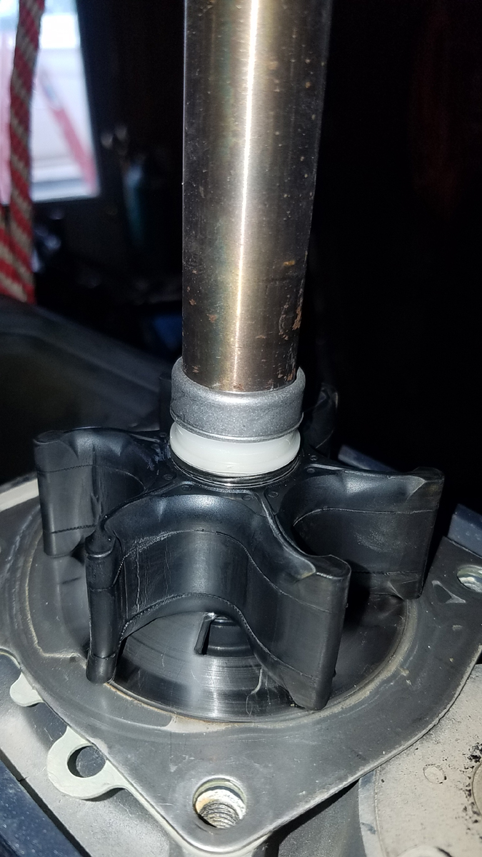

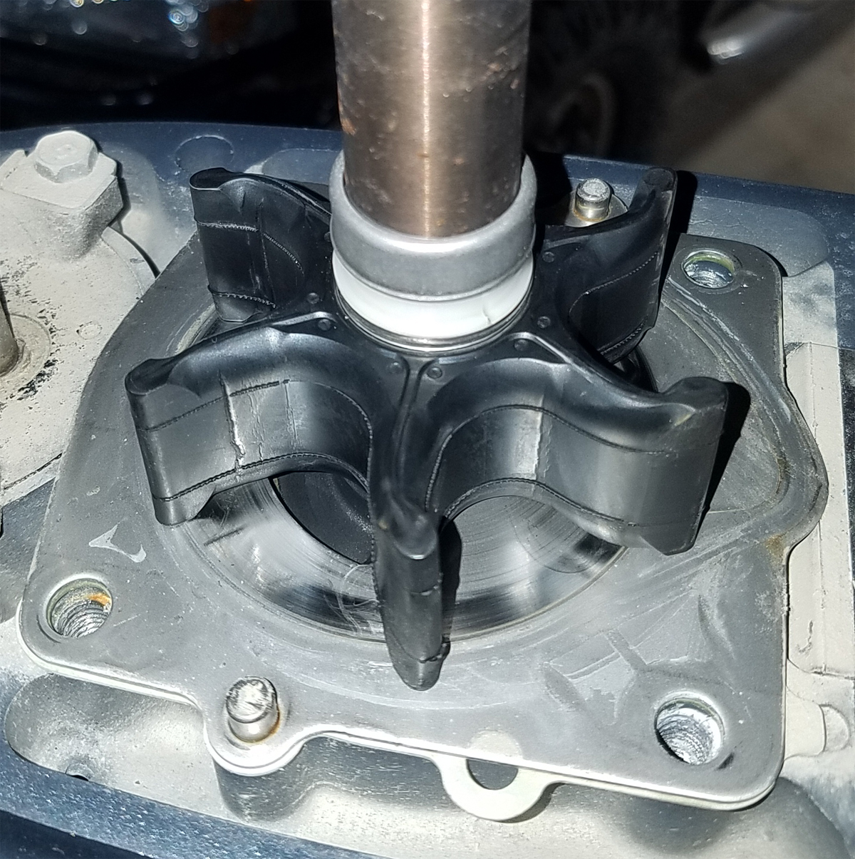

1) inquire about the condition of the impeller (has it ever been changed?)

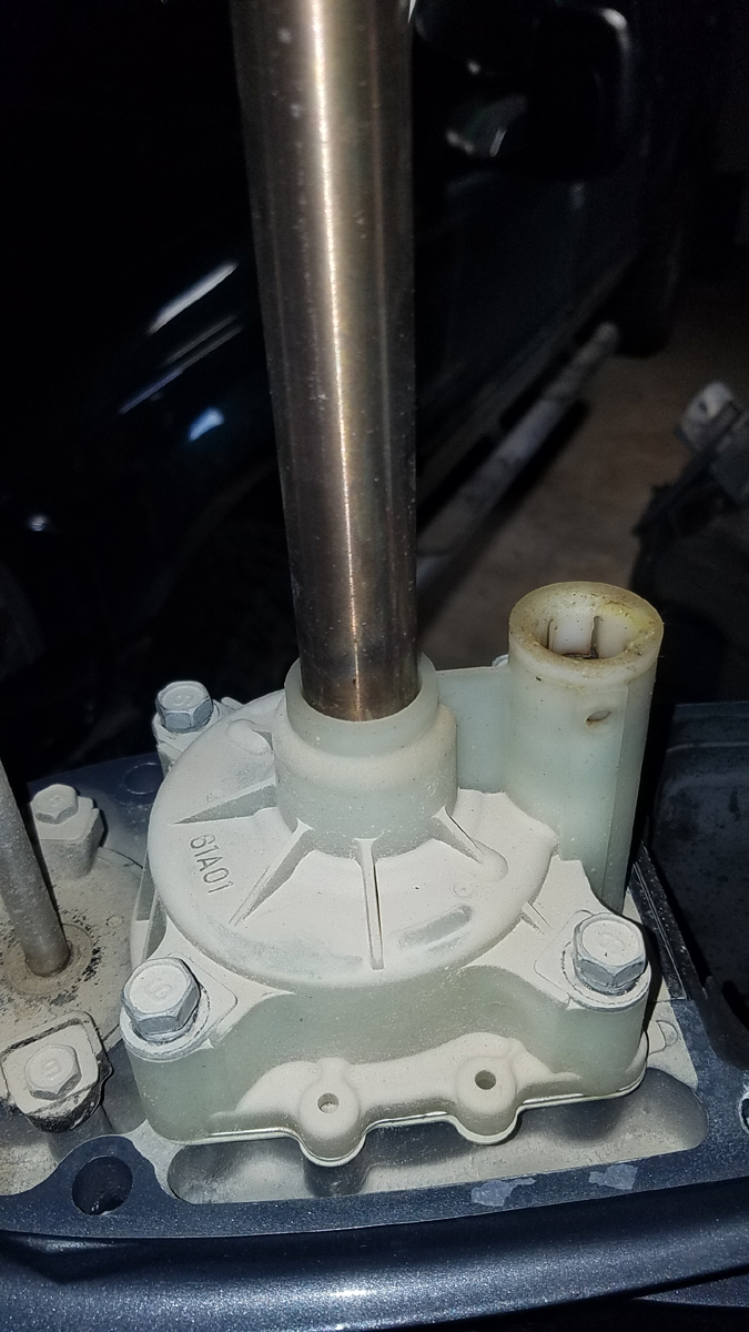

I removed the lower unit yesterday afternoon and set about replacing all of the water pump related parts. Everything looks great and the only minor issues I had were the bolt that screws into the anode and the Woodruff key. The threads in the anode look galled so I'll chase them out with a tap, and the Woodruff key was very tight in the keyway in the shaft.
I'm not sure what the powdery substance is on the water pump housing in the first image but it could be residue from some kind of polish used on the boat and engine. The previous owner was kind of fanatical about doing that sort of thing.
As I mentioned, the engine has 248 hours on it and I don't know if the impeller is original or not, but now I have peace of mind and know when it was changed last. From the looks of the internals, this boat was never in salt water.

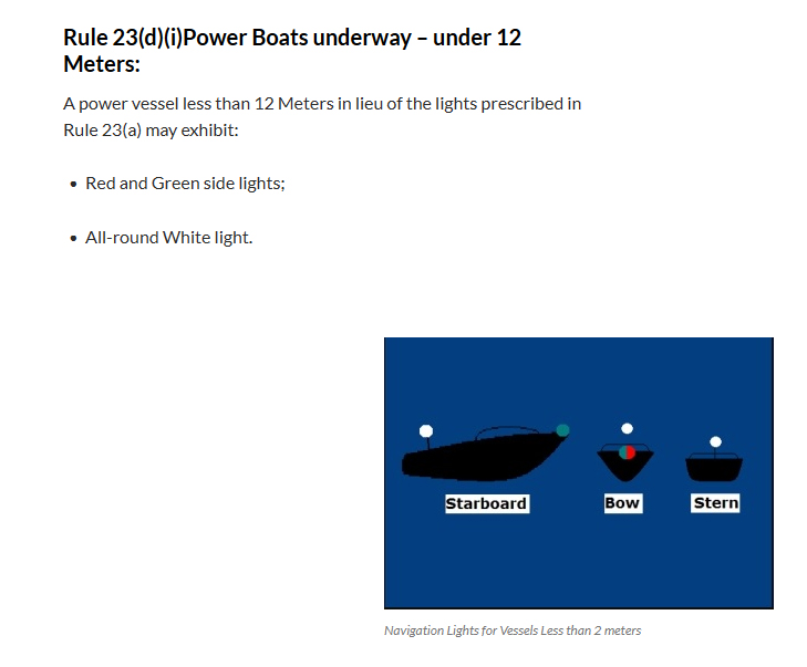

Here's another dumb question for all you boat guys. Are headlights on boats a thing? Yesterday afernoon I turned the battery power on so that I could raise the motor up a bit, and last night I noticed that a marker light was on, the one above the canopy. After playing around for a bit and making sure that everything worked, and it does, I realized that the boat has no headlights. There are some very cool "under counter" blue lights either side of the center console, the standard red and green lights on the bow and the one white light above the center console, but nothing to show the way.
I would think that a set of forward and rearward facing LEDs would be a good idea. What say you?

Lots of boats have docking lights bow and stern connivance/task lighting. Headlights are most likely a violation of the regulations Coleregs so boat manufacturers don't install them. A nice bright handheld spotlight is what I used to carry onboard if I was going to be on the water after dark.
7,121
9,756
Thanks for the link. I see that the boat's lighting complies with "The International Regulations for the Prevention of Collision at Sea (COLREGS) apply to all vessels upon the high seas and vessels on most waterways, bays, inlets, rivers connected to the sea."
Some limited research reveals that additional lighting is not a violation of any Coast Guard regulations unless it interferes with the navigation lights described in COLREGS. I have a DeWalt spotlight like this model but it's older and has a red light too. I use it regularly so perhaps I'll put that on the boat for now.
