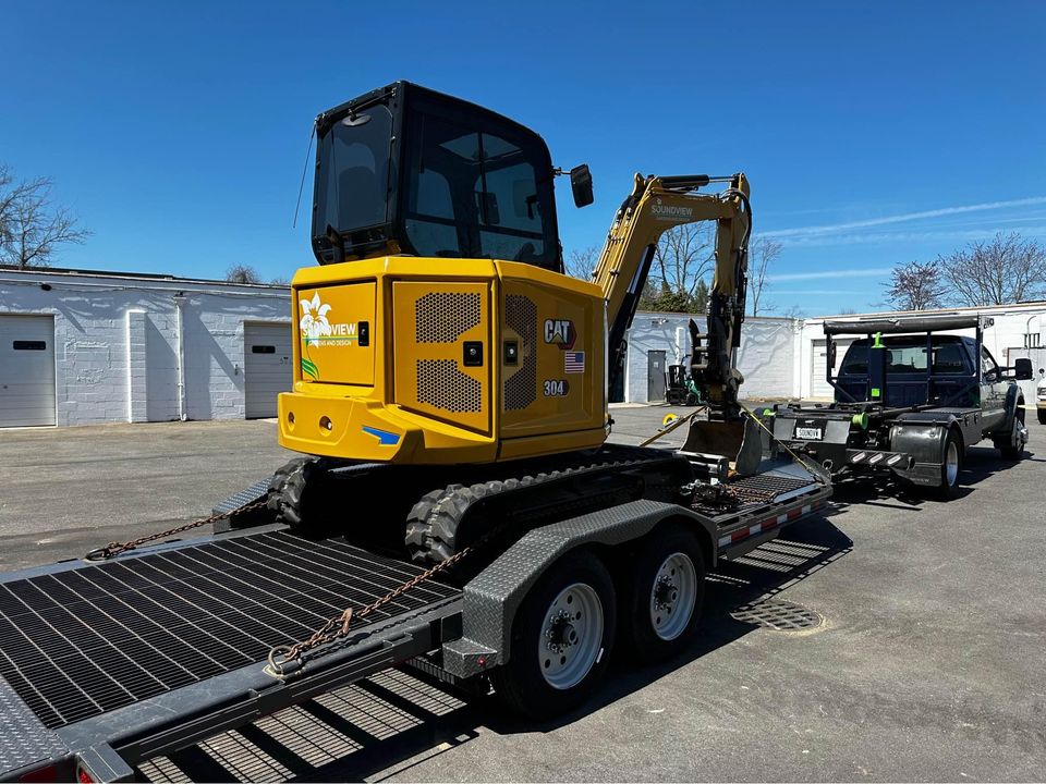

I am in the market to get an equipment trailer. Tired of using my 16 foot dump and its removable ramps that are heavy and tough to tie things down as I have 4 foot walls.
Been looking at lamar and diamond c. Still not sure about tilt or full width ramps. Will be hauling A kx040 4 ton excavator and at times a L6060 tractor.
Leaning toward diamond c. A used one popped up not to far away from me. 20 footer gravity tilt. 16' tilt deck 4' stationary deck - I wanted a 22 or 24 foot but the price is right. Except instead or wood deck or solid metal deck (which I would never get) it has a metal grate deck. Never seen one before like this.
How slippery would this be when its wet or snow or mud? I know wood decks can be slippery but if I went tilt like this one am I gonna have trouble driving up the deck or be cursing and slipping all over the place?
It has a hydraulic jack which is very nice and guy wants $10k for it so price is right but driving up that metal deck is the question

That is a very interesting design.
I would think traction would be good.
I would also think it's a heavy trailer!
Would be better if the deck was going the other direction.
One advantage would be you wouldn't get snow, mud, ice, or gravel build up.
One disadvantage is every rock would rattle off of the equipment and become a projectile for anyone behind you.

Another disadvantage is that you wouldn't be able to use the trailer to haul any loose material like dirt, mulch, gravel, etc...

I’ve never seen that stuff on a trailer. I’ve seen miles of it in factories. Some of it is smooth top, some has little nibs sticking up ever 3/8” or so. I’ve never seen the smooth top stuff installed outside so no clue how its slickness in ice/rain/snow is, but kind of assume there’s a reason the smooth isn’t used outside. In factory settings I’ve seen it in, it’s usually used for foot traffic; vehicle traffic limited to occasional at most.
Tried zooming in on the pic. Not quite sure if the deck is the nibbed variety or if it’s smooth and I’m seeing pixelation. If it’s nibbed I can’t imagine traction being a problem unless it’s covered in ice. If it’s smooth, wet traction would concern me, same as any other metal deck.
That’s my experience with the material. Never seen it in that specific application so that may not be worth much.

That metal grating will be the PERFECT place for rust to grow.
Might be a great trailer for Arizona, or New Mexico, but for NJ. ??
Using it ONLY in Summer, should be OK in NJ though.
If you live in a cold climate like Canada then snow ice buildup will be a problem. Grating will be a slush magnet

10-4 on the grating just sifting the big pieces out what falls off the equipment as it falls onto the road.
The decking MAY be oriented correctly . It looks like there is structure running across the trailer at 16-24" spacing. If so, that isn't a huge span.
I'd be concerned about all the little pockets created where the decking is on top of the structure. That would permanently catch all kinds of crud. And NJ is a salt 'em rusty state that sees at least some snow.

As long as it's painted with real paint NOT 'powder coat', it'll outlive every one here. steel decks are usually only slippery with steel tracked machines. heck there's lots of videos of excavators sliding off wooden decked trailers,so NO decking is perfect in all condtions.
Had an 8x16 deckover made with checkplate.That WAS slippery as water and ice would puddled on it. Grating style should be better. I used 2 sections as ramps, very good traction. Agree it'd be heavy as decking material but 'strong like bull',easy to clean

A buddy has a home made twenty foot with steel grating for a floor and its stood up well over the years and he pulls it in the winter with his skid loader on it to do snow removeable work. Wood doesn't work for him as his trailers never see a shed. If you can buy the trailer right I would buy it and give it a try. Always easy to sell a well kept trailer.

If the price is right buy it cover it with wood soak the snot out of the wood with oil let it leak to the decking,,, problem solved
Does NE use thousands of tons of road salt each Winter?
Guy only had 3 pictures

Yeah, they have all the options but no option for metal grating like this guy had built. They must have done it special for him. Without the extra flooring this trailer with hydraulic deck is almost $16k. So thought $10k was a great price. Somebody else said buy it - try it and if not you can sell it not too much trouble for the 10k you bought it for. i might do that
