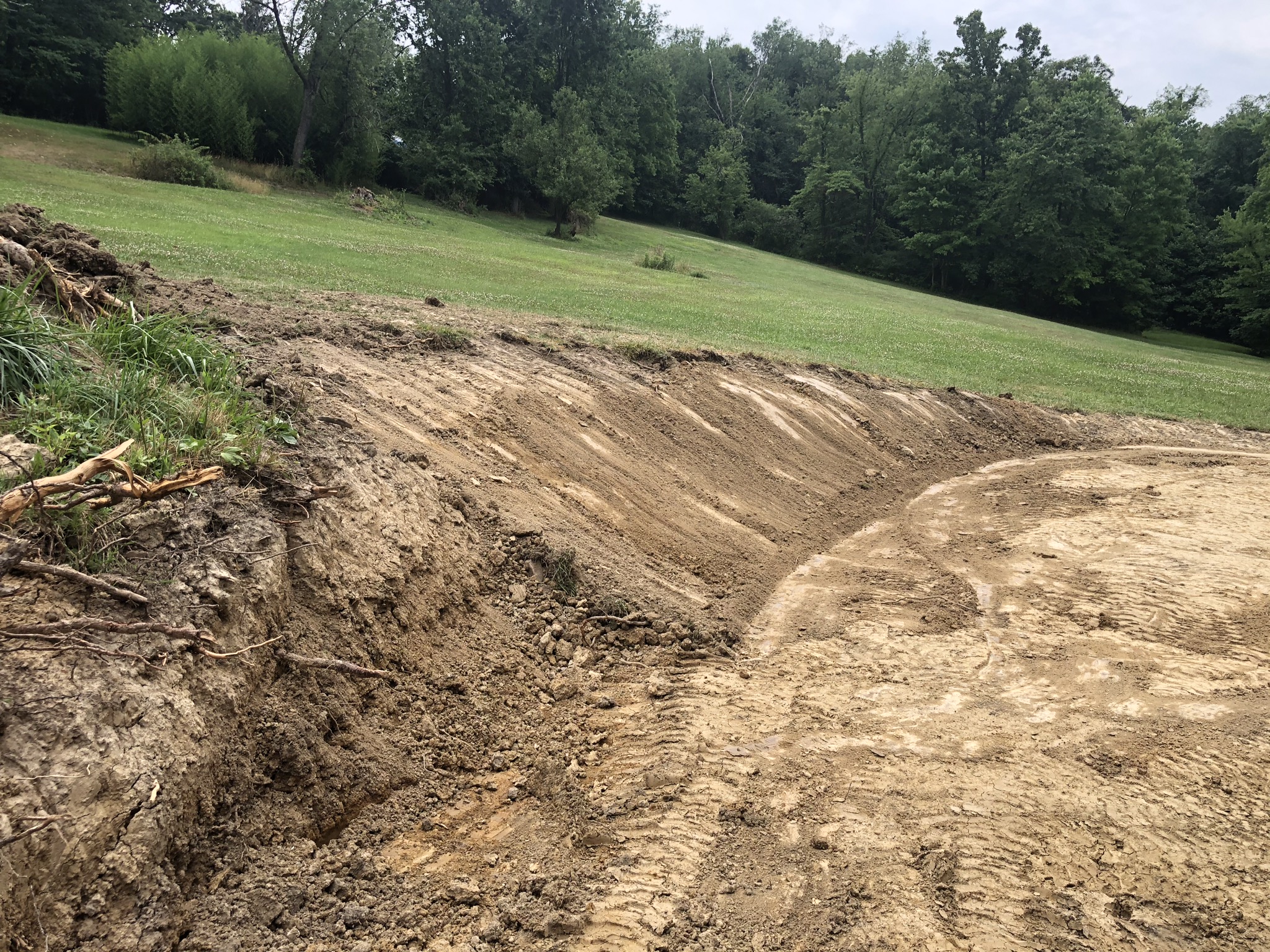

Man! Maybe I am spoiled!
I installed four rear remotes in my B2910 and only use three of the to date. Maybe I use my box blade for more than most, I do not know. OR I am simply a box blade wimp!
Anyway, I really appreciate the responses! I can not remember using my box blade without T&T it has been so long.
Anyway, this is a work in progress, but I am wondering how guys without T&T would grade the tapered slope and transition to the flat area.

I would cheat and use my trackhoe.
6,119
3,421
I would cheat and use my track hoe.
