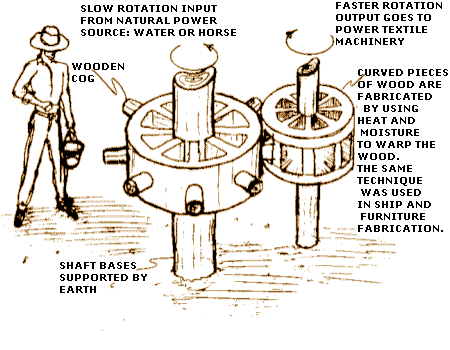

Maybe make one? Similar to the one on the right below. Take 2 disks, drill holes around the edge for drive pins, one in the center. Mock it up in wood or foam first.
