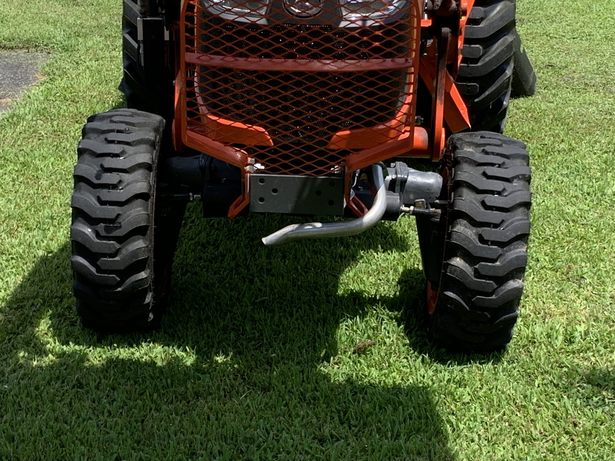

I was driving over a 6x6 and turning the steering wheel to avoid a swing set be hide. And this happened

It’s a little hard to tell, but it looks like the left front tire (the one on the right side of the picture) is off the rim at the inside top. Not quite clear if the wheel is leaning out at the top or if it’s just the tire.

Tire pressure is good. It is leaning out at the top. Tire is on the rim fine. Sorry about the bad picture

It looks like you parked it on a spot that isn't level and the front axle pivoted slightly. When you say "this happened", what is "this"? The front axle won't bend. Is the wheel bent?

No I don’t think the wheel is bent. I’ll check it tomorrow and give an up date I didn’t know if I bent a spindle or a bearing was bad. I only have 290 hours on it

There is nothing wrong with it.
You didn't bend or break anything.
The front tires tilt in on top, and you have the front axle at an angel which makes it look even more tilted in.

Ok awesome thanks for all the help. That relieves a lot. Though I was going to have to call my dealer on Monday. Thanks for all the help
