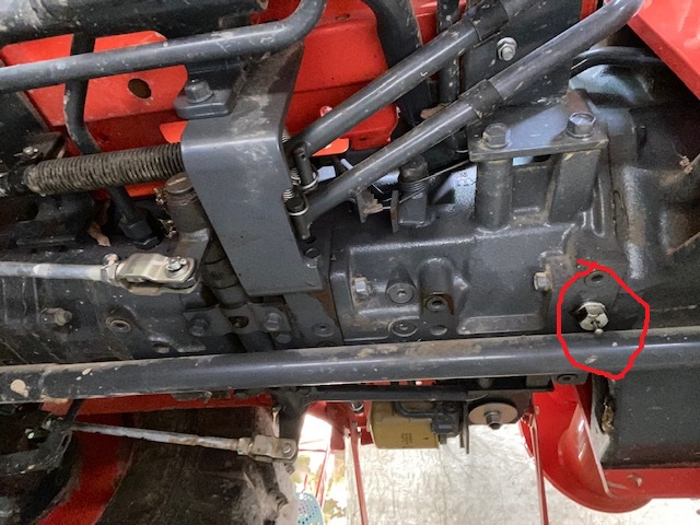

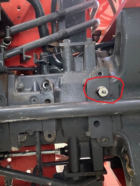

While lubing the HST zerks which seems to have cured my starting problem though only time
will tell, I came across this:
I've been under there dozens of times, but I don't remember this. Reason I'm asking, I had
it serviced last fall to include topping of the Tranny lube. Doing maintenance on it today,
it took nearly 3 gallon of UDT-2 to top it off. I was back under it looking for a leak and disn't
find one anywhere. This looks like some kind of pop off pressure relief valve on the tranny.
Is it supposed to be exposed like this? And could this be the reason I lost 3 gal of UDT-2?
I'd appreciate it if someone with a L3800 would check theirs and see if it's open and exposed
like this or if I'm missing something?
Thanks
Dano

It is a drain for the clutch housing. It shouldn’t have anything coming out of it (doesn’t appear it does is pic)
it took three gallons to get to the sight glass?

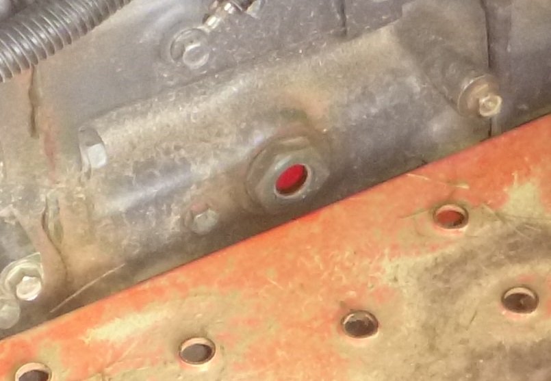

You can run a little extra hydraulic fluid (gallon) but not running out of the fill hole. When hydraulic oil gets hot, it will expand...
Here's my sight glass with less than a half a bottle of the dye...
Just ordered a bottle. I'll wait to drain it until I get it and can see how
much is in the sight glass.
Thanks for the tip.

I added the dye and let it run at idle for a few minutes. The entire window is now red.
To late today to drain it but I'll be draining it tomorrow.
Dano

From my experience (I use the same dye) its really hard to tell the level unless you catch it right when its in the middle of the glass. The 'background' takes on a reddish color so you really need to see the actual level. Go soooo slow when filling or draining.

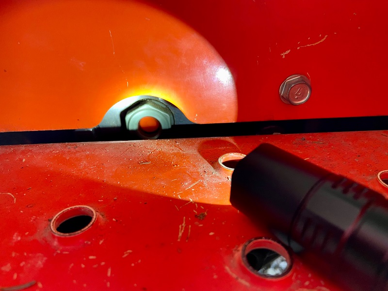

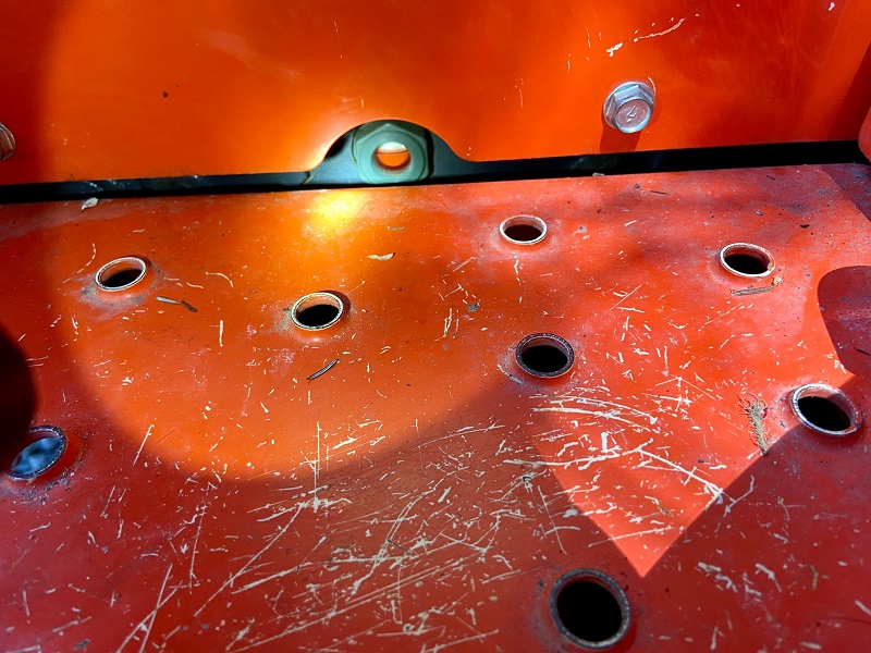

Ok, got the dye in yesterday, I also stopped at the local hardware store and picked up
one of the squeeze bulb pumps people use for kerosene heaters and a 3/16" dowel.
Today I drained the 3.5 gal I put in out and this is the result:
Engine at idle:
And Sight picture with the engine off:
I'm leaving it at that. I stuck the 3/16 dowel in with the engine off and notched it so now I have
a better tool to gage the fluid with.
The EBAY seller that I got it from says he's sending me another bottle. I use it in my BX2680 just
so I can see it better on the dip stick it has. There was less than a 1/3 of a bottle of dye. I know
some said to only use 1/2 a bottle, well 1/3 worked pretty well as you can see.
