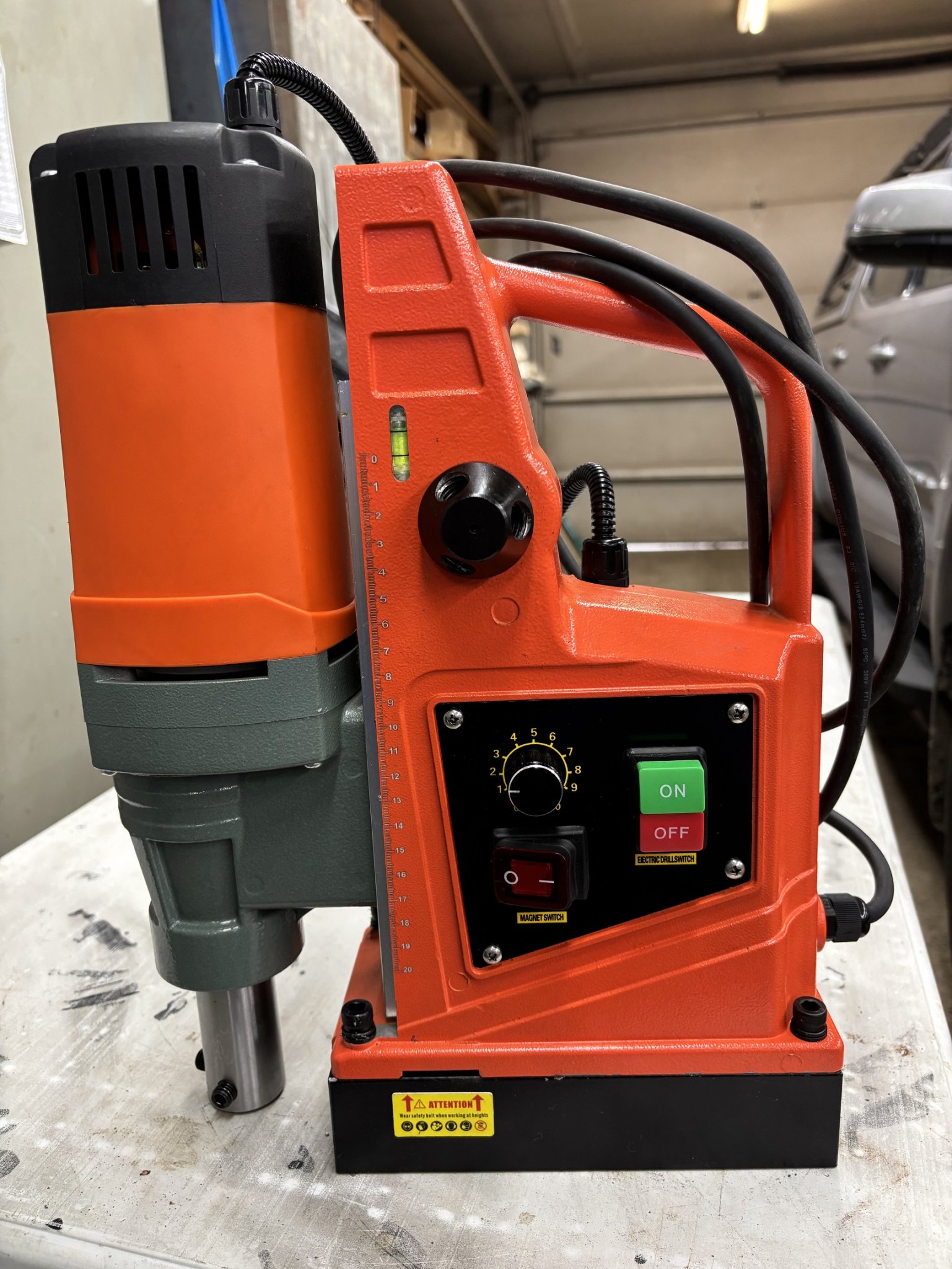

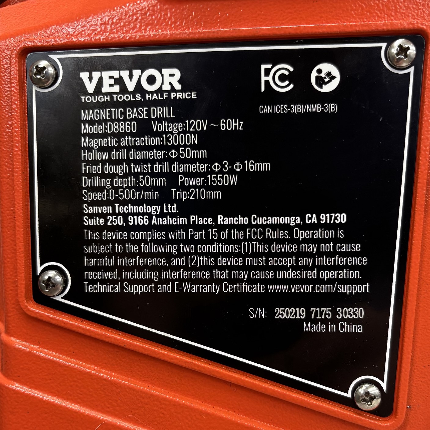

I hate to give you another reason to spend more money......but for much less than a commercial duty mag drill.... this one sure seems to work great:
Magnetic Drill: A friend who has this same drill recommended it to me. He’s had his for years and said for home use projects it works great. A Vevor model 8860. I found it on sale for just under $200. Variable speed and up to 2 inch capacity. With the annular cutters I purchased, the drill had no issue walking right through that 1 inch thick steel wall. I was impressed!! A minor drawback for me is there is no reverse.
(Note: I have the drills spoke handles removed so that it can just barely fit in my tool cabinet until I find a better spot for it.)

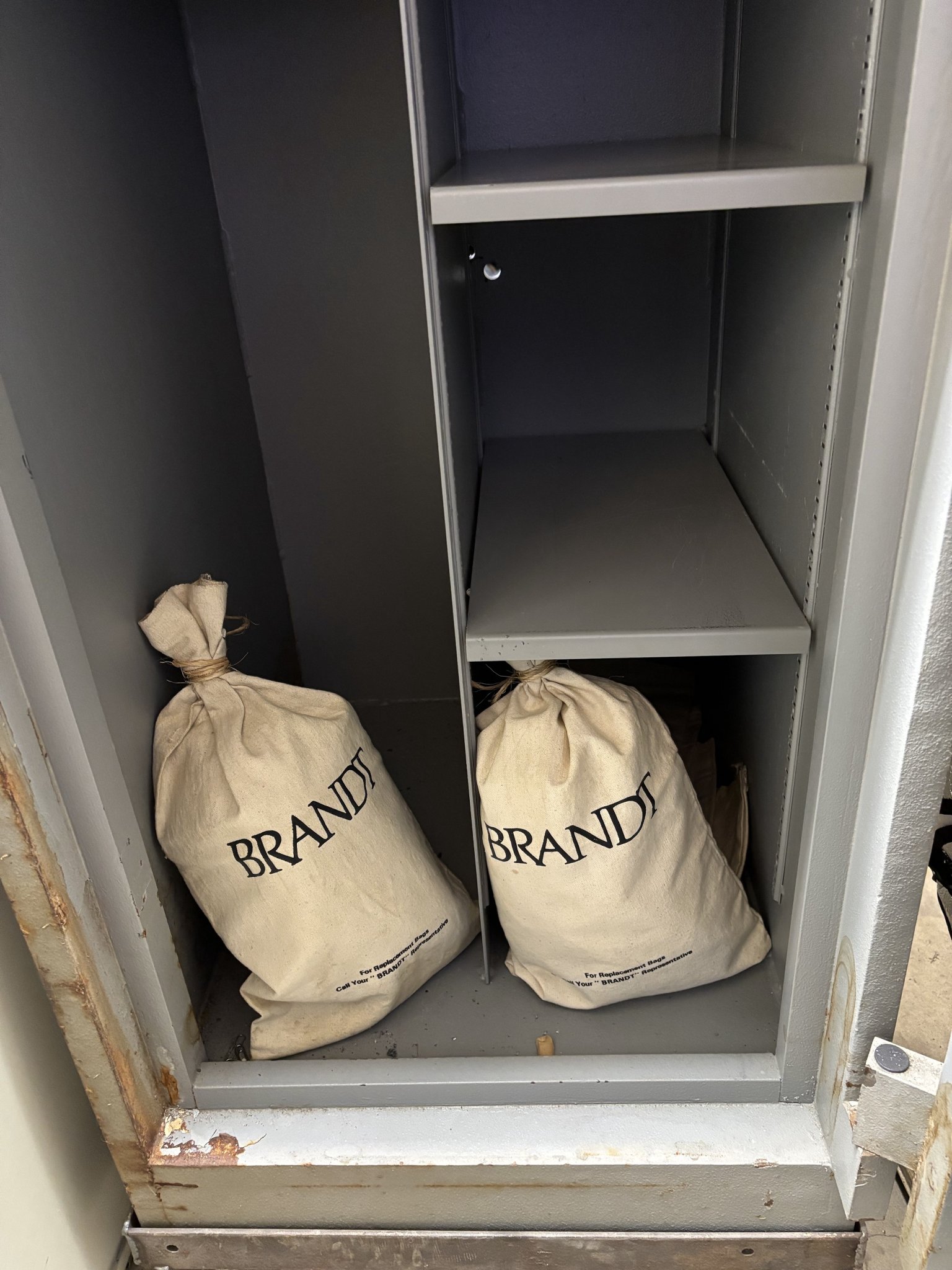

The top vault was empty, save for a cash drawer. the bottom vault, however, did contain a few items. Safe Contents_1.jpg

And Vevor is/has been my "go to" company for a bunch of things that are usually out of my prince range.
I think that "overall" they make a product that is "good enough". I have had a few things that were junk, but for the price, I generally find that they are at least "worth a shot".
I'll have to look at one of those drills. (After I pay the bill for that new lathe chuck...lol)
