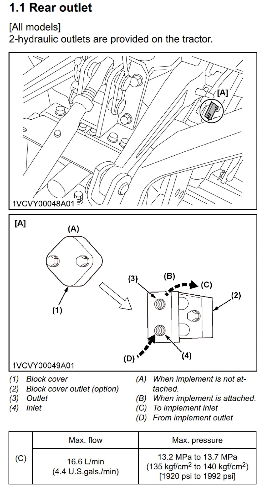

Not yet. I wont be moving to the property permanently until late summer Probably wont get to it until next winter. I have the valve and cylinders just need to be there more than a few weeks a year.
There is a rear port on the right side. The manual shows an optional adapter to use the ports. I will be seeing my dealer in a few weeks and plan on finding out what the availability/cost of the part is at that time. If it is not available or ridiculously priced I will fabricate one myself.

Thanks! I admittedly don't know a lot yet with respect to tractors but seems to me that what you're showing would be for a power beyond circuit to run a BH or other implement w/it's own controls.
I was wondering if the reason they weren't offered was because the 2401's gearshift lever is where the controls for rear SCV's would normally go on an HST. I posted the same questions (rear valves & 3rd function on B01 FEL's) on Messick's B2401 vid. but he doesn't respond to much. Was supposed to go up there and test drive a B2401 last month & this was one of many questions I had for the salesman but life got in the way. IDK if they still have one now. After doing a LOT of research & reading the experiences of a few owners (@El Jefe & I were discussing on another thread), I'm pretty sure I want a B2401 but I'd sure like to have factory designed rear SCV's like the HST's do.
Will be following here if you could post what your dealer comes up w/. There's very little information out there on B2401's. Would sure be interesting to see the factory installation instructions for the rear valves for the HST models (all the options dealer assembled parts come w/detailed instructions for the service techs).

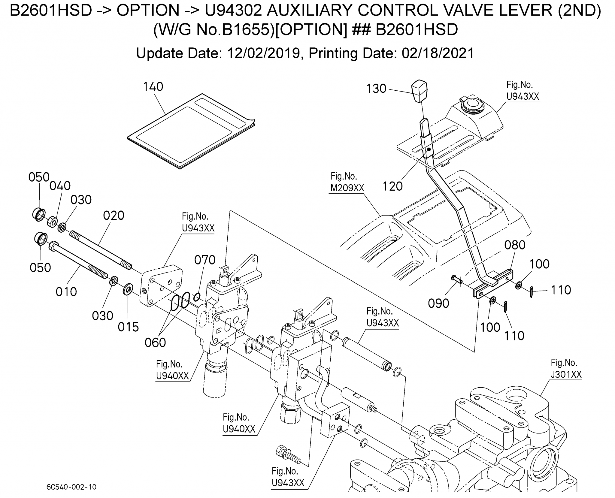

There are no cutouts in the rear fender on the B2401 for factory valves like there is on the 2301 & 2601. I'm not sure of Kubotas intention for the rear port other than implements that have there own valves. I'm okay with a ROPS mounted valve.
This is the B2601 rear valve assembly.

Thanks - I've only ever seen one 1 ea. B2301/B2601 on a dealer lot but I wonder if the fender from a B2601 could be installed on a B2401. I'd rather have the factory setup if possible but will live w/it it it can't be assuming once I get to test out ea. that I go w/the B2401. I think personally that I'll just like it a lot better than a HST.
The cutouts in the fenders are copmletely diffetent due to the control diffetences. With the transmission and hydraulic differences I have doubts the bolt patterns are even the same. The HST models are considered premium models with more fearures and options. The 2401 is more of a basic machine.
